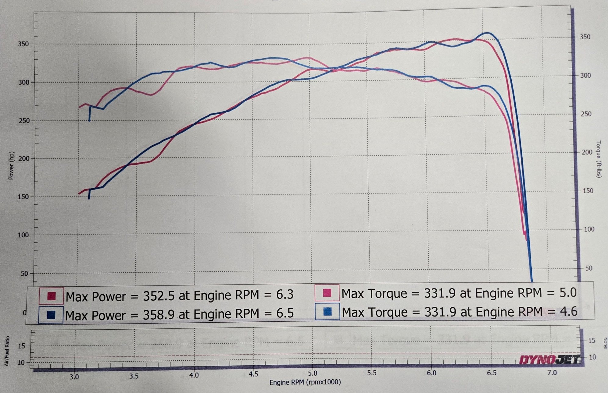

On my way to the dyno. Any guesses on what the results will be?
2017 V6S AWD with VAP crank pulley and tune. Dynojet 424XLC2, temps are mid-80s with moderate humidity. I'll have a 30min drive to get there with minimal time to cool down.
I sent a message to VAP with the tune they sent me asking them to check and confirm it is correct but haven't heard back yet.

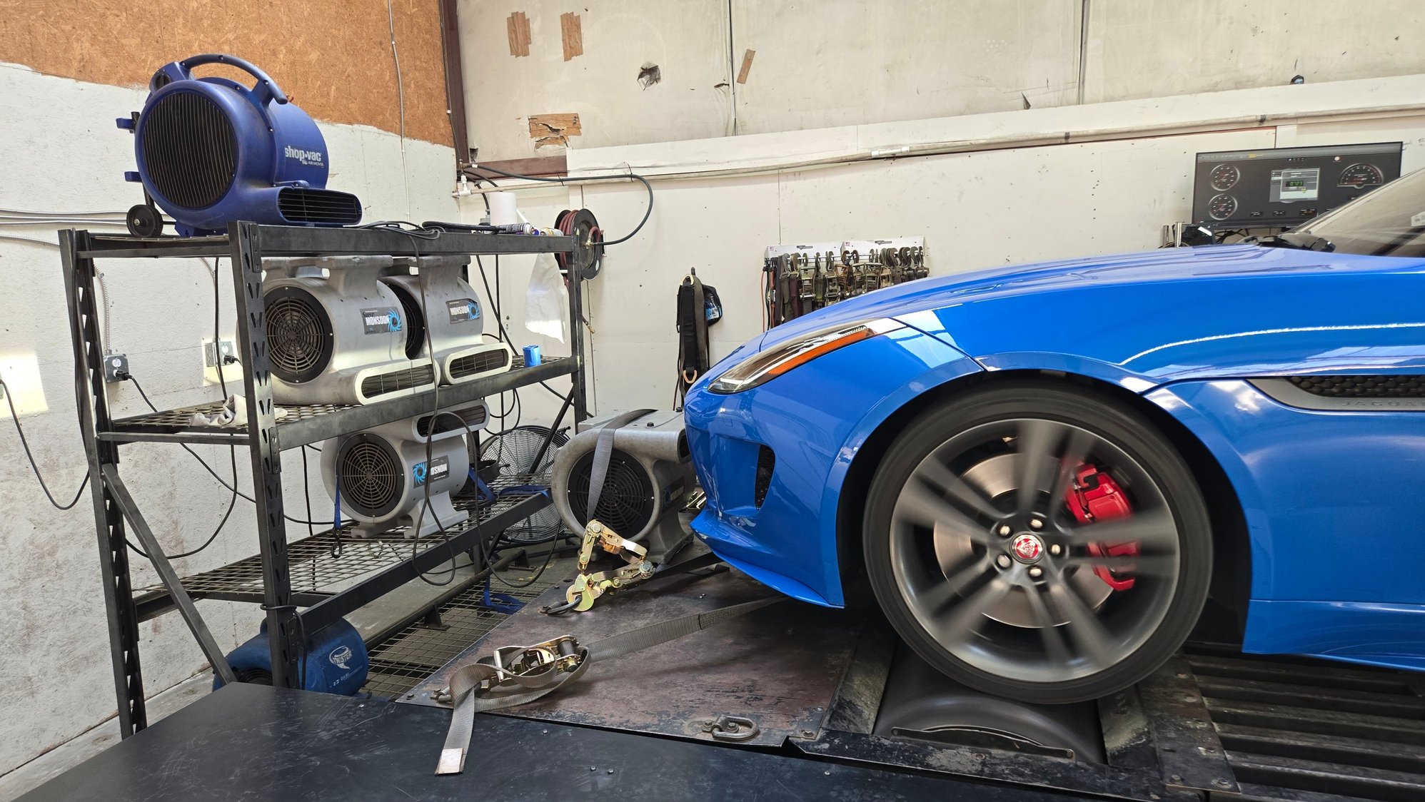

Old Aug 25, 2025 | 02:02 PM
  #37
TH3FRB's Avatar
Joined: Aug 2019
Posts: 179
Likes: 34
Sorry for the delay on results - I've been on vacation and didn't have a pic of the dyno sheet to post. So here it is - with several important caveats. First, this was 3rd gear. We knew 6th was 1:1 ratio but the shop owner said that would be a very long pull and not particularly good for the car so I deferred to his experience. We tried 4th and couldn't get a good pull - car kept downshifting even in Sport mode. Apparently there is a "kick down" switch under the gas pedal so you need to go full throttle without actually putting it to the floor. Stuart has also stated that we should have done 6th gear regardless of the long pull - lessons learned. By the time we managed to get a decent pull in 3rd gear we had already tried probably 6 -8 times over the course of an hour so heat soak was definitely an issue. We gave it 10-15min rests a couple times but that doesn't afford much time to actually cool down. And finally, it was over 95 degrees in the dyno bay despite having front and back garage doors open. All together I really have no idea how much all of these things added up to in terms of the results. I'm planning to do the new ported SC and associated tuning and hit the dyno again in a couple months when temps are much cooler and knowing how to perform the runs.
