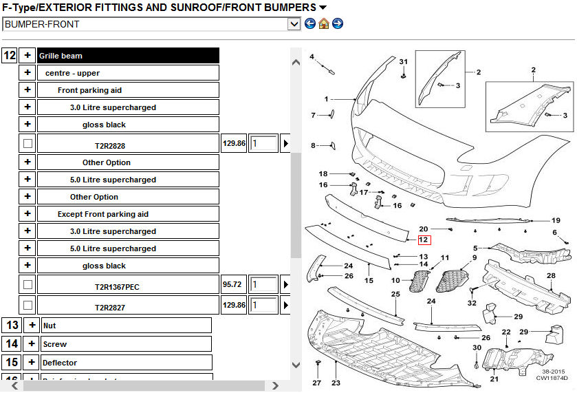

T2R3562 is the gloss black variant of the centre lower air deflector (the bit below the grille). From your description it sounds like you need the horizontal plastic cover that actually sits across the centre of the grille itself. Is that correct? If so there are different parts for with and without front parking aid.
T2R2828 - gloss black, with front parking aid
T2R2827 - gloss black, except front parking aid
For the avoidance of doubt those are part 12 in the attached diagram. Please check if that is correct.

It is definitely part # T2R3562 I am after.
And yes please, get me a quote on this part including shipping to Oz, PM to follow shortly.
Ok, makes sense now! T2R3562 is the gloss deflector. I'll get back to you with the direct shipped cost asap.
