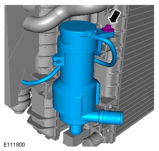

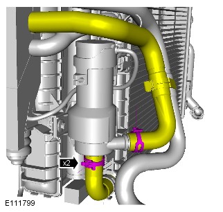

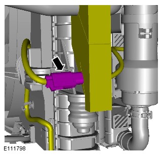

REMOVAL
NOTE:Removal steps in this procedure may contain installation details.
  1. WARNINGo not work on or under a vehicle supported only by a jack. Always support the vehicle on safety stands.
    Raise and support the vehicle.
  2. Refer to:Cooling System Partial Draining and Vacuum Filling (303-03A Engine Cooling - V6 S/C 3.0L Petrol, General Procedures).
  3. Refer to:Radiator Splash Shield (501-02 Front End Body Panels, Removal and Installation).
  4. Refer to:Auxiliary Radiator (303-03A Engine Cooling - V6 S/C 3.0L Petrol, Removal and Installation).
  5. Torque: 7Nm
INSTALLATION
  1. To install, reverse the removal procedure.
