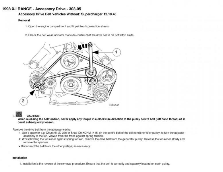

I purchased the replacement water pump from JAGUAR PARTS CENTER not Gaudin as noted .

Help, contacted Coventry West they say " sold 100's of pumps all same.
Have removed old water pump and can see large O-ring in place .
Do I insert new raised lip water pump in opening leaving O-ring in place . Does the new plastic gasket cover opening . IS THIS A PRESS FIT ,se do not want to force new pump in .
