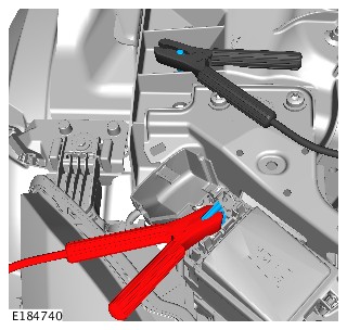

You can charge it without disconnecting, these vehicles are connected to a battery support unit while in the showroom without disconnecting the battery.
There will be a ground stud and a power point under the hood/bonnet
  • This Step contains connection instructions for the following vehicle;
    • F-TYPE / X152
Otherwise, you can connect the charger directly to the battery. Just make sure you connect the ground cable from charger to a ground on the chasis in the boot/trunk area, not directly to the ground cable on the battery itself
