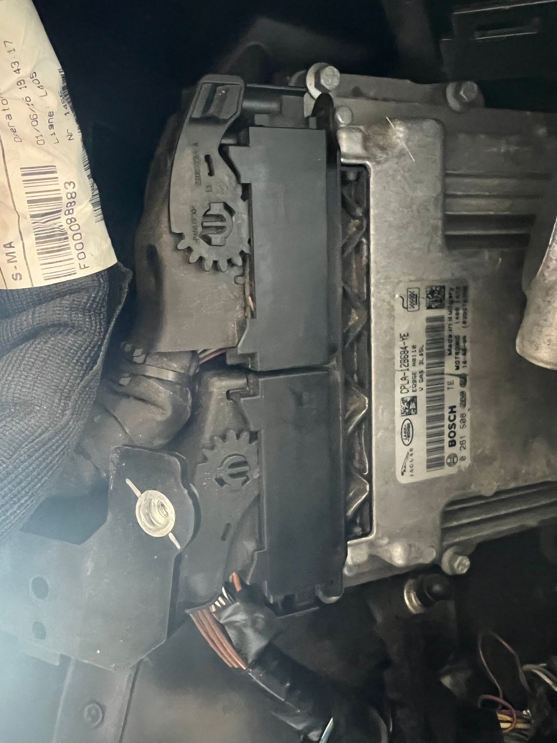

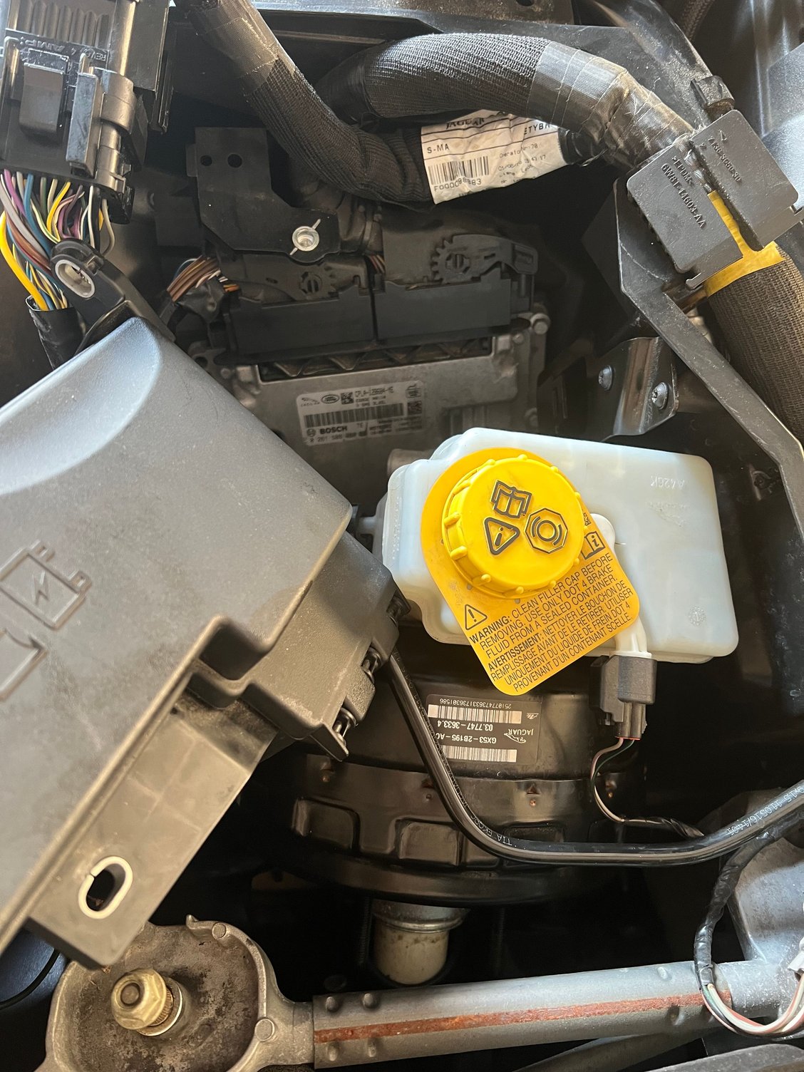

Can I disconnect the electrical connections and remove this box?
I am trying to remove the brake booster from my 2017 F-Type SVR so that I can replace the brake pedal assembly and I need to remove this box for the little extra room. My question is…. Can I unplug and remove this box without having to have anything reprogrammed when I plug it back in? Any help is greatly appreciated so I can get her back on the road.
Old Aug 21, 2024 | 06:58 PM
OzXFR's Avatar
Posts: 9,030
Likes: 3,664

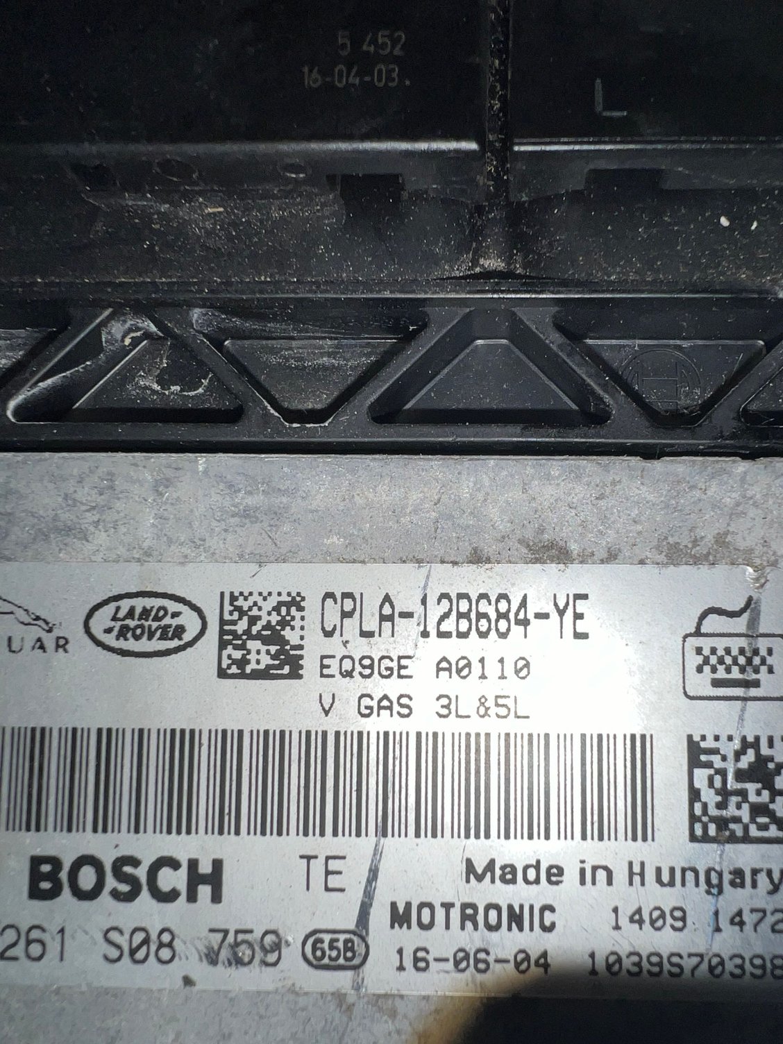

That "box" is the PCM (Powertrain Control module) aka ECU.
You should be able to simply unplug it (the two large electrical connectors on top) and unbolt it then remove it.
I think it might be a good idea to disconnect the battery first though.
But I know nothing about removing an F-Type PCM so it might be more complicated than that!
