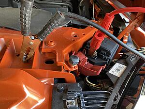

I tried jump starting it by using two different vehicles and no luck. The electronics come on, I was able to open the trunk, but as soon as I start, it flickers and shuts down. Rinse, repeat and same thing. Should I try jump starting it from the back now that the boot is on? Am I doing anything wrong?

As for jump starting the car, sounds like i'll have to take out the battery and take it to the shop for full charge =/

Don't close the trunk lid when the battery's out! Put something over the latch to prevent it closing - you'll have a job getting it open if it shuts, you won't be able to power up via the under-hood terminals without a battery to complete the circuit..

I am not sure if it is installed in your F-Type or not but the one terminal on that Interstate battery in the photos has some corrosion on it. Make sure both battery terminals are clean and tight.
A solution of baking soda and water will get rid of the corrosion on the battery terminal.

Thanks will have both of my other vehicles checked out and cleaned for corrosion if any.
