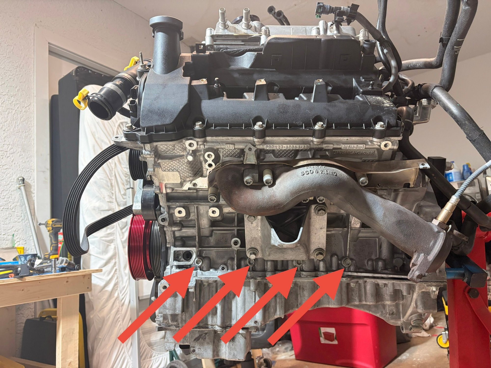

it’s these four bolts there’s 4 on each side so 8 total

Ahh, we don't take those apart at dealership level so we don't have specs. I will look through the engineering stuff tomorrow and see if I can find it, should be able to.

I'm guessing those are the crankshaft main bearing cap side bolts.

21-23 Nm
