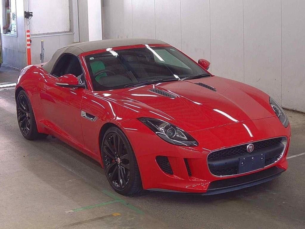

I badly wanted a red F-Type convertible. I live in New Zealand and there are very few here. I looked into wrapping but chose to wait, about two years. I have finally found a 2016 in Japan, it will be here in a few days after waiting for nearly 2 months. Only 19,000ks, genuine.
It has been serviced by the importing dealer, but I will change the transmission oil, can any of you tell me about anything I should have done?

I love your car, as I am sure I will love mine. It will sit in my garage next to my red XK. If I am not out hooning. I am unsure what is ppf. Could you explain. is that to prevent stone chips?
I won't do the grill job you did, I kinda like to keep my cars original. My top is grey, I will consider blackening like yours if I can find someone to do it here. My wheels are black which I love, yep, lots of cleaning. I see yours are aftermarket.
Picture attached.
