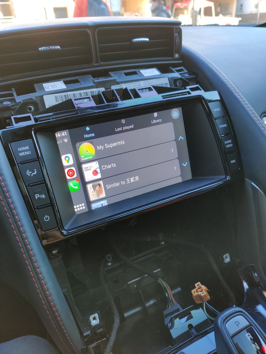

Okay guys, I fitted all the wires and fired it up, after setting up it turned to the car play display, but the touch screen doesn't work?? Touch works perfect on the factory page, I tried playing music, it does go through and the now playing icon was moving. I tried navigation on Google maps and it doesn't jump to the navigation page.
i tried skipping track on the steering wheel and it worked???
Not sure what I'm missing, I tried deleting blue tooth connection and redo it, now I'm having trouble to connect it..
Also the size factory side bezel buttons don't work, I have the hard button version and yes, the connector is plugged in.
I'm in the process to reset car play completely and see how it goes.
Edit: oh and the reverse camera does come up automatically during the brief time I was in car play mode, this is gonna be sweet once I set up everything, can't wait!!!
Edit 2: I don't think any connection is missing
Edit: I got the touch to work, but it stopped working after awhile.. Can't figure out what's wrong

Somehow everything started to work after I assembled things back, forgot to screw the NAV unit down so will have to do it again.
Now there are 2 problems, I emailed their support but maybe you guys knwo better
1) no sound goes though until I make a call(intermittent)
2) carplay interface goes back to car interface once every 5minutes(connection does not drop, pressing NAV key goes right back to carplay)
evrything else works flawlessly, including auto backup camera and music control on steering wheel, im guessing its because of my 2015 bosch unit?
Do you mean you're not hearing anything from CarPlay (music, turn by turn directions, Siri, etc.?) Do you have the audio out cable plugged into the AUX port and AUX selected as the source in your factory audio screen?
If you haven't done the above, I suspect you can only hear call audio because that's still going through the factory bluetooth phone connection? Otherwise I'm not sure.
I've had this happen, but only a few times and it wasn't persistent. It hasn't happened for me in a while...
In my setup, back and forward on the steering wheel will work if your phone is still connected to the car via bluetooth, and the factory audio is set to bluetooth. But I won't hear Siri (or nav guidance) this way, just music.
Okay that make sense now, I have been keeping the blue tooth connected so after making a call it switches to car blue tooth audio, that's why I can hear music afterward but not map directions.
Lemme try aux tomorrow and see how it goes. Thank you so much!

Everything works now except for the steering wheel music control (as expected), it's fantastic.
Screen jumping back to factory display was fixed by disabling "return home" function in factory display under "set up".

I haven't tried a ground loop isolator yet, pretty sure I plugged in the mic to the right port though. I will add the ground loop isolator it when I install the new mic, I found one shipping from taiwan described as "super high audio quality", hopefully it arrives soon and work.
Old Dec 24, 2020 | 09:41 PM
  #39
Ray Ray's Avatar
Joined: Dec 2019
Posts: 666
Likes: 184
From: NYC
Received my new mic, plugged it into my laptop and it is lower sounding than my built in mic..not sure if it is gonna be better installed on the car.
Also installed the ground loop isolator, it seems to help clarify the sound a bit, but im not entirely sure, it is installed between the aux out cable and the car aux jack for now.
Old Dec 25, 2020 | 02:01 AM
  #40
Borbor's Avatar
Joined: Nov 2020
Posts: 574
Likes: 186
From: South Australia
ground loop isolator is only going to get rid of a constant background him. Doesn’t happen to every installation so if no hum adding it won’t improve anything. If you do have a hum it works magic. Given it is $10 best to get it added for all installs regardless.
I had another thought about your problem. Are you sure you have plugged to stereo mini jack from the microphone in all the way into the module. If you have only plugged it in half way it will only work on a single channel And will be at 50% or single Chanel only so quieter.
