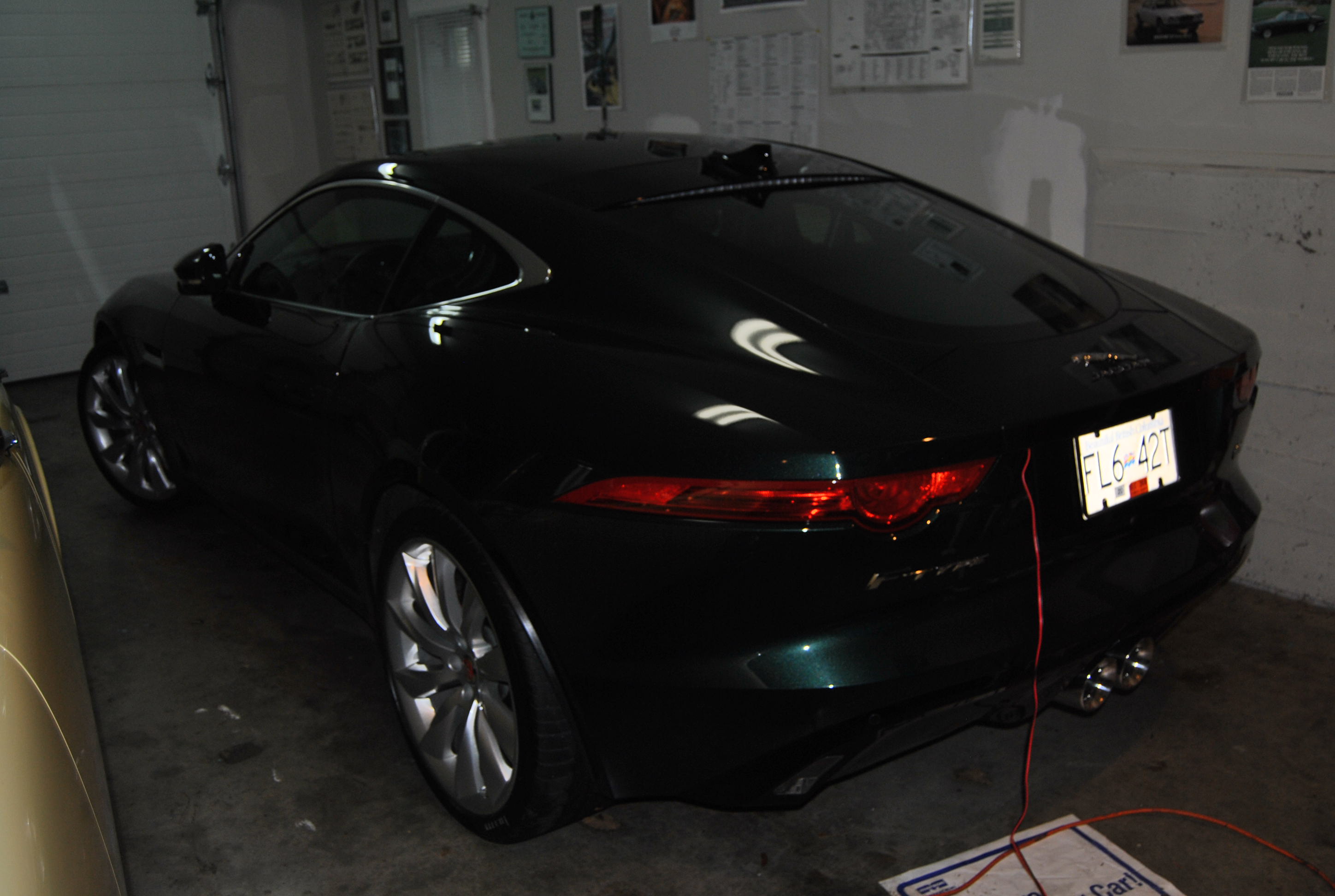

Back to basics: have they DEFINITELY proven that the battery is holding full charge and putting out full voltage? or are they just going to continue to throw parts at it? The most common cause of electrical issues on ALL modern cars is low battery voltage - which produces random symptoms. And this is why every luxury car manufacturer offers the CTEK battery maintainer (a couple of them offer it as a standard accessory). (I know...you have heard this all before)
My no-electrical-issue (in fact no-issue-at-all) F-Type sleeping, happily attached to its CTEK unit:
