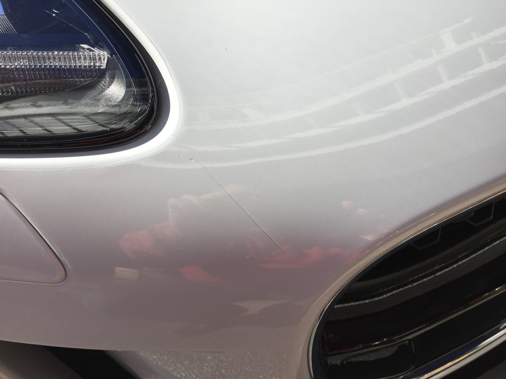

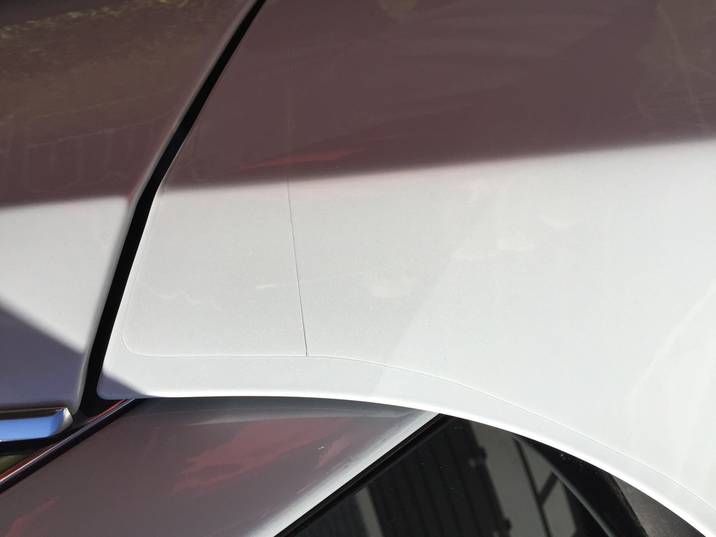

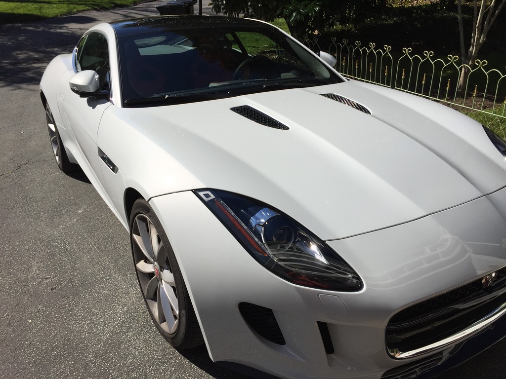

Picked up this morning - After five days, xPel ClearBra installed on bumper, full hood, front fender, mirrors, and rocker panels.
Not Bad...
But, look closely:
Front Bumper was installed in three pieces with a seam under both headlights - is that proper?
In addition, I was advised that they only have rolls that are 76" and that "this is the longest bonnet he's ever seen." So, the inward most tips of the hood are separate with a seam (that's the open door on the bottom of the picture):
The installers seems very "aware and conscientious"...but as Cousin Pearl once asked Jedd Clampett - "did I just get snookered?"

Perhaps you should have asked prior to the install, but I have NO SEAMS on my hood. It is a 1 piece install. Nor do I have seams by the lights. Also, the edges were all wrapped.

I'm curious, did your installer purchase a kit for the car, or do a "custom" install?
The guy who does all of my detailing/clear bra work will order pre-cut kits for cars when they're available, otherwise he has a printer/software so he can custom-design pieces that aren't available.
The reason I mention this is because the bit about the rolls only being 76" is true if he custom-made his own pieces and printed them. However, as other members have posted, when you order the pre-cut kits, there should be no seams and they should wrap around the body panels.
There would be no reason I could think of for your installer to custom-design all those pieces that are readily available as kits- other than it would be a higher profit for him possibly (my installer charges a lot more for custom-design vs. kits).

01Silverstone: When I went to them, I asked if they used 3M (which is what I had researched) and the said no they used xpel (although the name didn't resonate with me)...they said that they were "laser cut" and the "same thing".
But, from my research, I knew the bumper was a three piece kit:
Invisible Mask - Clear Bra Automotive Paint Protection, 3M Scotchgard, Carbon Fiber 3M Films (note that even 3M doesn't have the 2016 kit out yet...so this example is the 2015 - is there a difference?)
So, I wasn't surprised, until I saw others' pictures...and that got me thinking. But the hood is a total shock.
If you look at the bumber, it's a very tight fit, but the hood has a decent gap that, agreeing with buickfunnycar, will be problematic on a white car.

TXJagR: Do you know what brand your film is?
The other issue with the clear bra that doesn't wrap around underneath the body panels is that, in time, the edges can begin to lift and peel away due to washing, etc. and attract dirt. When wrapped underneath the panels, this is less likely to happen because the edges cannot get caught on anything.
For me at least, I wouldn't be satisfied with this install. If it were my car, I would want it redone with the kits- the installer should have made it known up front that there would be seams.

Thanks Silverstone. Bumper is clear...but that's the same seam at the very tip top of the hood
I never knew about the edge wrapping though...my FiL-who is a real car guy-doesn't even have any of his cars edge wrapped...this includes Bentleys, Ferraris, 'vettes, Porsches and Beemers... are the kits cut to edge wrap?

There should be no seams as XPel, and it easily stretches to cover the bonnet (hood) from a stock 76'' roll.
Lookout!, it doesn't look like it has been cut very nicely, it doesn't even follow the shape of the curve in the trailing edge of the bonnet (hood)!
I'd be straight back down to the installer to get it taken off (and that has to be done correctly) and reapplied correctly.
