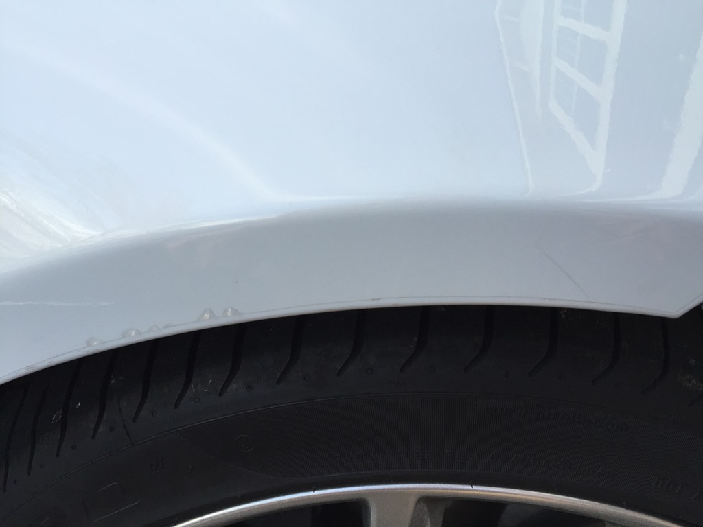

Now, on day 27, after a week of biblical downpours, I now have this:
Besides the bubbles that are holding the dirt (and there's a couple others), note the fine line to the right which appears to be a "crack" in the wrap.
So, I took it back to the shop and they're going to "stand tall", but I'm sharing their thoughts so that it may guide others in getting it right the first time.
The consensus in feedback from those most satisfied in Chapter 1 was having the bra wrapped around the edges.
When I had discussed this with the installer, he felt that he couldn't stretch the xpel product any more than he did (including that last two inches adjacent to the doors/side mirrors which is present in the templates viewable online).
Now, in discussing this with the owner, he simply said "we used the xpel templates and should have cut it by hand from the blank roll...we'll get it right and stand behind it"
So, I was inadequately informed going in to this, but I've learned a lot in 27 days. My suggestion to any who intend to get clear bras is that you insist that they not use the templates and wrap the entire hood around the edges as many of you showed in Chapter 1.
I think these guys really are going to get this right and have learned as much as I have...given that Jaguar is a relatively small share in its "space" I'm guessing the installers in small markets aren't used to such a huge hood when the space (at least here) is dominated by Porsche and BMW
So, caveat emptor...and be informed.

Stretching the film to cover a few more inches has no bearing on being able to wrap the edges or not, so that part of the shops story is bogus. However, using a template that either does not contain wrapped edges as part of the template or that has not been modified by the installer prior to cutting the film to include wrapped edges is never going to include enough film to wrap the edges too.
I don't know any installer that gains enough extra film to wrap all edges by "stretching" the film. Wrapping edges requires the film be cut oversized by approximately 1" in at each edge.
Now getting the film to cover from the front tip of the hood all the way back to the corners adjacent to the mirrors does require the film to be stretched because this distance is greater than the width of the roll of film.
+1. This lines up with the info shared by my installer.
