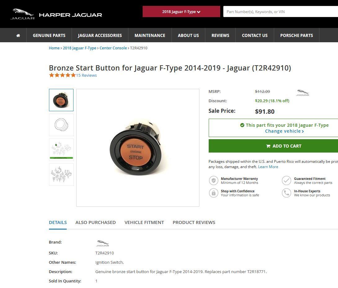

Hello Everyone - Well, I thought I’d spend money on a change I didn’t need – have always liked the Ignis Orange start/stop button more than the black one in my 2018 FT. Thought it would make a good Christmas present. Well, after reading some threads such as:
https://www.jaguarforums.com/forum/f...uttons-246876/
and checking several web pages, including Harper’s Jag (pic below) which said this part would fit, I ordered one – only to discover what you see in the second picture; plug from dash harness on left, old switch in the middle and the Ignis Orange switch on the right. No fit.
What am I missing here? Why does T2R42910 (orange) come up as a fit as well as T2R19038 (black) if that’s not true?
I thought I’d ask the forum before circling back to Harper’s customer service. Thanks in advance and Happy Holidays to all.

FYI update - below is the exchange I had with Harper. If anyone here on the forum has any details on this apparent harness change (and thus changed the rear connector on the switch) - and why, I'd appreciate it. Specifically wondering if there might be orange switches with the needed connector actually out there in the wild somewhere. First world issue I know, so definitely no big loss to stick with the current black switch. But it was supposed to be a Christmas splurge.
ME:
As you can see in the attached pics, although your website indicated I selected the correct part/color, it does not fit because of the connector type in the rear. Your email asking about the VIN (in my hindsight) must have been asking me a question about the connector type, while I was focused on the color.
HARPER:
looks like according to your vin the one you needed was T2R19038 which is the black button i know you want the bronze one the only problem is they don't show me the connectors and there are multiple ones that say bronze button on the picture's so i can not match a connector i just know its spoused to have the black one I'm assuming the harness in the car is deferent between the ones that have the orange button and the black button
ME:
is there any explanation for why your web page says it’s a fit? It seems that there must have been a harness change that is somehow VIN dependent. How did you know to ask? Is there a document or text somewhere that alludes to the harness change by asking for a VIN in regards to this part instead of just the model year? I’d sure like to understand that so I can share the knowledge.
HARPER:
So the web page is not 100% correct sometimes that is why if we dont have the vin we always will request it so we can verify with the official jaguar parts catalogue and make sure its the correct part. Because certain models of that car of that year may use that button thats why it says it fits that year but with your vin it says it dont fit because that is not the one they put in at the factory so i guess they use for say a different harness beacuse its probable that it has other features and other special things thats why it wouldnt work on your car. there is no document just thats what i would assume since the plug is different because the start stop button is gonna plug into the main harness since it sends power to everything to turn on
