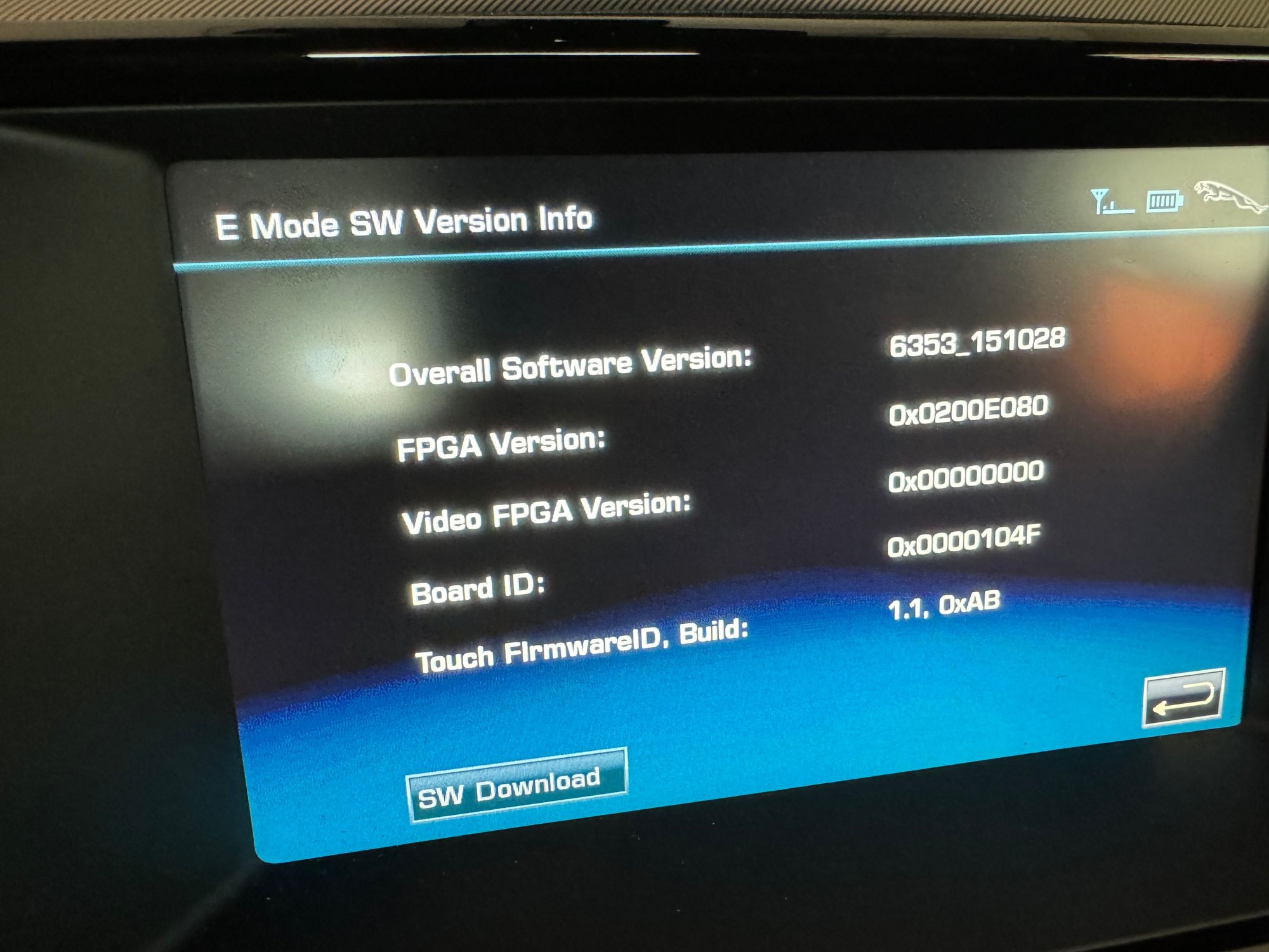

I know this has been talked about but I can’t find an answer or anyone that has gone back to “original” software/tune…I have been lucky enough to have owned a 2014 v8s convertible and now recently acquired a 2017 R convertible. The difference in pops and burbles is significantly less at low rpm as I recall vs the 2014 model. I could probably remove the fuse but would rather not…nice to calm it down once a while right?! Took this pic to see if anyone can tell me if I have “newer”/quieter software…or if this isn’t the info needed happy to provide. Thx in advance

That's the software info for the infotainment system and not the ECU. There is no way to identify what version ECU software you have without a specialty tool. However, the 2017 could certainly have had the quiet patch applied as part of its routine dealer service in its previous life.
