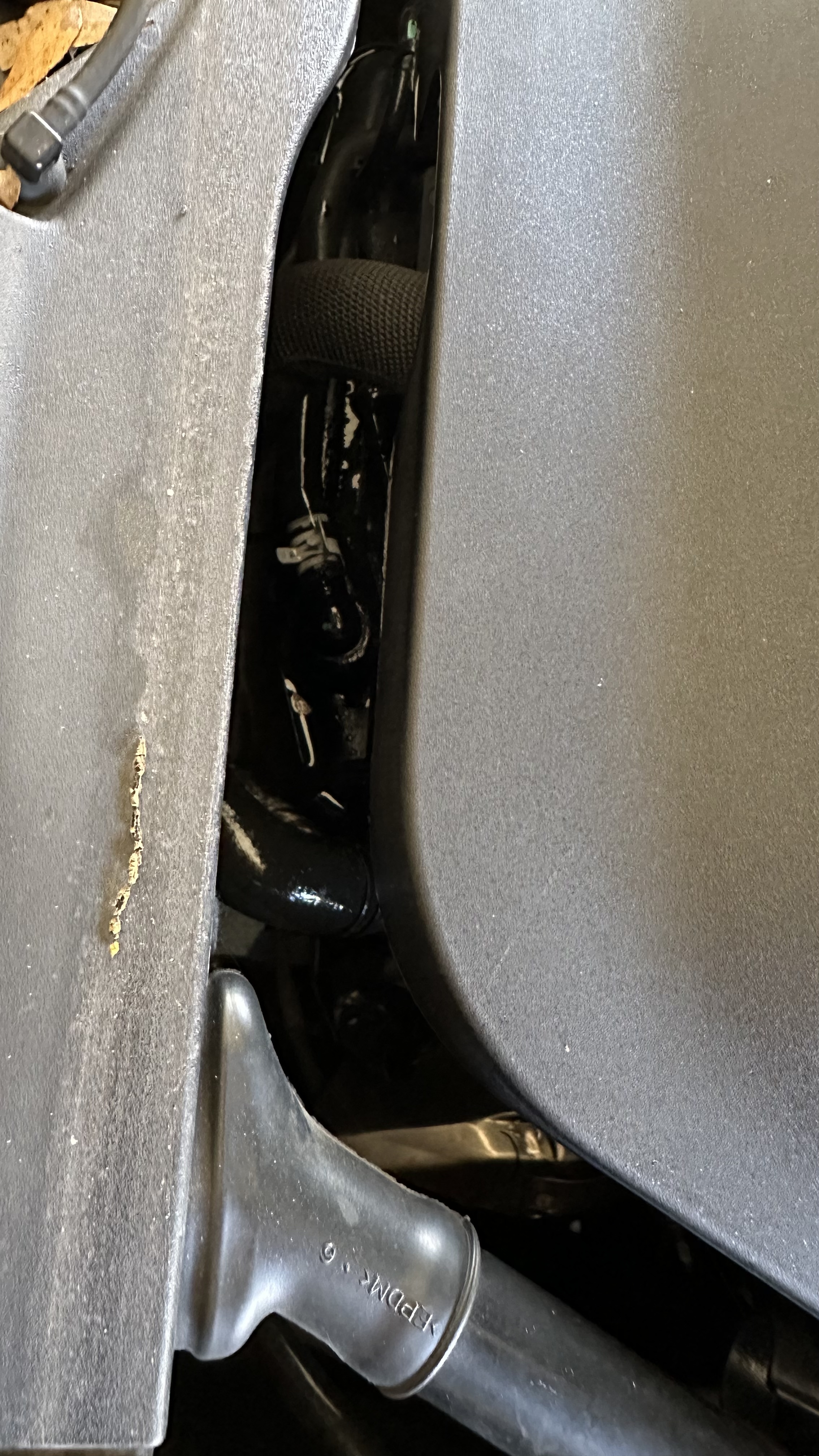

Have a 2017 F type base. Coolant was getting low so took to dealer who replaced a cracked pipe I think. Spent over 3k but was happy to get it fixed. But Couple of days ago after a good run, parked it and found fumes from engine bay. Noticed coolant on the frame and on the floor. No check lights and the engine runs when I got back from work. Did not dare to drive it. Considering towing to dealer. Initial talk with dealership the service person said it’s common with pressurized system for other places to show up if bad after fixing one. It sounded like a problem loop but I kind of understand it. Would think with such high labor charges to open everything up to get there it makes sense to change anything that remotely looks worn out. Wanted more info to get a better fix this time. Please help. Thank you

Looks to me like the classic split seam in the older style top cross-over coolant pipe.
Have a gentle poke and prod of that seam to check.

it was a Y pipe before. I just looked back. Finally towed it to dealership. They are gonna do pressure test and let me know.
