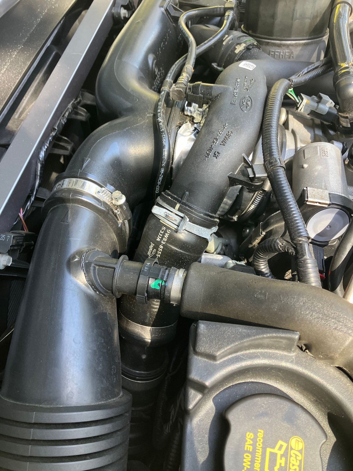

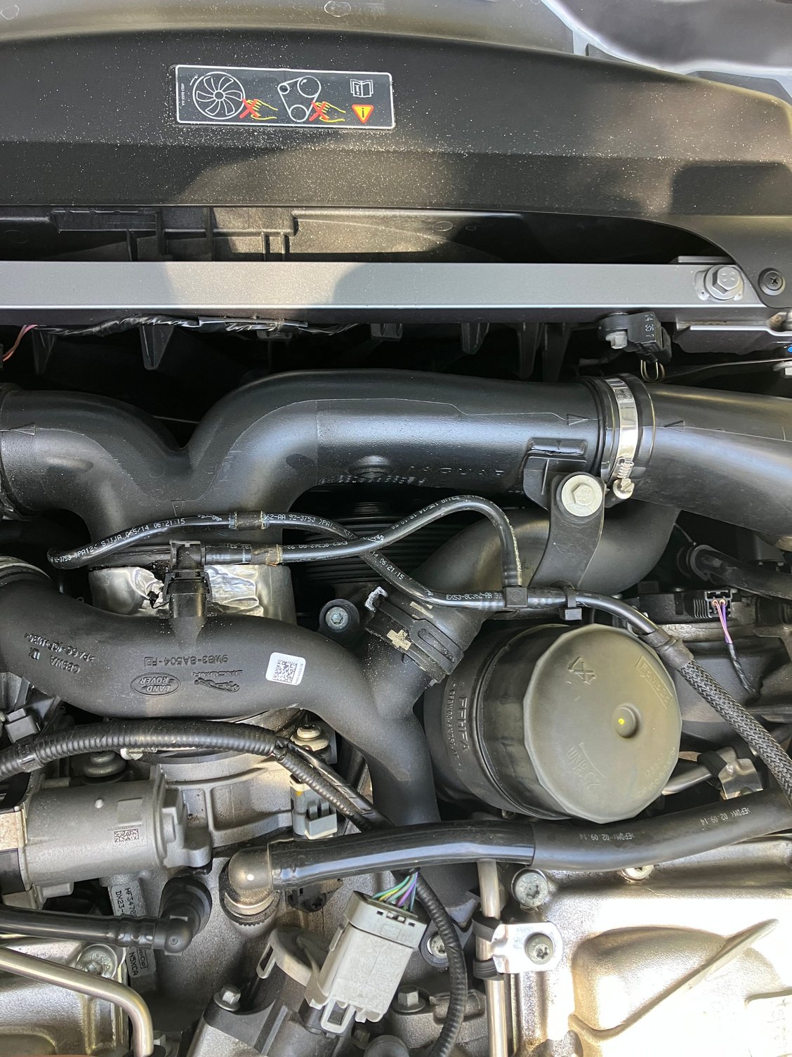

Hello all. My recent purchase f type has 30k on the clock and could be described as a garage queen. Prudent step would be to replace the coolant pipes but I wondered if any type of visual inspection could indicate there condition

Take the engine cover off and post a picture of the front coolant pipe. Many cars had these replaced under warranty, so there's a chance you already have the upgraded one-piece pipes.

Coolant level seems constant. Here are some pics

Those appear to be the updated plastic pipes. You should try to find a dealer that would give you the service history on the car. It would probably show when they were replaced.
doesn’t matter if they were updated or when. Mine had the original design fitted and they didn’t fail at the seams, they failed where they make contact with metal. They were replaced in warranty with the updated design and those failed too after 3 years And about 60,000 miles. Now that JLR offer alloy versions, there’s no reason Not to use them.

You have the new-style pipes. Congratulations, this is now a non-issue. As someone else suggested, it would be worth pulling your service history to see when this was done.
False.
See my post # 14 above. Main dealer fitted the revised design on mine in Warranty and they only lasted three years before they too failed the same way the original Versions did. JR now offer I versions as an option.
