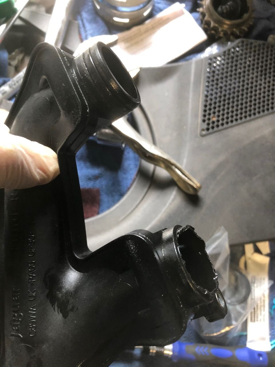

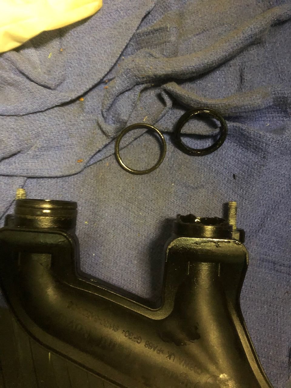

Still false. Some have had the seams fail but the majority of the failures occur where the plastic enters the alloy block. The plastic crumbles to dust. Happened twice with the crossovers on this engine as well as the other plastic connectors elsewhere in the circuit including supercharger pump, heater lines, radiator, thermostat, throttle body, etc. Over time they just fall off and crumble. If you research these forums you will find many members with the same failures along with pics. I have substantial experience servicing these engines and speak from knowledge.
The JLR genuine alloy pipes have 0 issues with fitment they even come installed
in new vehicles. If there were manufacturing issues at JLR they would have obviously been addressed by JLR.

@diablo2112 I too thought the glued seam was the problem. And for the rear pipe it may well be (based on @CarlB's photos). But from the UK forum - some nice pics of the newer version plastic pipe with failure at the junction @jahummer emphasized:
https://www.ftypeforums.co.uk/viewtopic.php?t=9031

Not to beat a dead horse, just please understand it's the plastic that's the primary problem. On mine nearly every bit of plastic pipe throughout the entire circuit's failed at some point. Yes some seams leak but it doesn't matter when the pipe disintegrates. Here are some pics, they all look the same as mine did. As you can see they consistently fail the exact same way, both the latest versions and the originals. Fortunately there's genuine JLR alloy versions which're a perfect fit and lifetime solution.

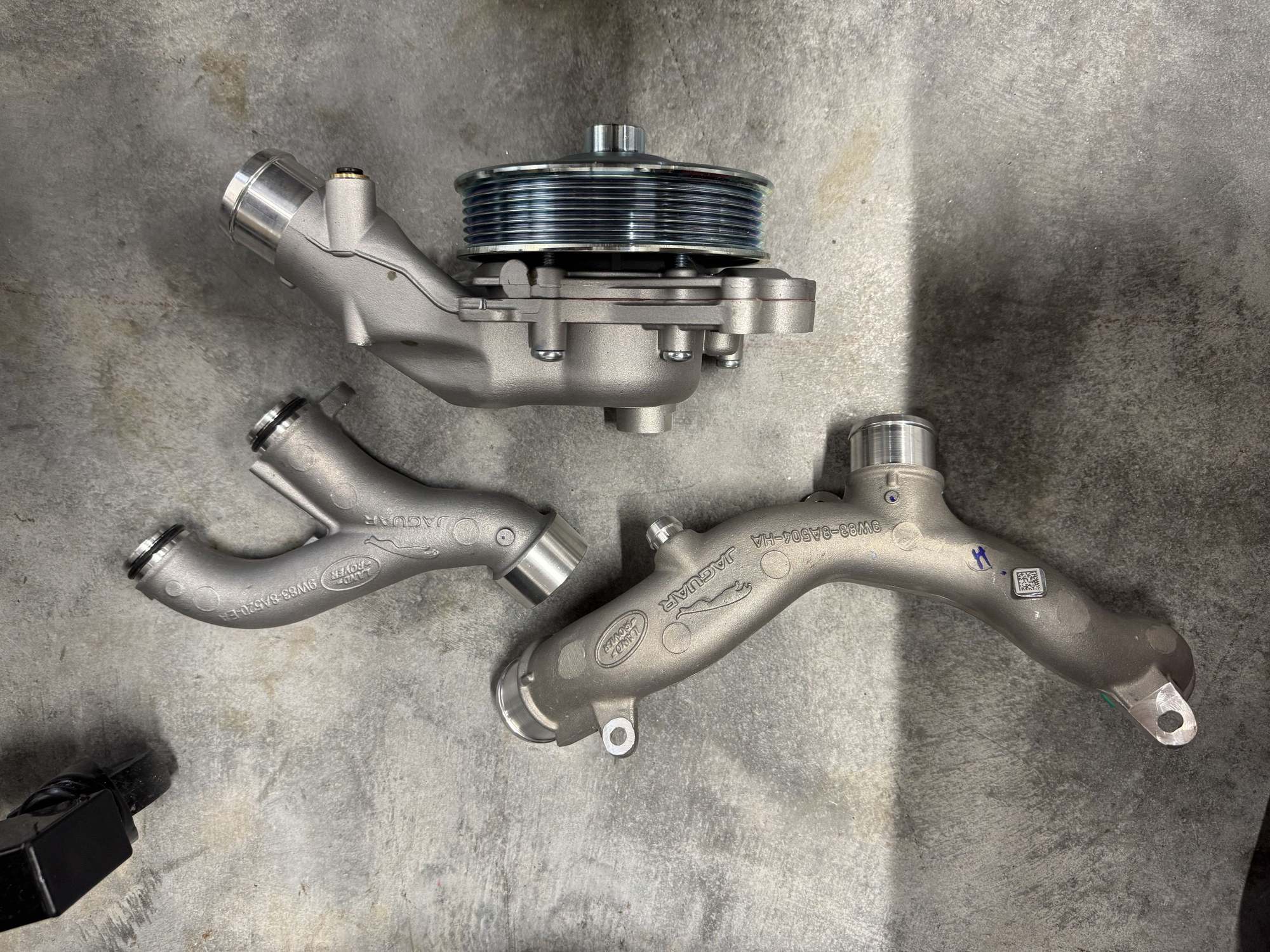

Just had a quote from my JLR specialist in West Yorkshire to replace the 3 problematic plastic pipes for alloy ones including the new alloy water pump. Ł1,350 (circa US$1,700) for parts, labour (6.5 hours) and taxes. I'm not sure if I'll get it done this year as the car's only done 34K miles but it's really not a lot of money for peace of mind.

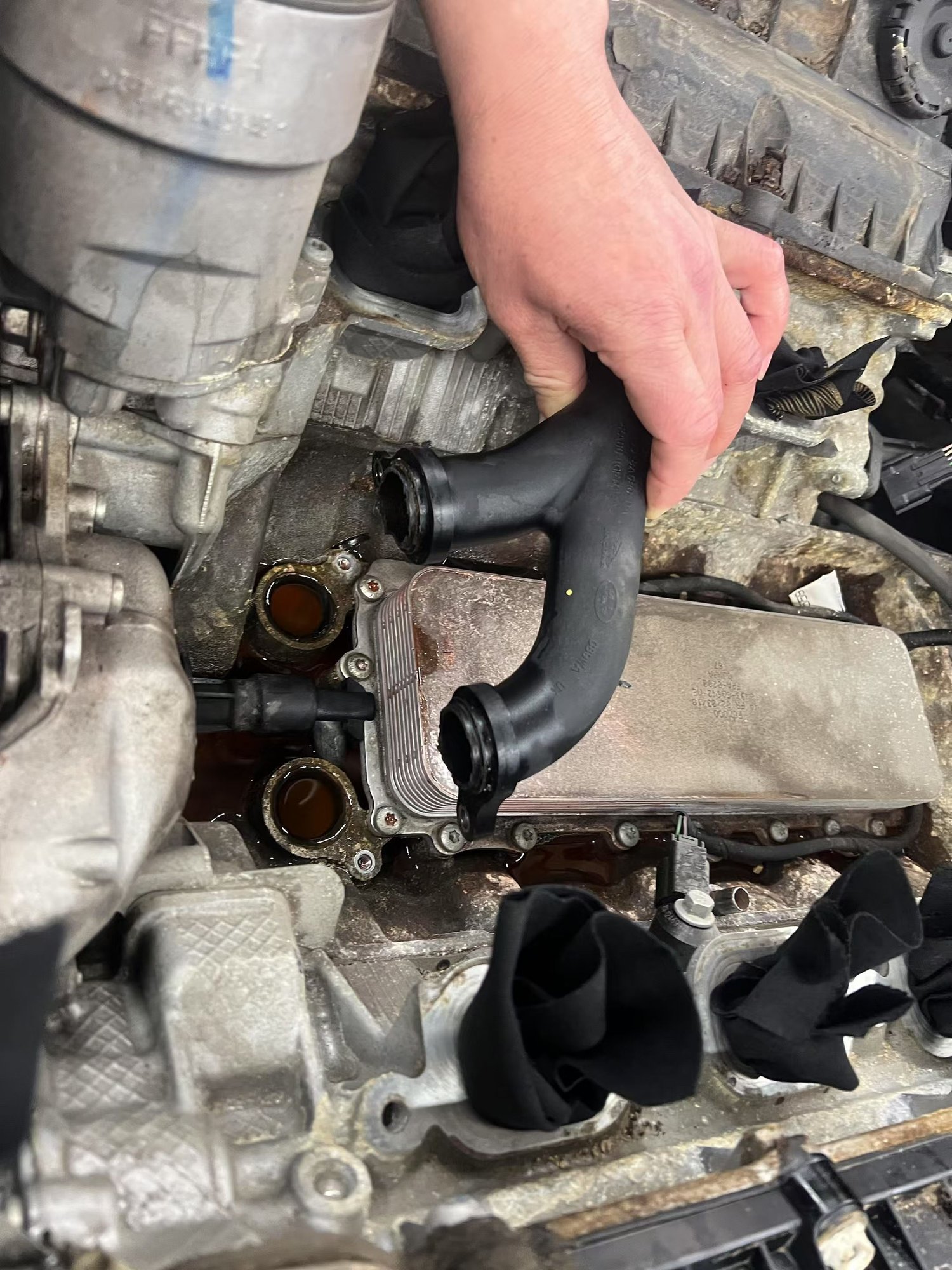

Just changed mine out. They were the original design and made it 92,000 miles. When we pulled the Y pipe it was way corroded. One thing to note, we used the updated JLR aluminum parts and there’s one flange that is significantly less thick than it’s plastic cousin requiring us to shorted the existing fastener.
