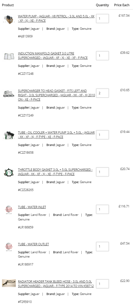

Would this be the right shopping cart for the job if I want to go OEM? I the pipes are these "new" jaguar aluminium ones, but I am not sure if anybody actually put them into V6 F-type yet...
The 3 pipes you’ve listed are plastic as that’s all JLR offer. I’d highly advise replacing with aluminum as discussed in this thread unless you intended to do this full service every 40-50K miles.
They are not, only the oil pipe. The remaining two are Jaguar Aluminium. Check the part no.
However, I did not find anybody here who would use them yet on a V6. But the plastic ones are the same for V6 and V8, so I hope these will fit. There were fit to F-paces and land rovers tho...

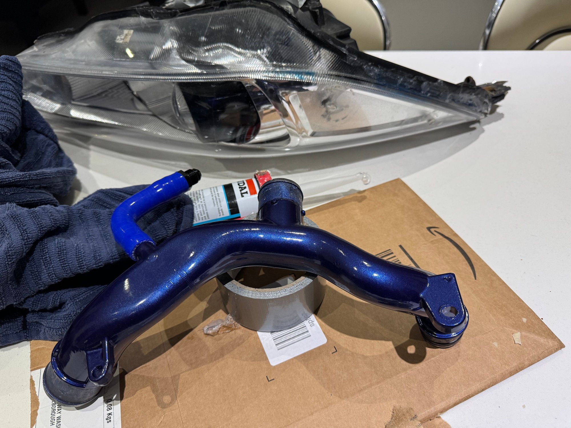

  1. Replaced mine and have the rear crossover one waiting in the garage
  2. decided the bare alloy is untidy
  3. also converted mine to allow fitment of an6 fittings after the hose to the header tank popped off
  4. ps the silicon was for a headlight on my runaround

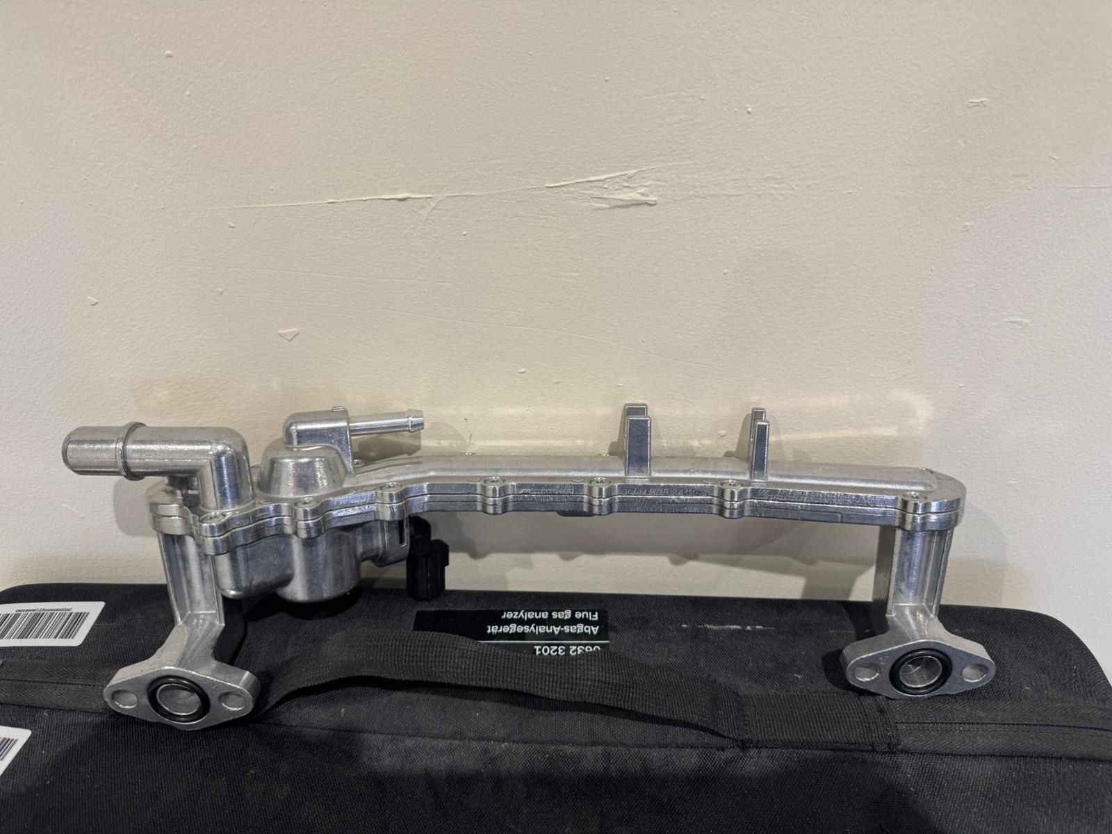

Got the rear crossover pipe from Ali express
Old Feb 7, 2025 | 05:24 PM
  #594
sov211's Avatar
Posts: 3,919
Likes: 2,524
From: Victoria, Canada
Better than Ali express is simply buying the metal rear crossover from EuroAmp, which is what I put on my car. Perfect. No issues.

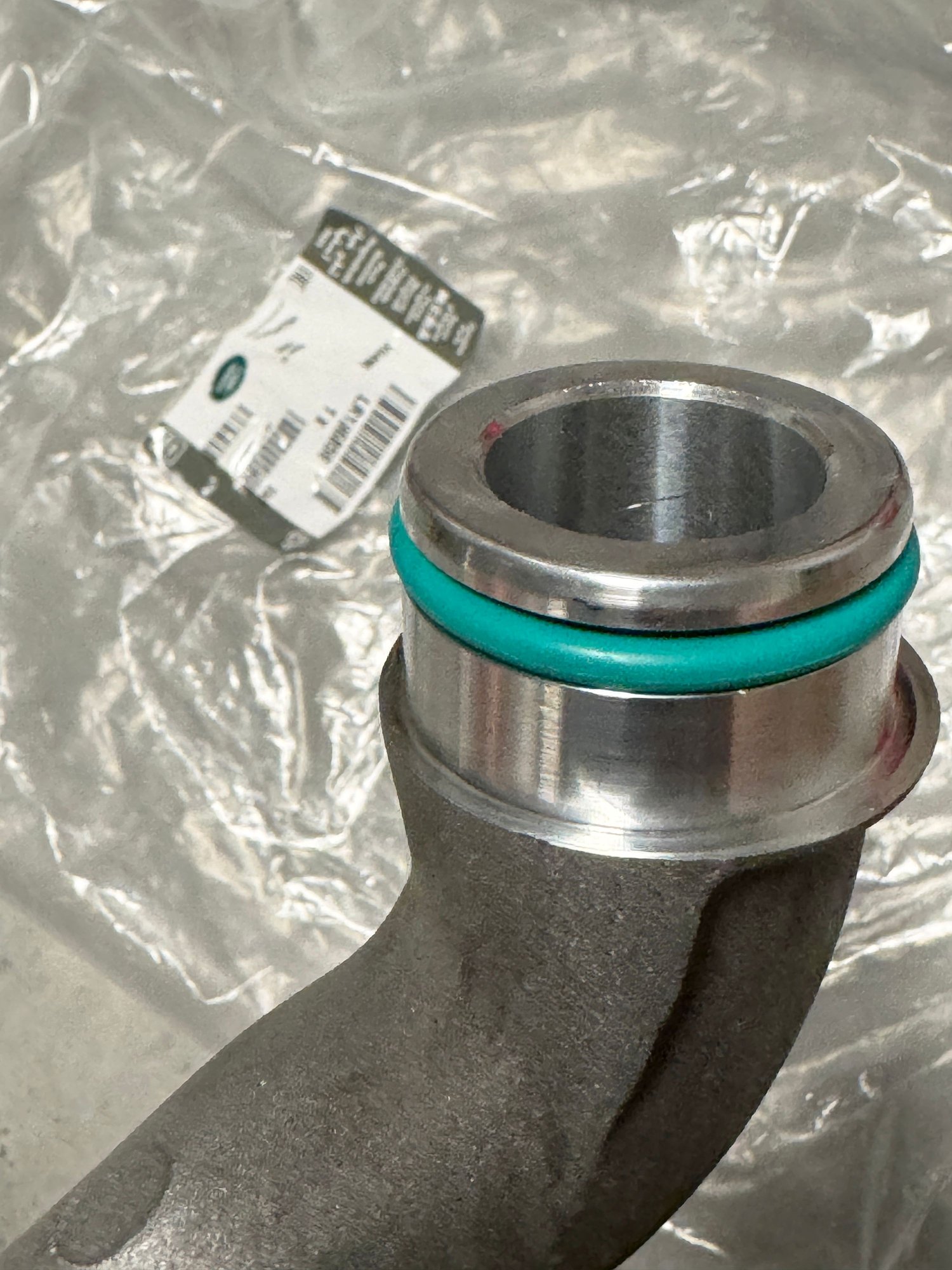

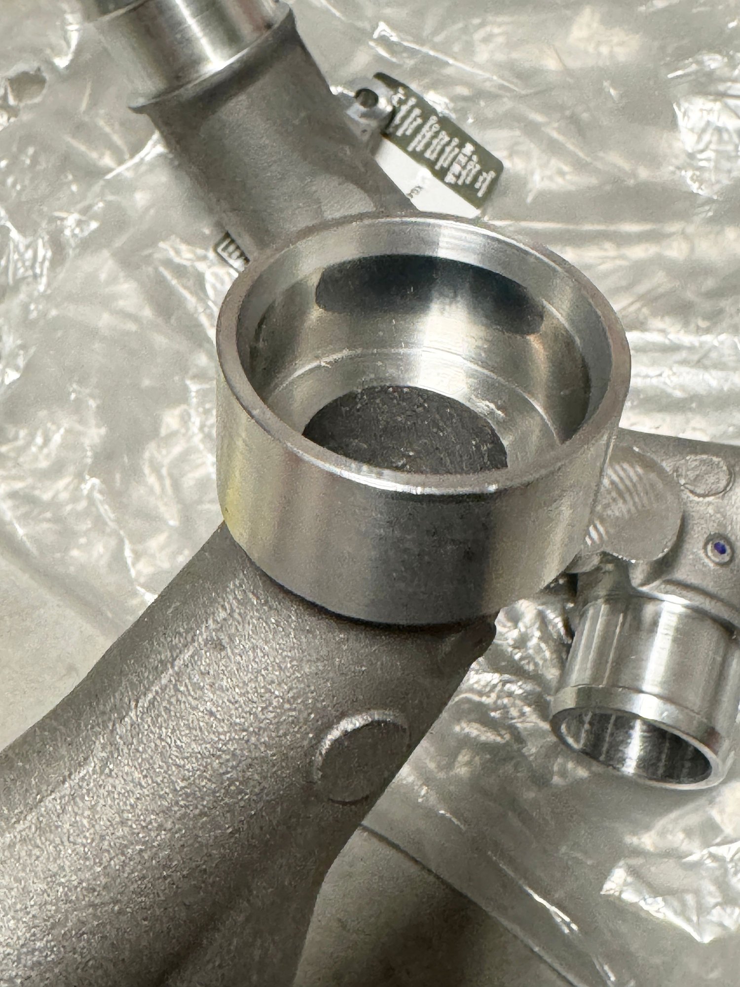

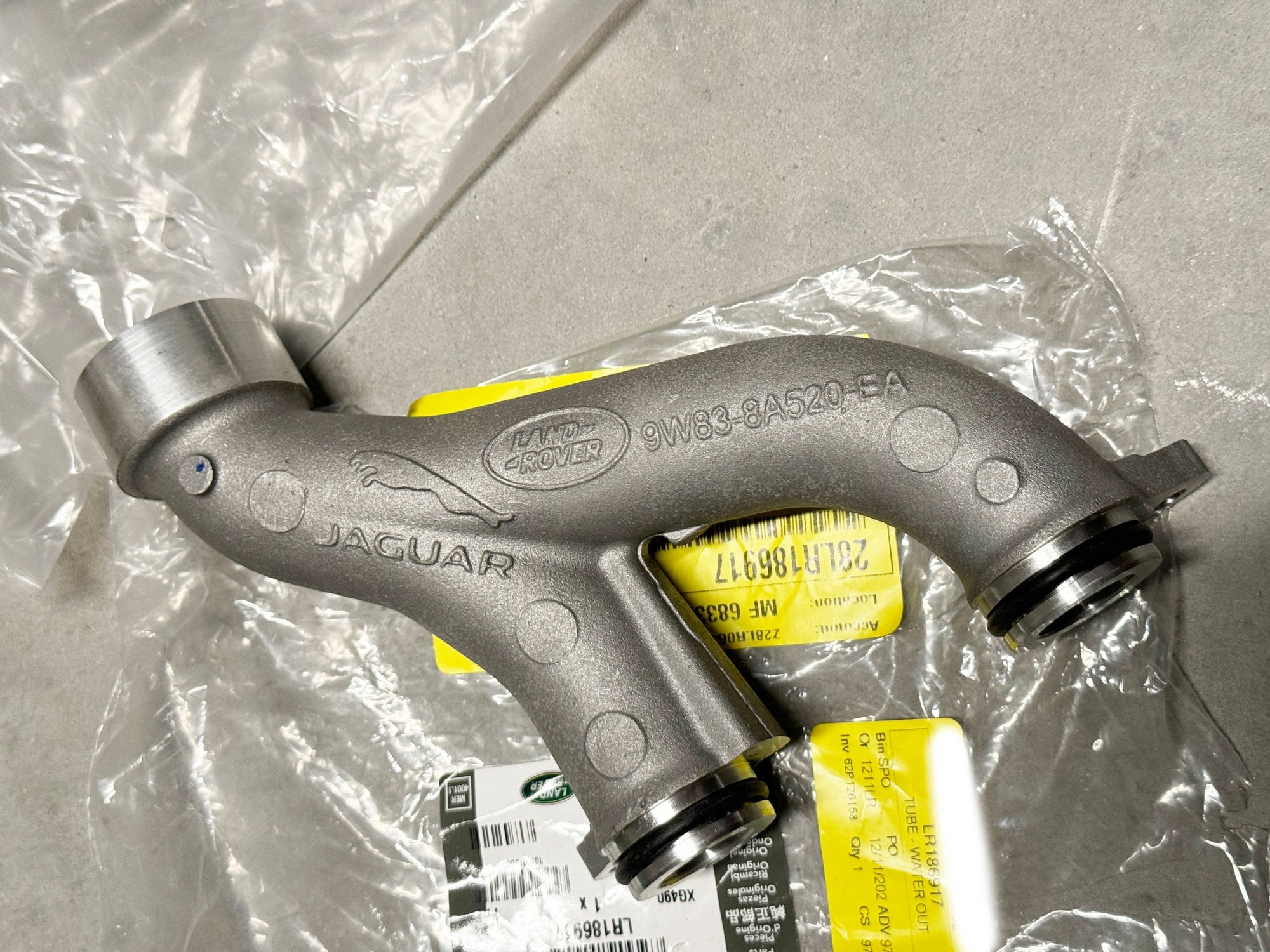

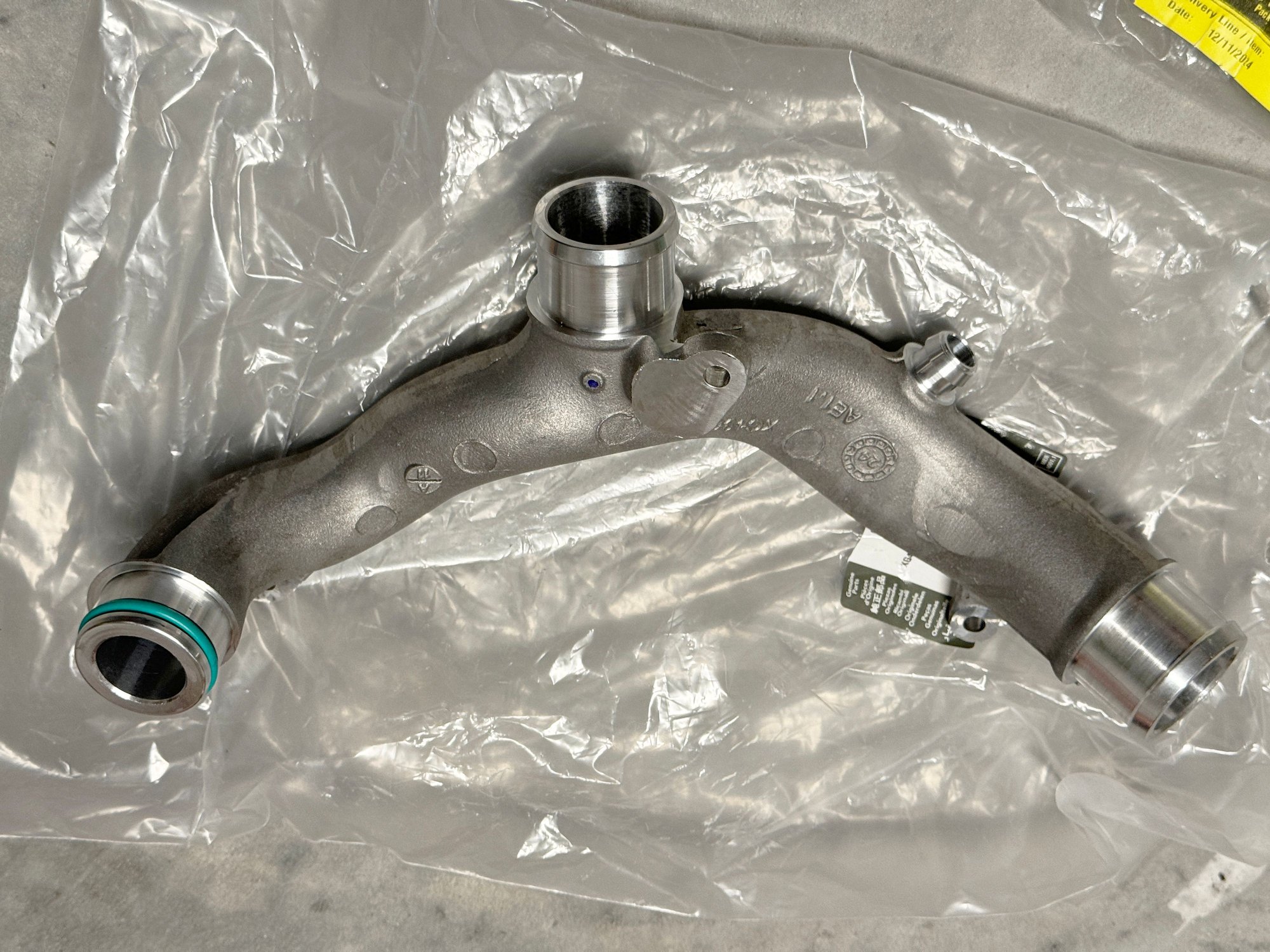

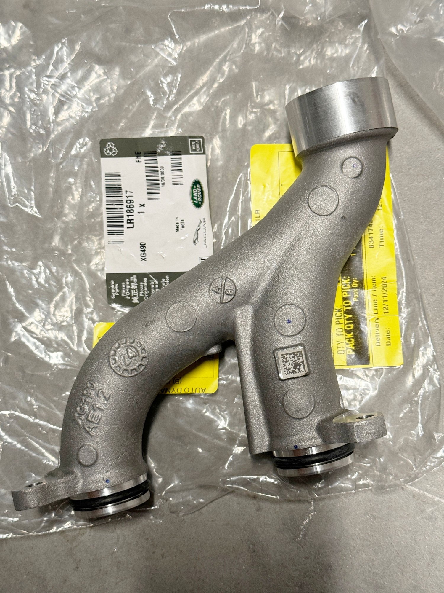

Here are the genuine JLR versions

@jahummer Thanks for the pics - I like how the new OEM aluminum pipes have cast logos and actually look good. Now ordering mine from a JLR dealer online. I noticed many "OEM"s on eBay without the cast J and LR logos, part number and QR code. Just the cut out JLR part label placed on top to make it look legit. One did have the cast logos but no part number or QR code.
What was your source for the aluminum C2Z18658?
