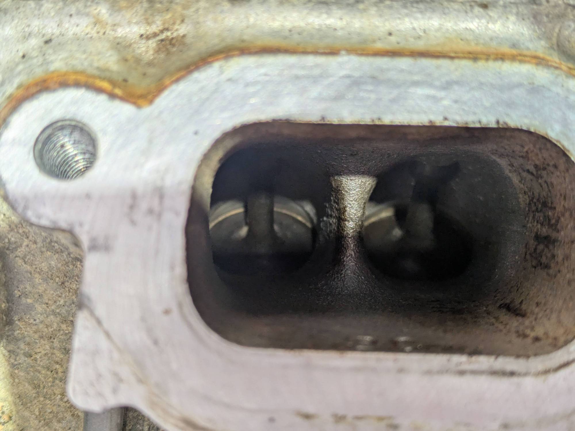

Originally Posted by CarlB
I'll share some of our experience/progress. The job isn't completed, since I need some VC related parts. That's called foreshadowing.
-Supercharger was very stuck, so I used an engine hoist to put tension on it while hitting with a dead blow. This broke the seal.
-The supercharger sound insulation underneath collects/holds water and that rusts out the valve cover bolt heads. I removed the insulation.
-The valve cover bolt heads are captured, so unfortunately the VC has to be removed to replace them.
-I have no idea how anyone would ever pull that Y-pipe or snout with the SC still installed on the car.
-The #6 intake valves were extremely dirty, along with visible oil pooling at the back of the SC. Looks like that's where the air pushes the oil vapor. Other cylinders were very marginal compared to #6.
Here are some shots after the walnut blasting. Much better!

Originally Posted by JagCode3
@CarlB For those with or considering a methanol-water injection kit, I wonder if the mist just ends up in one spot. Seems like there's no way there can be a uniform distribution of mist for all the valves, even if the injectors are drilled in past the throttle body.
Did you DIY the walnut blasting? Better than a brush and carb cleaner, and "all-organic"
I think it's partially the speed of the air, since it stalls at the back of the charge cooler. But also the fact that's the rear wall, so fluid is more likely to stick/accumulate onto a surface. So while not perfectly uniform between all cylinders, it is being distributed.
This was DIY walnut blasting.
@CarlB Nice! Did you do all the valves?
I could have really used this setup when I had my Audi TFSI 2.0 with the carbon deposit issue.
Just #6, since all others were just a tiny amount on the stem. My wife wanted to just let those fly for now. I'm going to see about adding an improved racing catch can.
