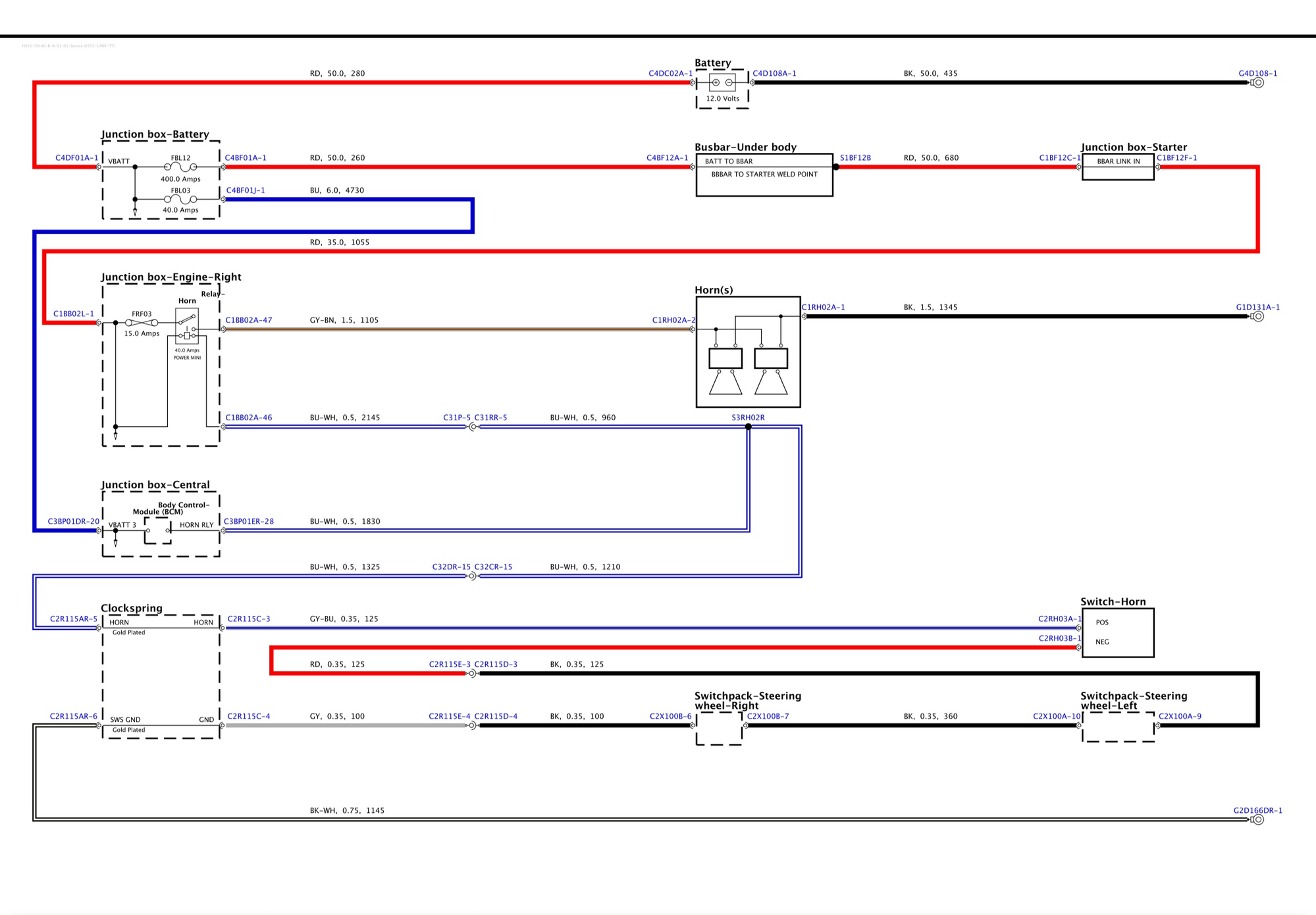

Check out p. 6123 of the repair manual…
https://www.dropbox.com/scl/fi/o6d1x...=ca94kbr7&dl=0
It says you have to remove the hood to remove the horn. I would see if I could get to the connector and disconnect it. See if the fuse still blows if it’s disconnected - that would tell you whether it’s the horn or the wiring/relay. The manual says the horn is powered via a relay in the right engine junction box.
Do you have a code reader? There are a number of horn-related codes that can be thrown, detailed in the repair manual.
Here’s the schematic of the horn, from the repair manual. Note that it can be actuated either from the steering wheel switch, of by the alarm via the body control module (BCM.)
