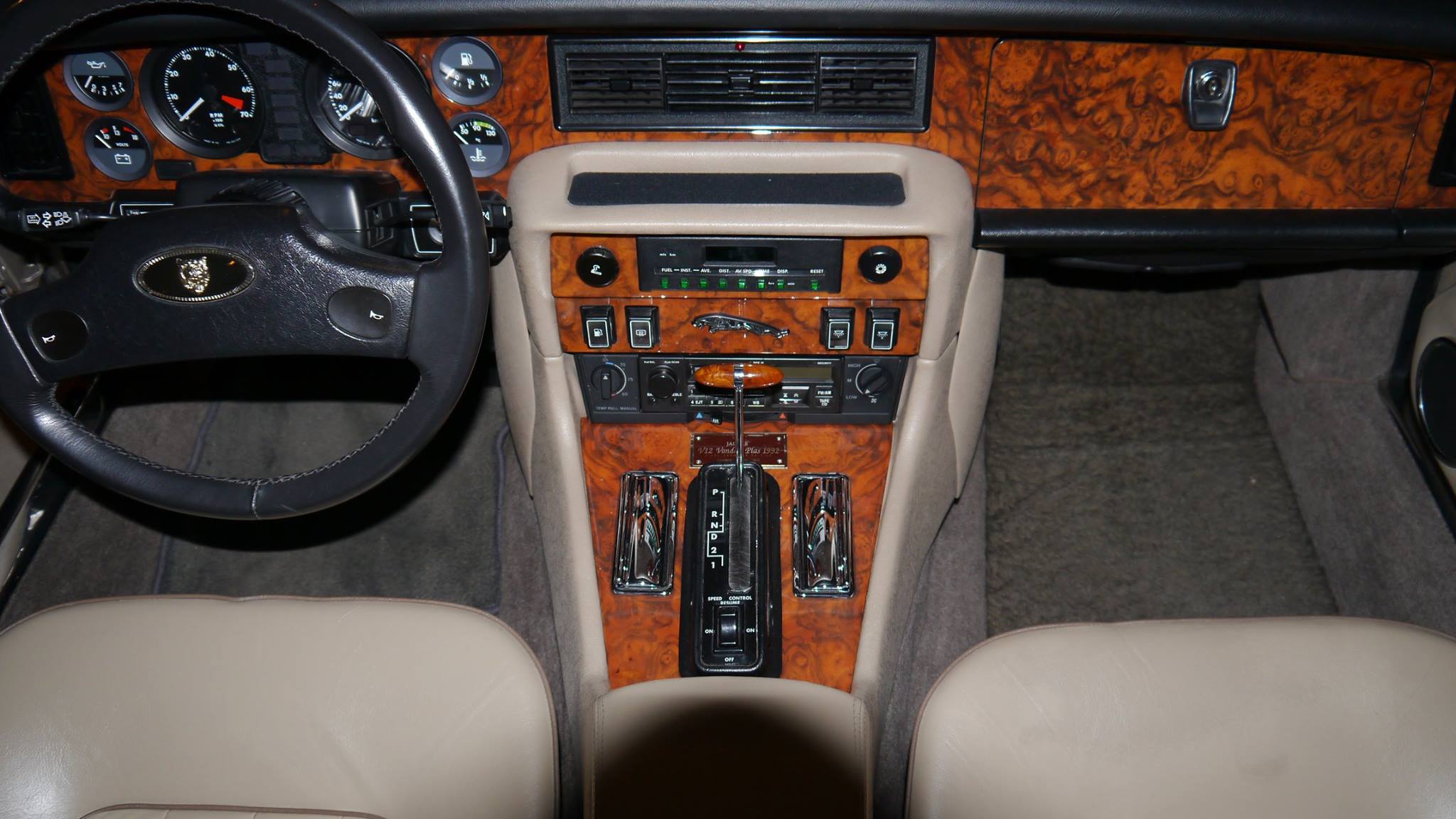

Jaguar themselves used the XJS steering wheel on the '92 Series 3 cars.
