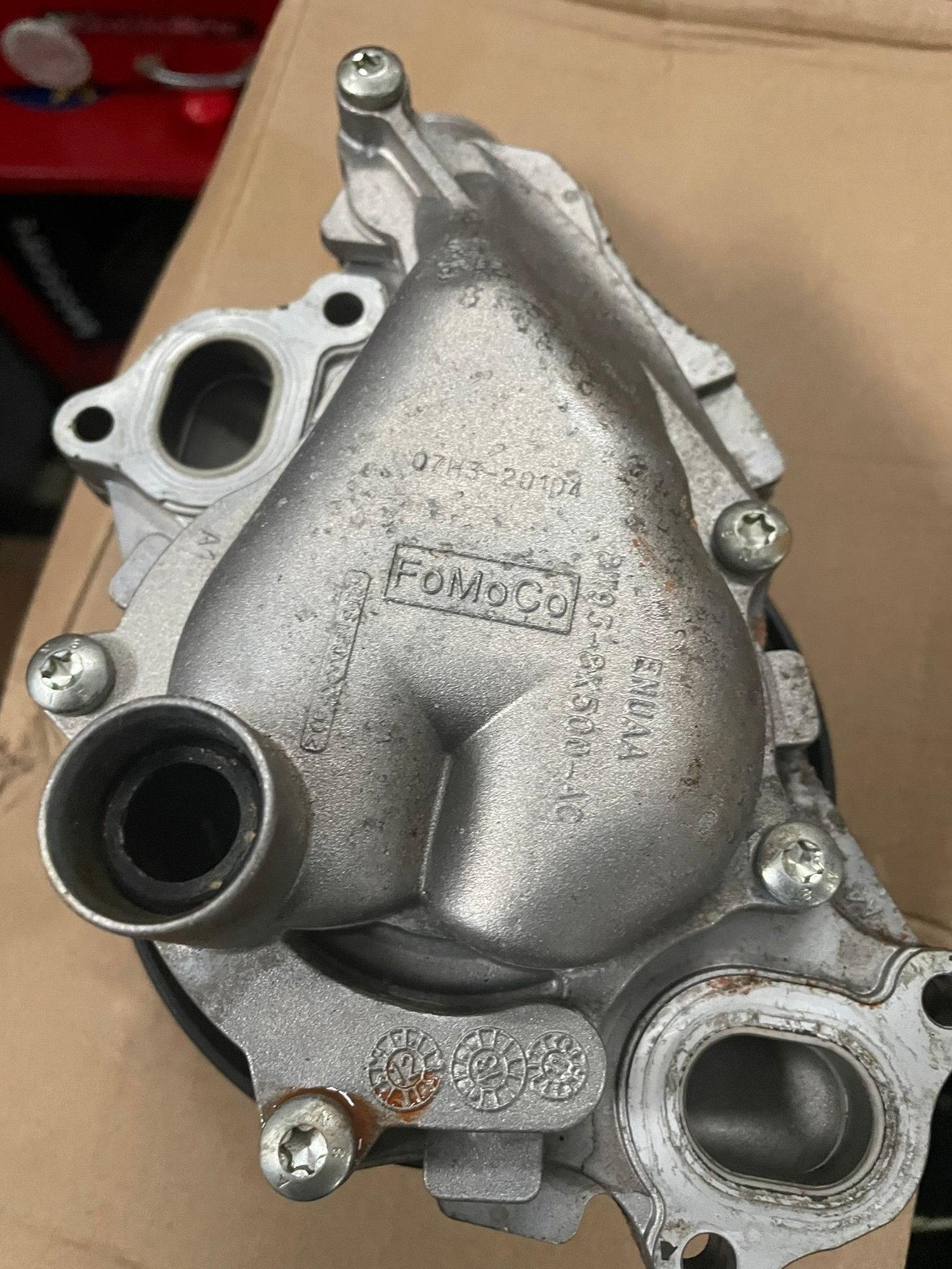

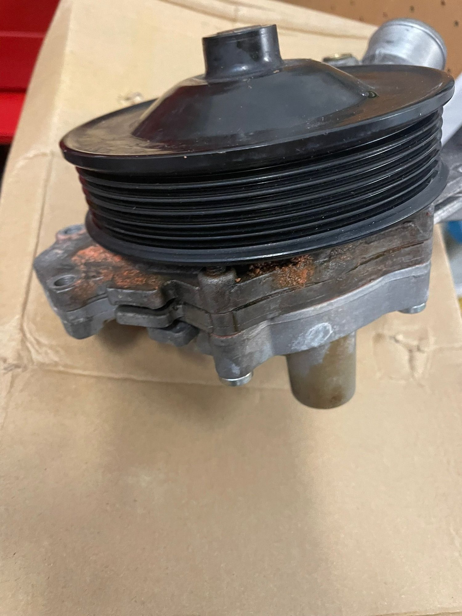

From: Exit 30 in NorthWest NJ
@bfrank1972 Our indie Jaguar shop made the choices regards most of your questions. He did NOT replace the SC oil, but I would recommend it since it is difficult to actually tell how much is in there.
Our water pump was noticeably leaking a bit after it was removed, so best to have one on hand IMO, especially if you ever needed to top up the coolant in the past. We would get a telltale stain on the underside of the bonnet occasionally.
