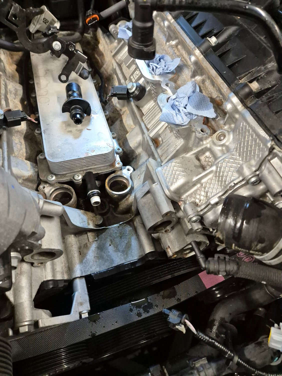

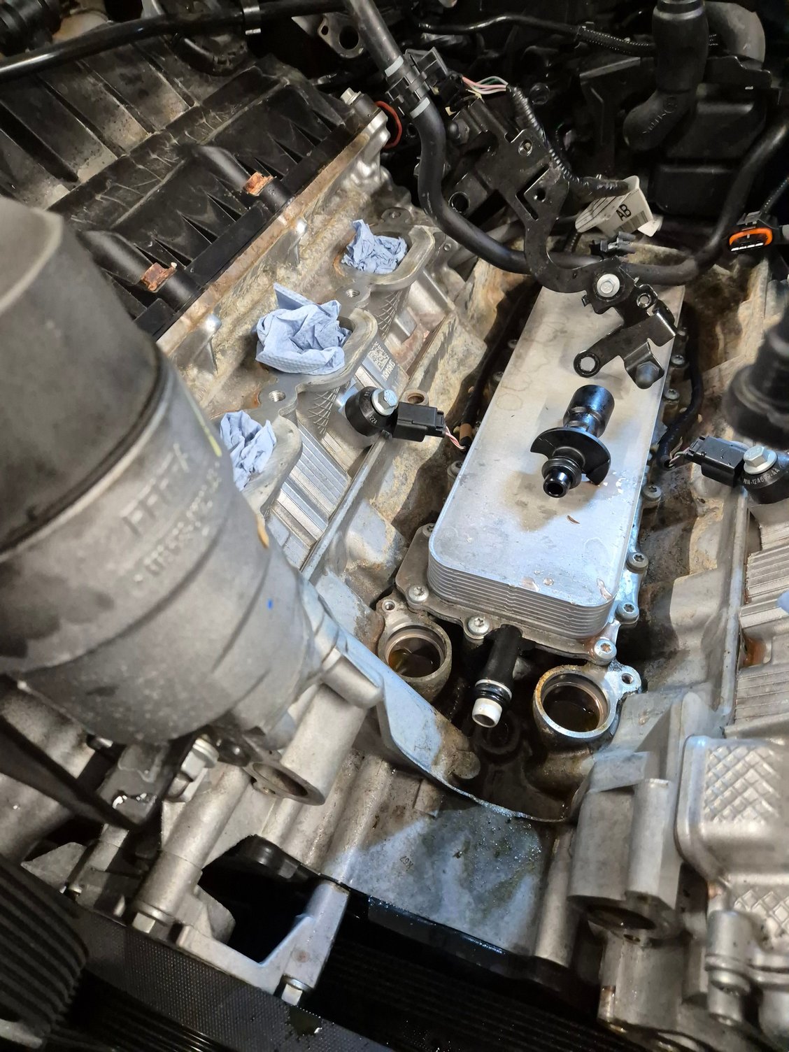

Just had a huge preventative maintenance service done on the Jaaaaag. Among other things we did the new OEM Aluminum coolant pieces and the Euro Amp Aluminum Rear Coolant pipe & Thermostat. Being tested over the weekend and I'll get her back Monday. Will report back of any issues.

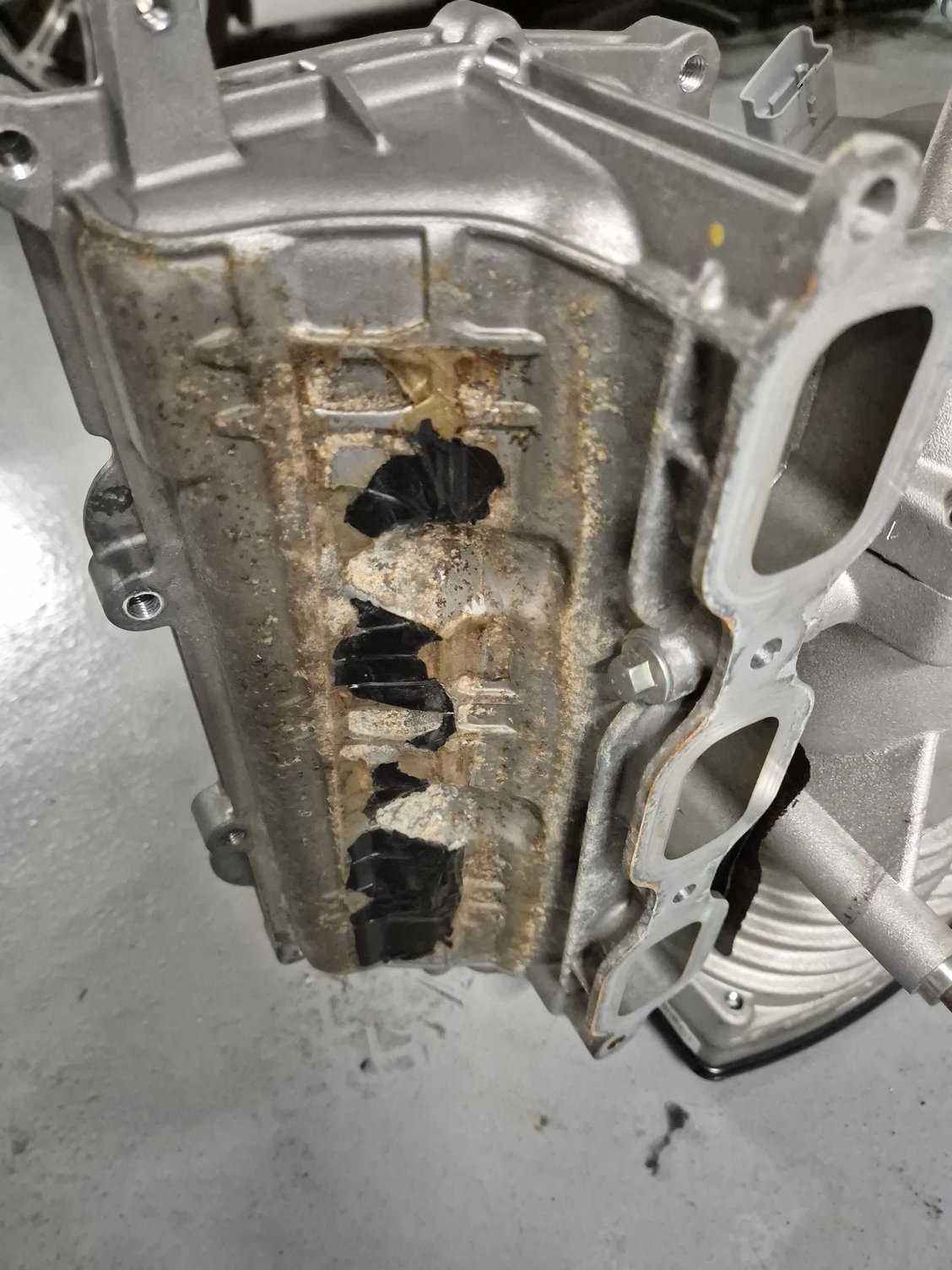

This is how my underside of the SC looks like... And I don't even have the large vents in the hood...
What in the hell? That must be from coolant eating the aluminum. There's no way that's just corrosion.

I really don't think that coolant would do this consistent effect on the whole block/supercharger. The oxidation is everywhere, there is no way coolant would be that high and that consistent I think. Also F*** the person who thought having no drainage in the block is a good idea.
Anything is possible but highly unlikely. That portion of the supercharger is the intercooler manifold, so it would happen from the inside out.
5.0s from Ford are also Aluminum construction and experience no corrosion internally a significant level.
I also don't think there is any coolant running from the other internal side. This could be rain or somebody washing the engine and trapped moisture under the foam - I think. You can see the classic 2 rusted bolts on the right side of the valve cover too.

Agree, the foam traps a lot of moisture. Aluminum doesn't really corrode, alloy has a risk of having real corrosion, but this doesn't look meaningful in any way either. Best wishes on the cooling upgrades!
Coolant runs on both LH and RH sides of the charger cover - those front plastic bits are coolant connections. I think MAHLE makes these for OEMs and is the parts supplier to Eaton/JLR.
The bolts rust because they aren't aluminum. Aluminum doesn't corrode unless subjected of high ph. Isn't the picture above showing rusted through aluminum or am I looking at it wrong?

The black portion with bits on, is the plastic foam pad removed from the underside of the Eaton charger. I'll try to find a picture of a factory charger underside, but if you look at your vehicle you can see a black sheet poking out between the intake manifold and the valve covers.
EDIT: Here's a V6 charger underside. It probably looks similar under the foam. The listing shows 32k miles on it, so it looks newer.
13-19 Jaguar F-Type XJ XF V6 3.0L OEM Supercharger Intercooler Assembly - 32K mi - Picture 6 of 23
What, where? Under the supercharger? There is a residual glue and foil from the foam and there are 4 symmetrical "pockets" in the form by design here but all is surface oxidation. Btw, rain is acidic.
Also, as any engineer would say, everything oxidize
Looks like black plastic and glue or foam. At first glance, I also thought it was a hole in the bottom of the super charger.

@J444G Bravissimo on exposing the "sous vide" effect of the foam - the black envelope traps moisture in the foam and allows for basting of the surrounding metal. I used to think a hot engine would evaporate all moisture over several hours but not with the foam there.
Use a steel polishing wheel on a drill and clean it all up?
