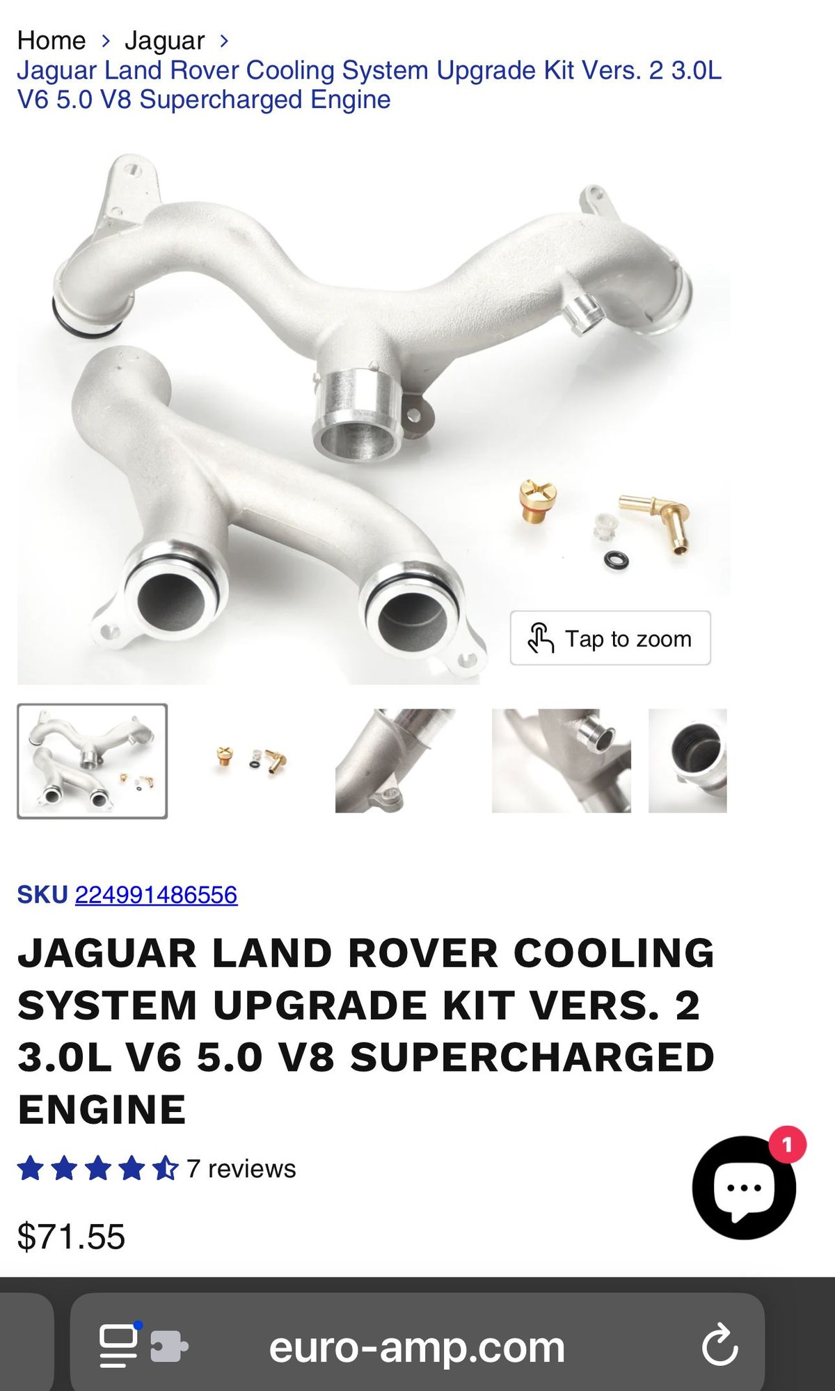

Default Alloy Crossover set for all engine types

This is the first time I read something about ordering 2 extra O Rings for the fittment into the waterpump and oil cooler brick 😡.
We changed all the plastic stuff for this Euro-Amp Kit and now it is leaking. I bought 1 new OEM O ring but the fittment of the alloy part seemed somewhat loose on the oil brick.
I hoped all would ‘settle’ but unfortunately it leakes and the SC have to be removed again.
The original plastic engine cooler pipe has a tighter fittment.
so…should I use 2 O rings on both sides or how should it be mounted without leaking?
tnx

Order the genuine alloy parts from JLR. Fitment’s perfect and much better quality, and won’t Ever leak.
