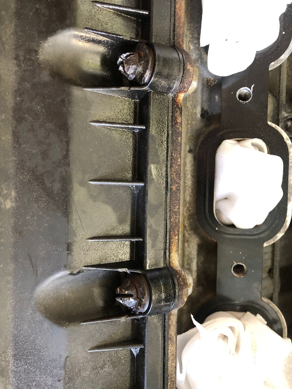

I'm not the only one that has lost valve cover bolts to this terrible design.
The cold V holds water with the hood vents and foam under the SC and between the SC and charge coolers. The intake port gasket isn't going to love that and I can't imagine I'm the first. The most likely scenario is most owners haven't dug into it.
I don't disagree but I've seen quite a few of these without corrosion. I've submerged mine numerous times for washing and it looks brand new. That corrosion on yours looks like salt creep or highly acidic water. You'll need to thoroughly remove that corrosion and make certain the mating surfaces are true.

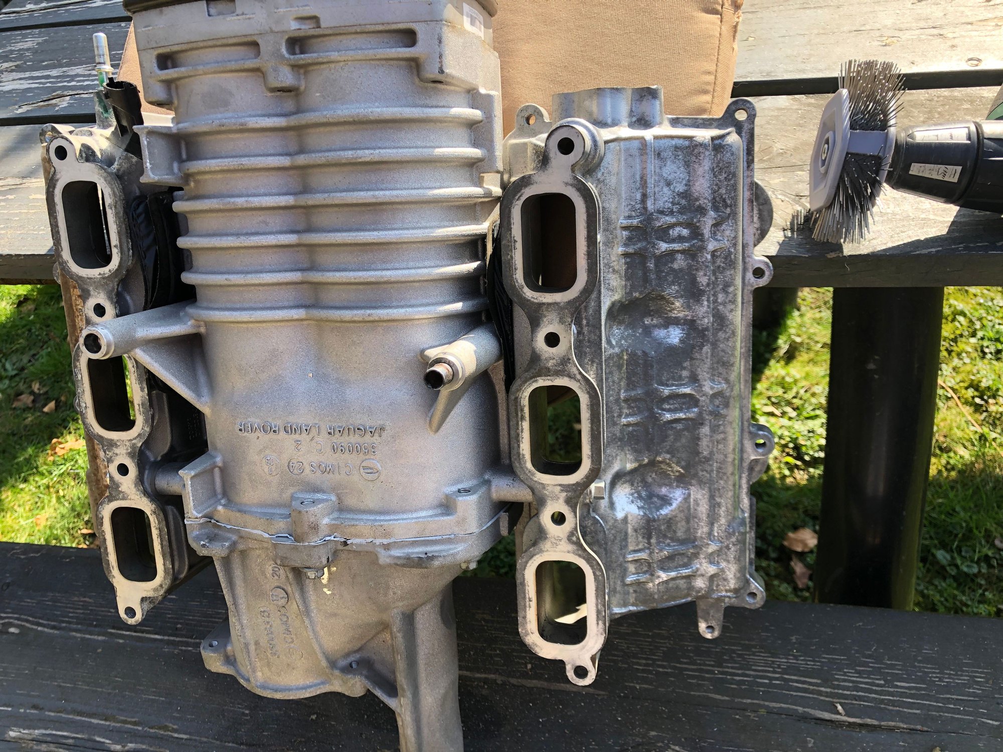

@CarlB I had very similar rust/corrosion on my intake runners... I just did my Y-pipe + S/C coupler and also ripped out the noise suppression pads and covers... resulting in some additional engine noise which is not bad.
I did publish a video a while back on the CatchCan. I also inspected my intake valves and they were in pretty good shape, so i think my RHS catch can is working for me.

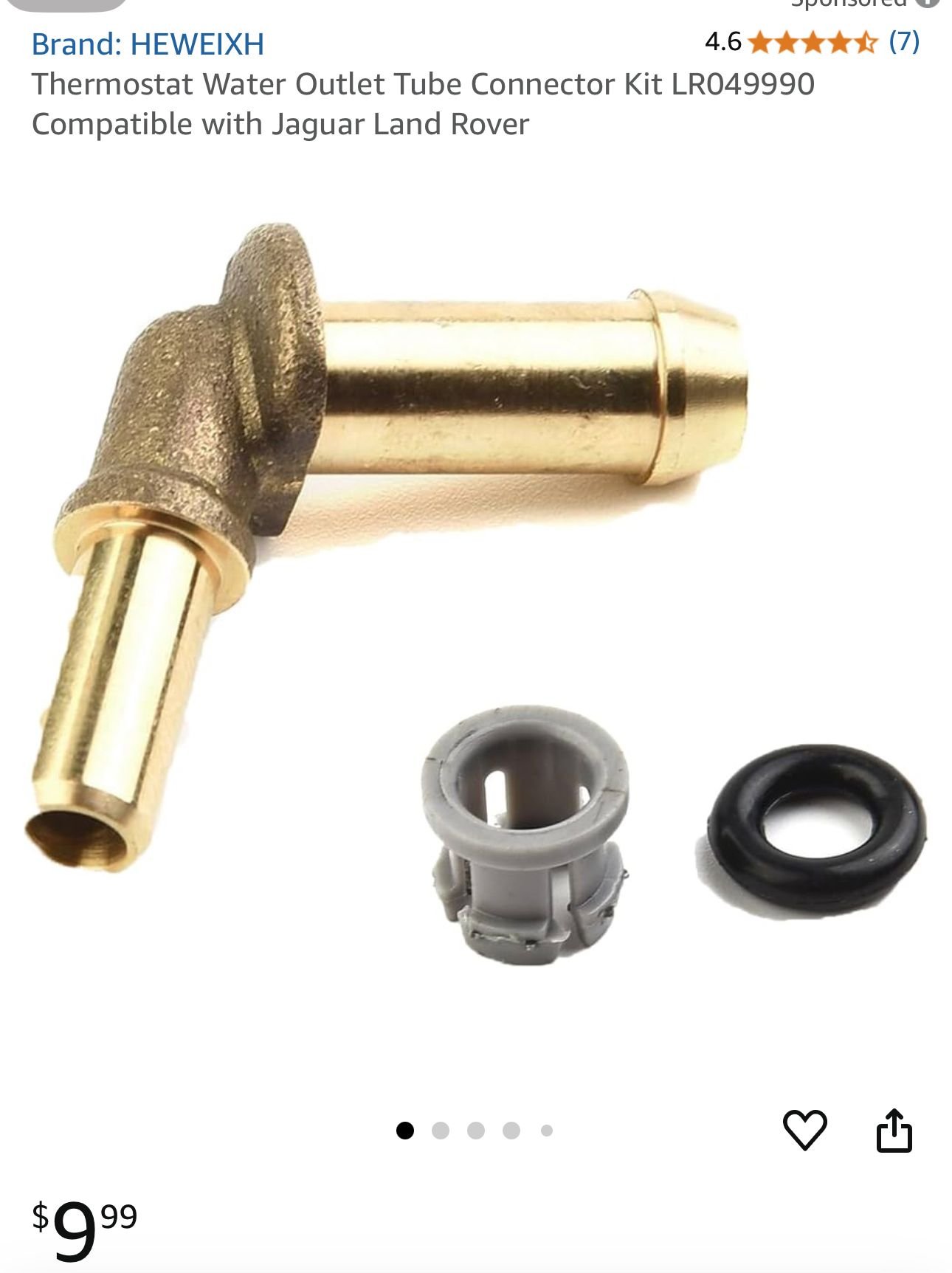

I just did the y pipe replacement on my 2014 US XKR and used the RKX Tech kit. I can confirm that by removing the throttle body, water pump and idler a few hoses I was able to replace without removing the SC. To get the old pipe out I had to cut the RHS foot off the pipe. Al pipe went in with a little jiggling but I was unable to remove it. Bolts were placed in their holes using a magnet then lightly snugged using various 1/4” extensions and universal joints, flexible drivers and a T27 until final torquing when I switched to the T30. The T27 allowed the tool to be slightly off center and cocked while still turning the bolt. I spent a lot of time kneeing on my engine and peering down dark holes with one eye. About 8 hours. Next time do it in 2. Dealer quoted me $8,000!!!!!!
however, I cannot for the life of me figure out the order of assembly of the new brass nipple, o ring, and plastic retainer clip that does into the water pump. Can anyone enlighten me?
Those parts come with new water pump and new hose. There are aftermarket parts available but they don’t fit well.
Congrats on figuring out how to R&R the lower y pipe but as you found it took hours longer and way more effort than just removing the supercharger plus you had to remove the water pump, serpentine belt, fan pulley, etc.
Also note for anyone else, the genuine JLR alloy pipe’s much larger than the aftermarket pipe and can NOT be done this way….I tried.
Part 3 of the Onca Engineering YouTube video covers that nipple/plastic installation process.

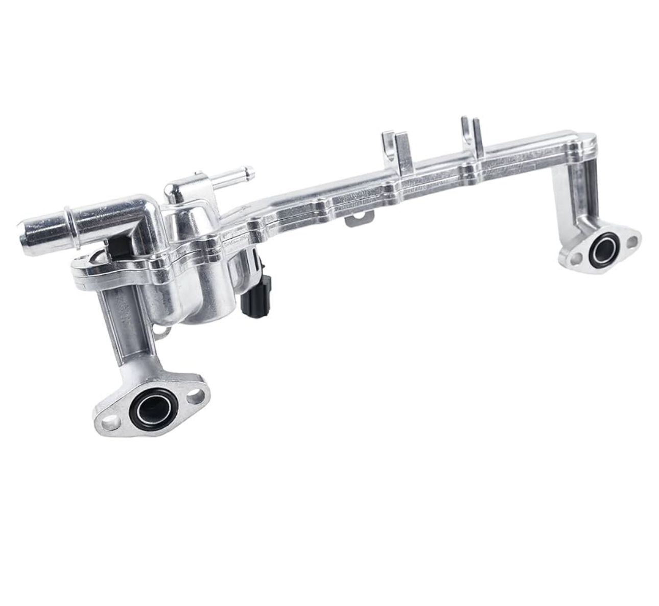

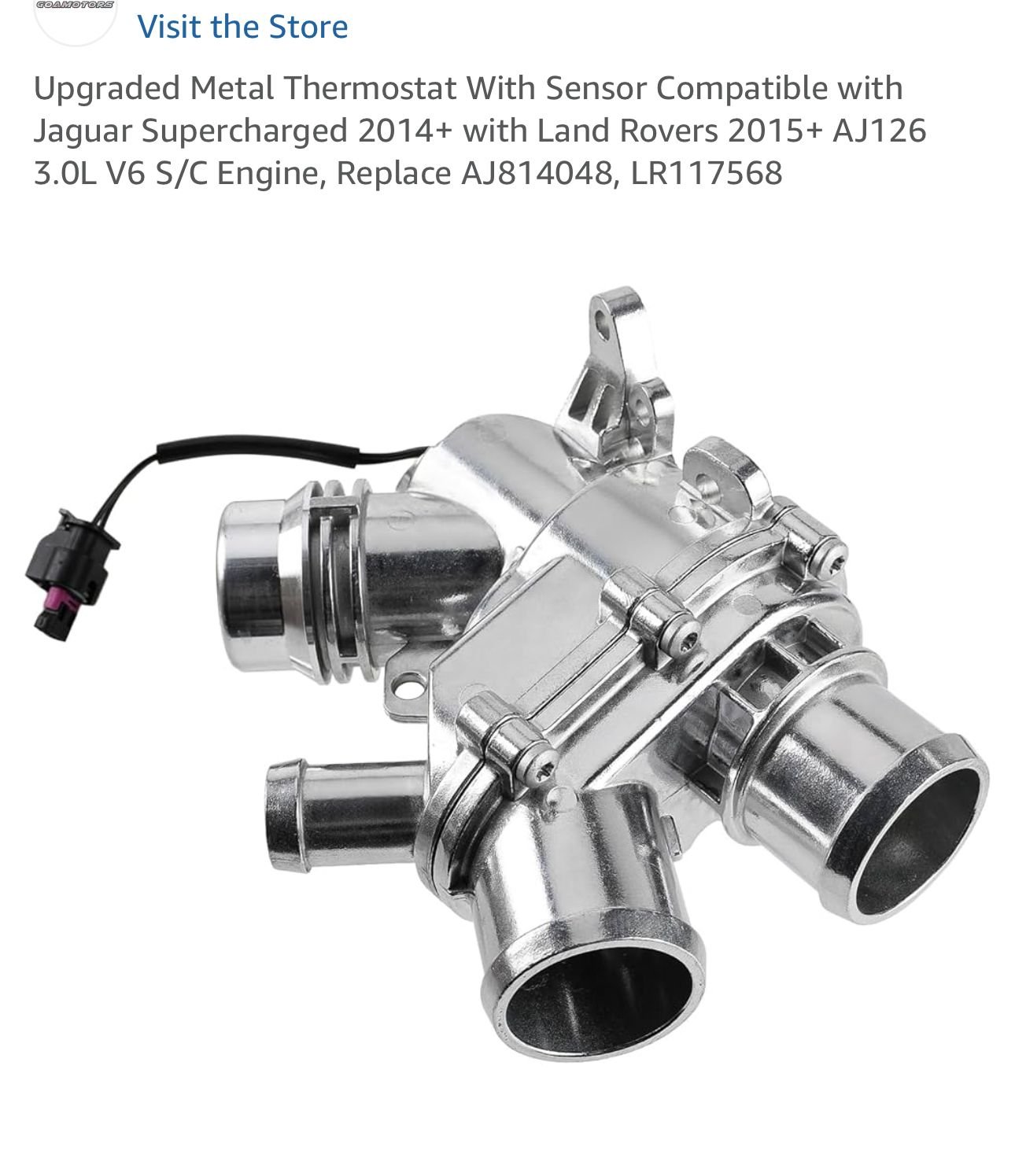

I just saw this today and everyone of us Jag guys should be jumping for joy!!
The aftermarket has finally redone the terrible plastic cooling tubes at the front of the engine. They look great and at $250 for both. I think a pretty fair price too.
Al. Cooling Pipes
Says for 2013 and up only? Not sure why the earlier 5.0L's are not included?
These are new and untried so caution is urged!
they are 120.00 for the set!!!
Al. Cooling Pipes
These have been out for some time now-
-front flange crossover for S/C

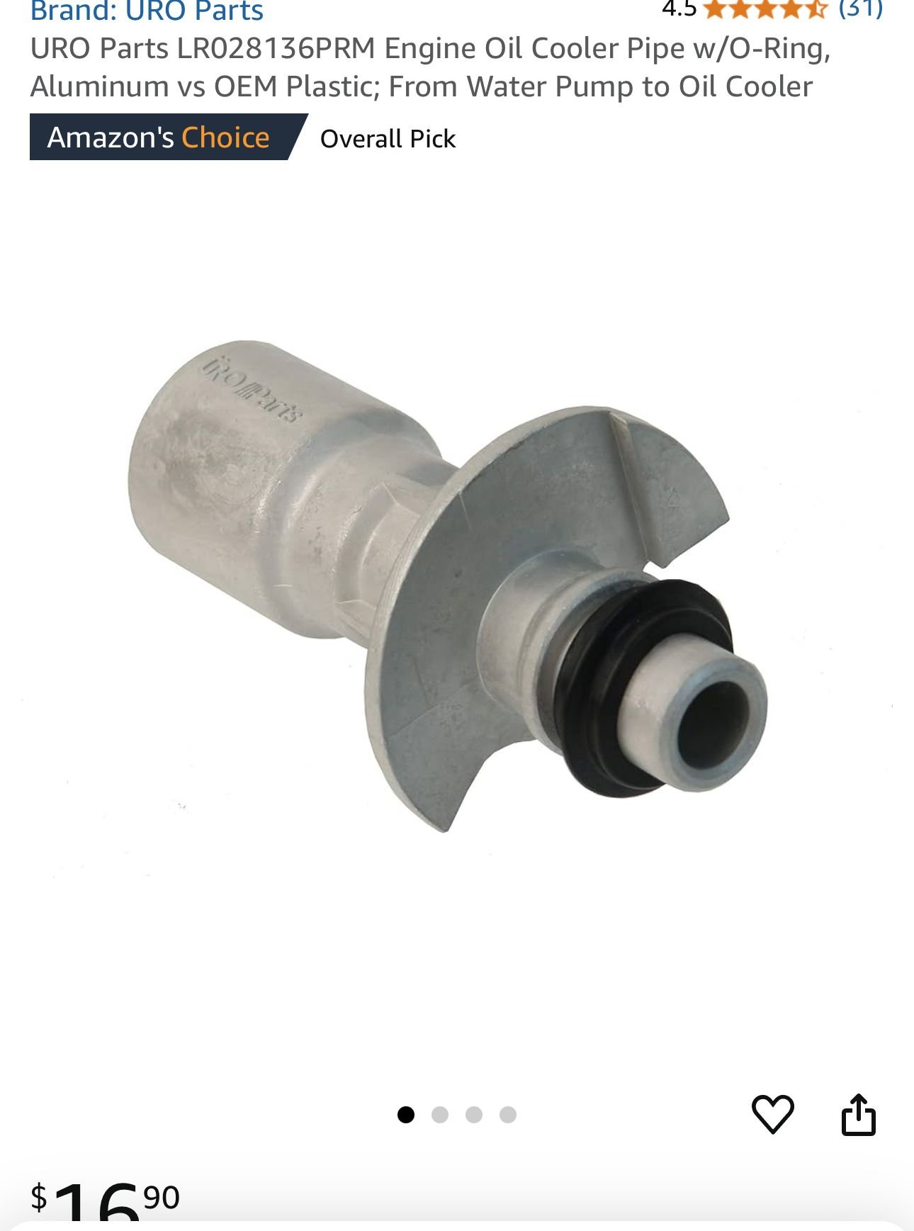

-oil cooler pipe- make sure to use 2 o-orings fitting into WP and 1 on Oil Cooler Block.
-Also Rear crossover heater pipe is. Is offered in Allowy with sensor.
-Purchase the GEBA made in Germany with an Alloy impeller as this will not be subject to failure from astringent coolants and chemicals.
- there is also a New Alloy elbow that is fitted between the thermostat pipe
you can also find these for the AJ133 5.0 engine
order 2 additional o-rings 2 for the fittment into the WP and 1 for the oil cooler brick
