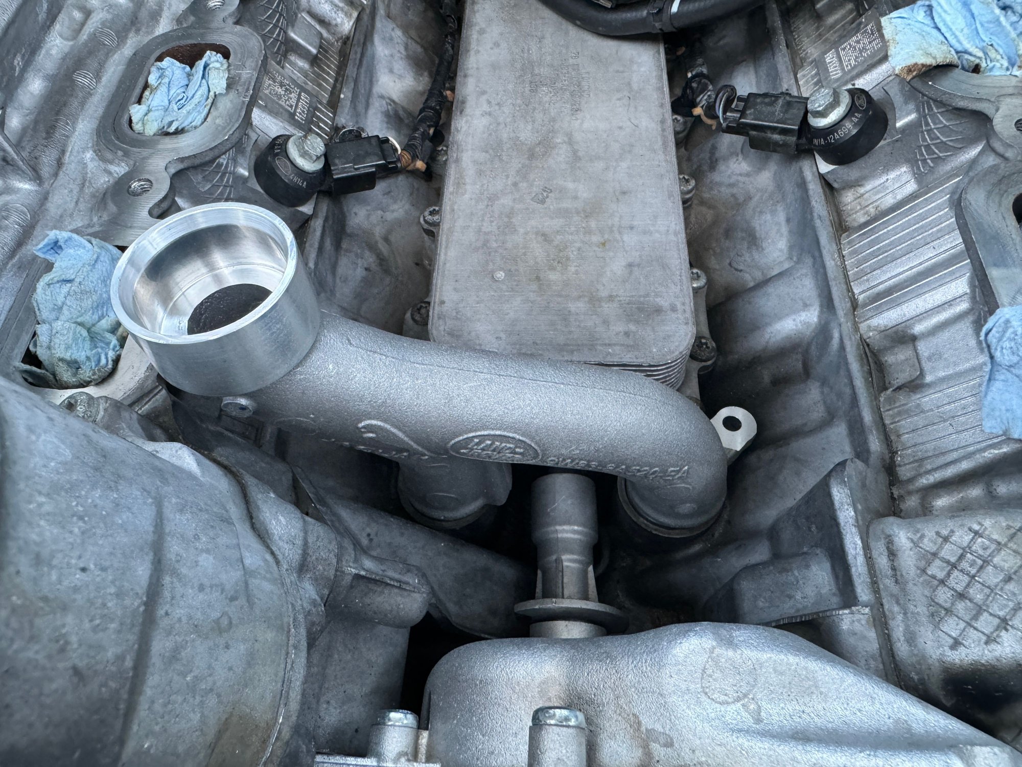

Y installed quite nicely, snug and perfectly seated flush and aligned. Note the diameter of the inlet's significantly larger than either the KO alloy versions or the genuine plastic versions making access to the notorious RH screw a bit more difficult in this state. Will note if there's any affect to accessing this screw with the supercharger in place.

Pardon my confusion. JLR originally made metal pipes, then replaced with plastic with seams that failed. Then they revised the plastic part to address the seams but they are still brittle plastic. And now they are back to metal again? Are these the original metal design or some new version 2.0? I guess I'm asking: Have we just come full circle (and JLR is producing the old metal pipes again) or is this a constant evolution where each part is superior to the part that came before it?

That’s correct! And they’re a completely new design.
What’s most puzzling to me is why for an engine no longer made or used???
