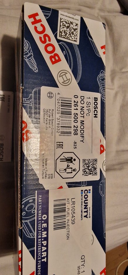

Thanks for the advice, can't find pics on here comparing fake & real injectors but confident mine are genuine Bosch as they are boxed, have instruction manual and even QR code that goes direct to Bosch website
when looking I found all sorts of prices so i used my general rule of not going too cheap, cheapest I found were £50 each.
I got my extractor tool on its own so will have a look at finding a resizer tool.seperately, thanks again for the heads up.

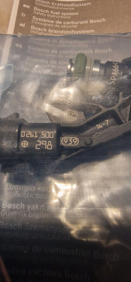

Looking good! I see the stylized "H" from Hella which has been missing from the counterfeit ones. Also that oval that does NOT touch the 939 inside is another good sign. The zero's are also square looking instead of more rounded on the fakes.
Plus that was good price.
Can you post a link to where you got them? Might help others as I was surprised when FCP sold counterfeit injectors to another forum member.
Here is how my counterfeit injector was marked. Note mine also came in proper Bosch boxes or so I thought!

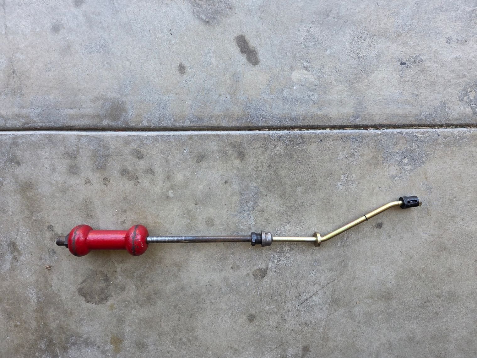

This is what I came up with after getting quite, lets just say unhappy. used an old dent puller to add some heft. reminded me of Tim Allen.
sorry the pic is so big

Did that too! Worked!
