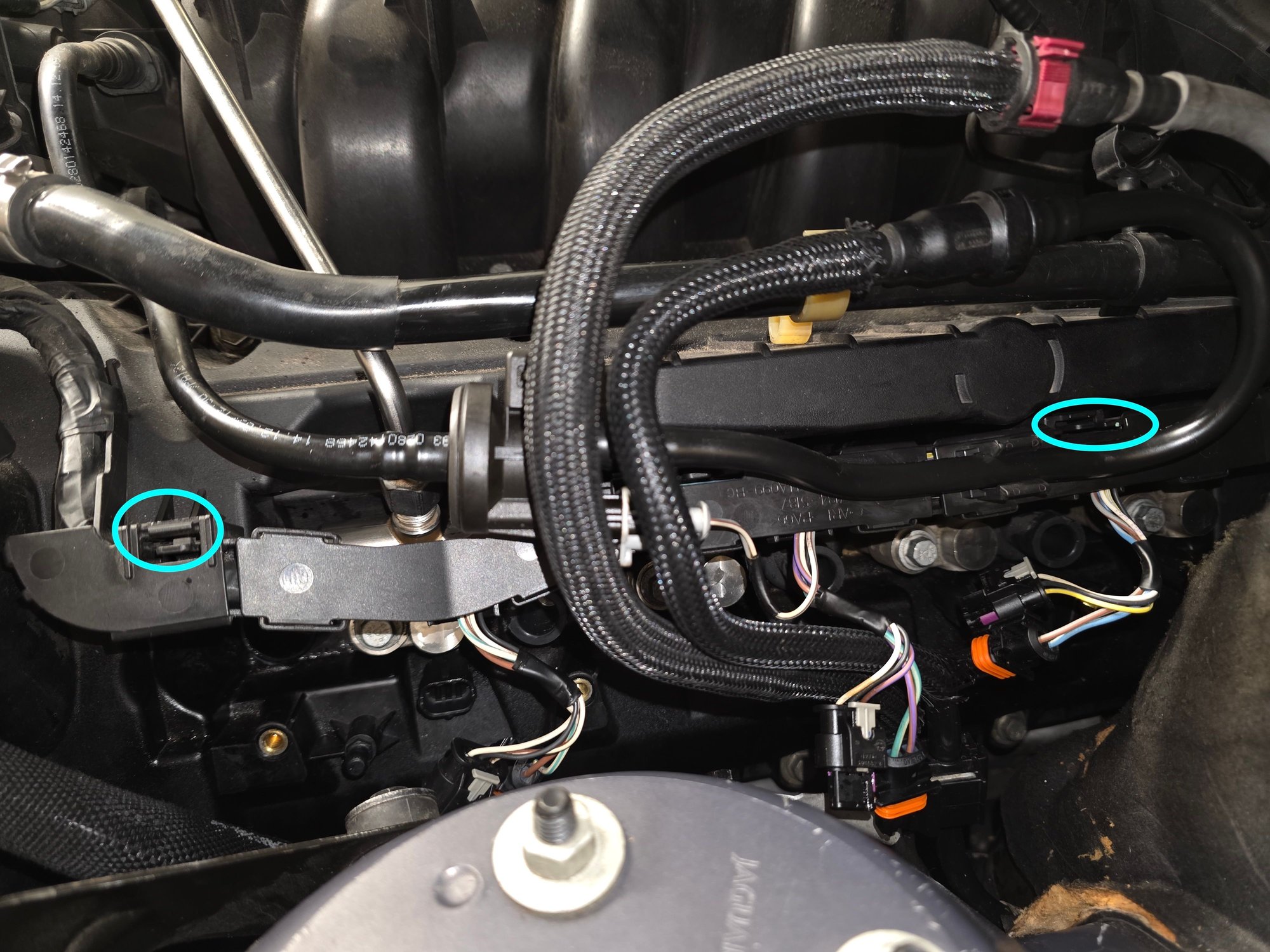

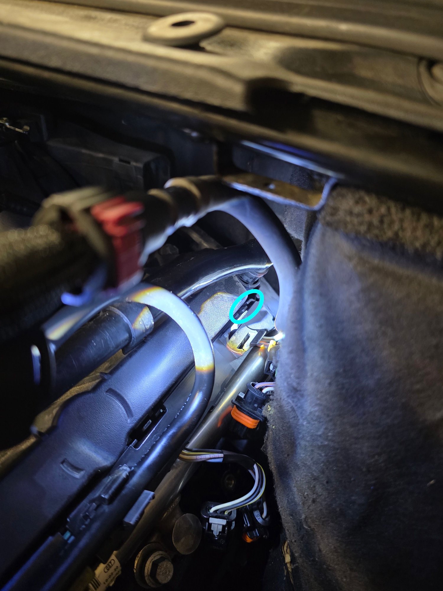

I found the release tab. It's right at the back, just before the end of the plastic harness cover. You need to press down on the 1/2" long release tab with a long flat head screw driver. It releases the harness, which will give another 1/2" of room, which was more than enough.
The fuel rail went easily into place, and tightening the bolts slid the rail down over the o-rings easily and smoothly.
Here are some pics of the tabs you need to release, to make fuel rail access and install easier
Front and middle tabs
Rear tab.
Rear tab.
