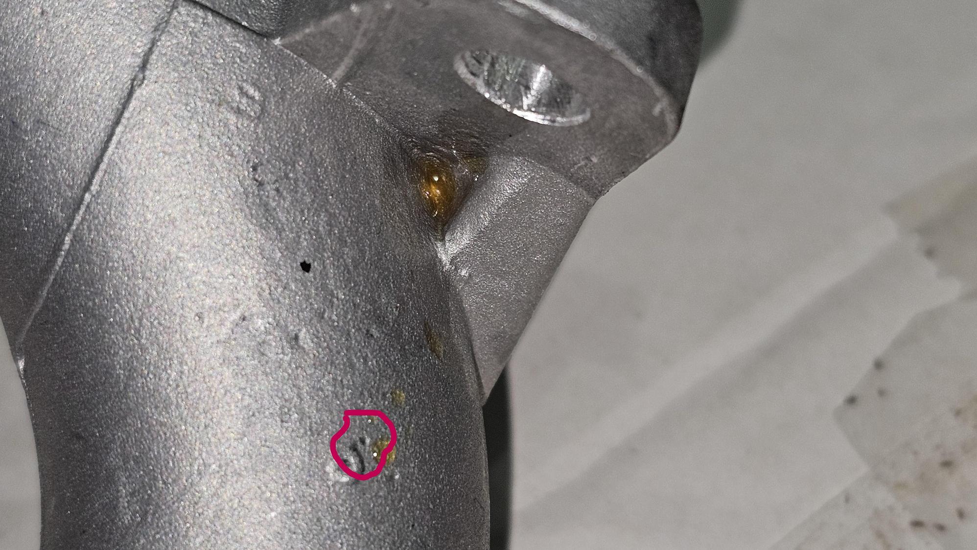

In preparing to do the 10 year service on my 2014 F Type V8 S, I purchased the Euro AMP Aluminum Y Pipes and Rear crossover pipes but not the whole kit. In talking it over with my very trusted independent mechanic, he does not like their quality of O-Rings, Gaskets or Water Pumps, and wanted to use Jaguar OEM Parts and after reading all the post and his own experience with O-Ring leaks and Euro AMP Parts I have to agree with him. The cast Aluminum Y Pipes are very soft Aluminum and can be easily damaged if you're not very careful. They are are also not chamfered or debbured in any way, so they have very sharp edges and burrs, which can cut O-Rings. I carefully chamfered and deburred the pipes before giving them to my mechanic.
After he did the install during the pressure test, which it failed. He saw coolant pooling up on the flange which he thought was a leaking O-Ring. So he pulled the pipe out and replaced the O-Ring, reinstalled it and it failed again! This time he crawled in there and watched it very closely while it was pressurized and saw it weeping out of a pinhole leak in the casting right above the flange. He pulled the Y Pipe out again and looked inside with a dental mirror and found a sizable pit right where it was leaking, so this was a BAD casting. So it looks like Euro AMP doesn't do any quality control testing on their parts.
My Mechanic also found that my water pump was starting to weep, not leak but just weep. So replaced that too.
Waiting to see if Euro AMP will refund me any of my cost? And cost me way more that the cost of this kit.
I just wanted to share my experience with the Euro AMP parts. If you get good ones, I'm sure they are better than Plastic but it was an expensive up grade for me because of faulty parts from Euro AMP.

A quick follow up, Euro AMP did give me a partial refund for the leaking Y Pipe and cost of the new Y Pipe that I had to buy but , that did not come close to covering cost of the additional man hours to find and replace their leaking Y Pipe. And as CarBuff2 says make sure you do a pressure test any time you do cooling system work, BEFORE you but the supercharger back on, I am so glad I had my trusted shop doing this work instead of me because I don't have a pressure testing kit and I would have just resembled the everything, only to fine the leak later and then I would have been REALLY PISSED.
Also the weeping water pump was the original 10 year old Jaguar OEM pump not a Euro AMP pump.
My mechanic is Sheik Bacchus at https://www.bacchusbritish.com/ in Dublin CA. They specialize in Jags and Land Rovers and have been in business for many years because they're very good and they don't try to pad your bill.
I can't work on my cars like I used to any more because of age and health reasons. But I trust Sheik enough to give him my car and tell him to do what ever it needs. He has been working on my car for many years and really knows my car and I am totally please with his work.
Question, Has any one actually been able to find and buy the Jaguar OEM Aluminum Y Pipes? Real ones not off E Bay or some other Chinese web site?

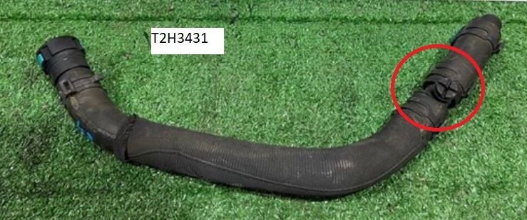

Thank you very much jahummer! I knew you would get back to this and figure it out. I had always planned on removing the SC anyway but was still interested in how it was done otherwise.
MaxD I think the brass screw your talking about goes to replace the factory plastic version on the passenger side of the engine on a heater hose. It's the heater air bleed screw.
Here it is on the heater hose.
Here it is on the passenger side of the engine. A bit hard to see because everything is black so it does not stand out.
I have the brass version on my bench and have not swapped it out yet.

Would this be the right shopping cart for the job if I want to go OEM? I the pipes are these "new" jaguar aluminium ones, but I am not sure if anybody actually put them into V6 F-type yet...
Old Feb 6, 2025 | 02:37 AM
  #580
MaxD's Avatar
Joined: Apr 2022
Posts: 57
Likes: 38
From: Europe
Understood!
I wonder where mine is...
It looks correct to me. In my opinion, I would use the aluminium version of the C2Z18658 if you're replacing the plastic pipes with aluminium (LR186859 & LR186917) - it's between the arms of the "Y" pipe.
