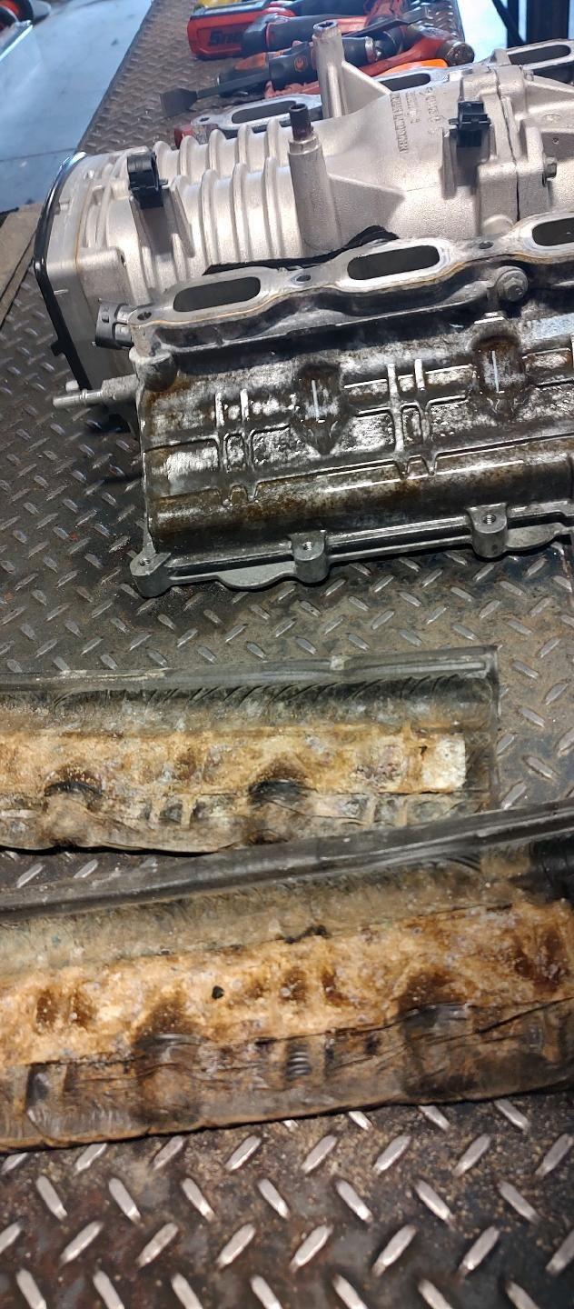

@J444G Use a steel polishing wheel on a drill and clean it all up?
Yes the mechanic says we will clean it with a brush probably or something.

Originally Posted by dmchao

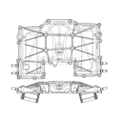

Agree, the foam traps a lot of moisture. Aluminum doesn't really corrode, alloy has a risk of having real corrosion, but this doesn't look meaningful in any way either. Best wishes on the cooling upgrades!
Coolant runs on both LH and RH sides of the charger cover - those front plastic bits are coolant connections. I think MAHLE makes these for OEMs and is the parts supplier to Eaton/JLR.
MAHLE Charge Air Cooler CI 409 000P FOR F-Type Daimler XJ F-Pace XF Genuine  Top | eBay
Yes, but my photo is the bottom part, where no coolant runs. I think that there was just a misconception that the black bit is a hole, while it is just a foil from the foam.

Yes, my mistake on not clarifying my post. I was saying only coolant runs in this portion and tried to find a good geometric drawing. What you showed is the "spacer/cover" portion of the assembly.

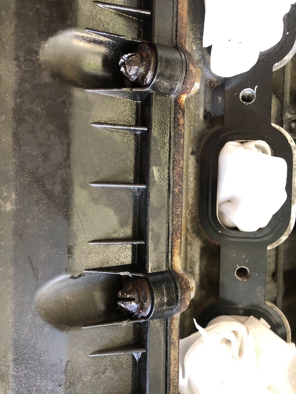

The black portion with bits on, is the plastic foam pad removed from the underside of the Eaton charger. I'll try to find a picture of a factory charger underside, but if you look at your vehicle you can see a black sheet poking out between the intake manifold and the valve covers.
EDIT: Here's a V6 charger underside. It probably looks similar under the foam. The listing shows 32k miles on it, so it looks newer.
This is what mine looked like when I took it out after 7 years and 21,500 miles.

@mvining Nice - came off intact!

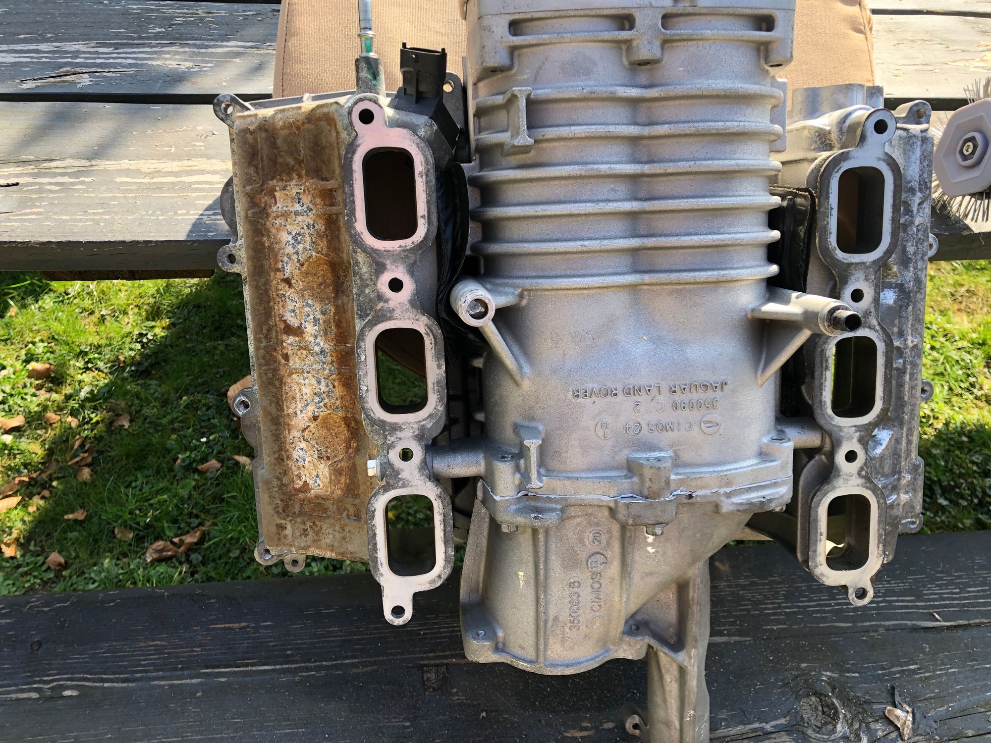

Originally Posted by Brian McCann
What in the hell? That must be from coolant eating the aluminum. There's no way that's just corrosion.
There is iron in their aluminum alloy.

Here’s mine after 10 years and 30k miles. Deleted the foam packs or at least what was left of it…. Garage queen btw…🤫

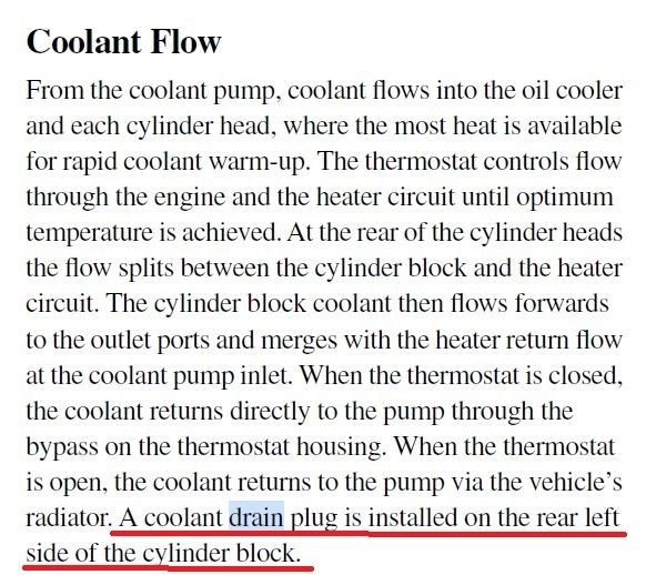

Someone asked up thread and there is a block drain.
This is from the Jaguar 5 litre V8-Technical Introduction manual.
I have never seen it and I think it's well hidden and difficult to get to.
Anyone got a picture?

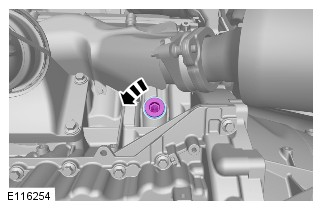

from p. 3983 of the Repair Manual…
https://www.dropbox.com/scl/fi/o6d1x...=4dvhe273&dl=0

That is a hidden bit!
I changed the drivers side cat which is shown in that picture and I never saw it. I will look closer next time the car is in the air.

That picture is deceiving. If you have a 5.0 AWD vehicle, there are actually 2 drain plugs. One in front on one side and one in back on the other side. BUT, you have to remove the A/C compressor to get to one, and you have to remove the mid differential to get to the other one.
It’s crazy how bad some of these look! Mine’s done 200K miles and looks brand newish, no corrosion at all and all shiny new. I did remove the foam a long time ago and it left behind brownish glue residue. I used solvent to clean it but it’s not perfect.
