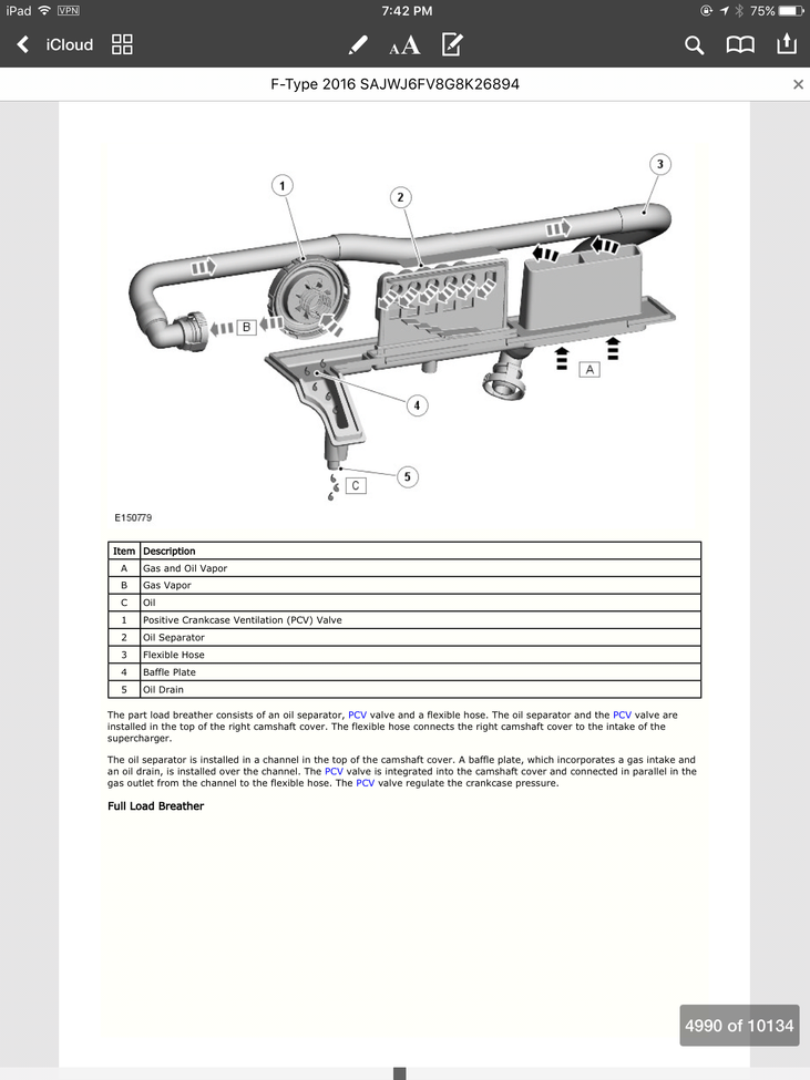

This is all good to know, thanks. Sounds like @Ksducati didn't turn the crank or clean his intake valves, so hopefully this is not a timing issue. So back to the detective game:
Some more possibilities - swap coil packs on the affected cylinders? I found some posts on other model forums where any coolant getting near the plugs or coil packs results in a misfire on that cylinder.
Can you guys check your PCV hoses on both sides for cracks or blockages? Pics are from @mwinner
I have put a page out to @jahummer who has done this job many times...
