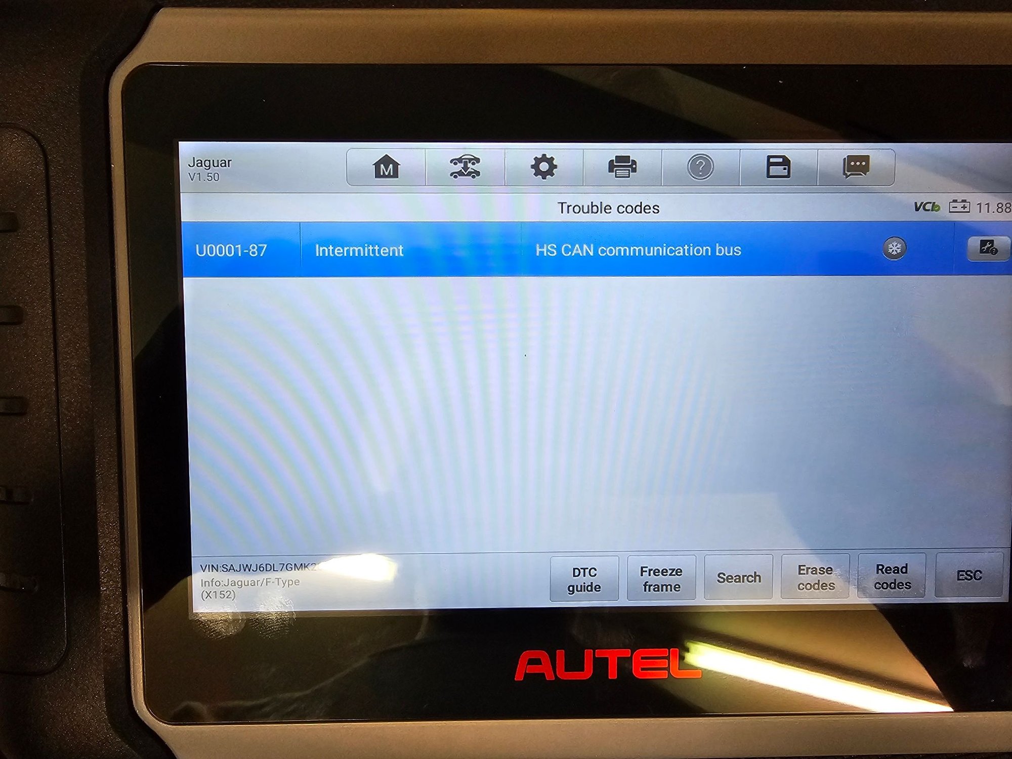

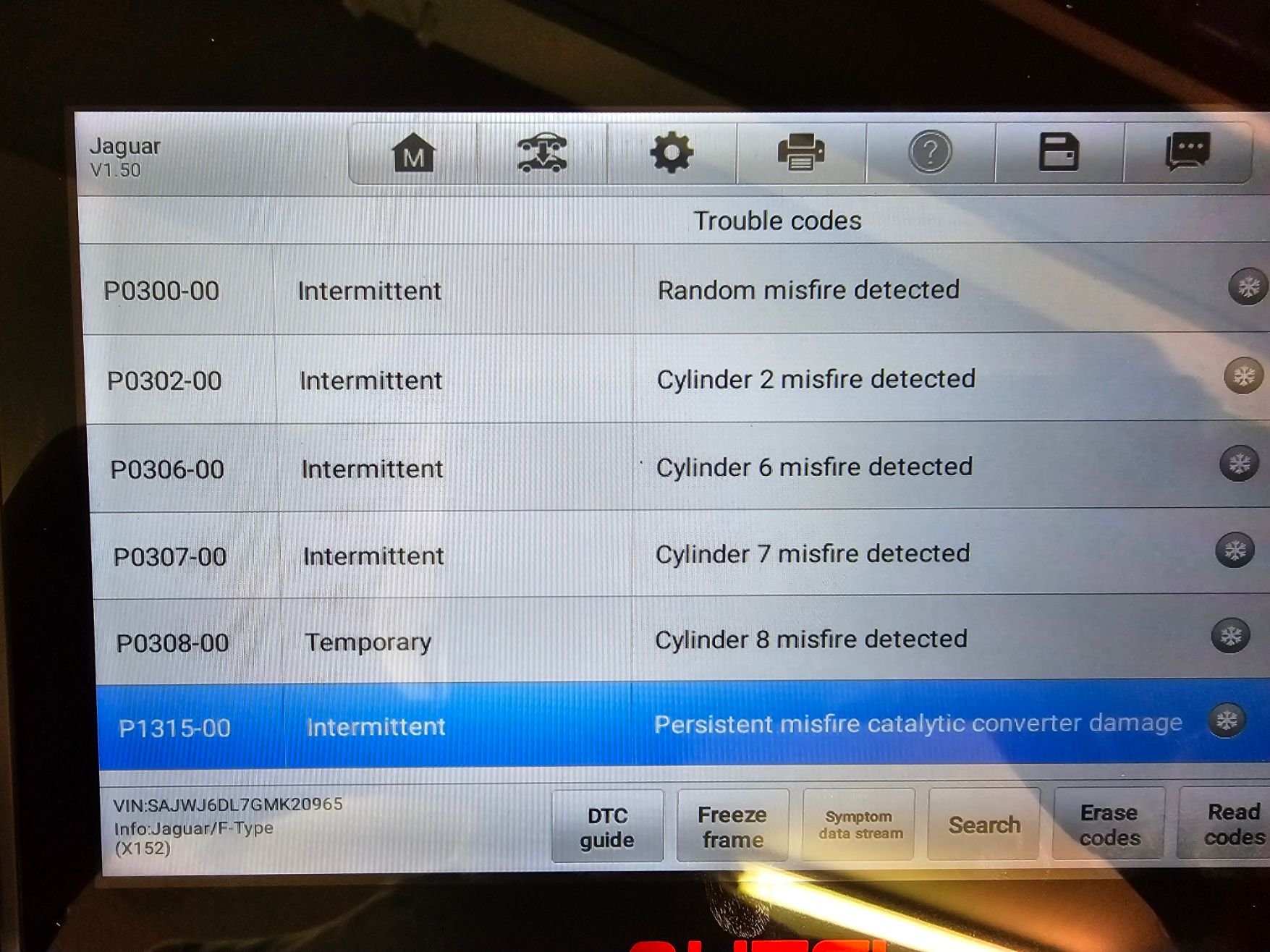

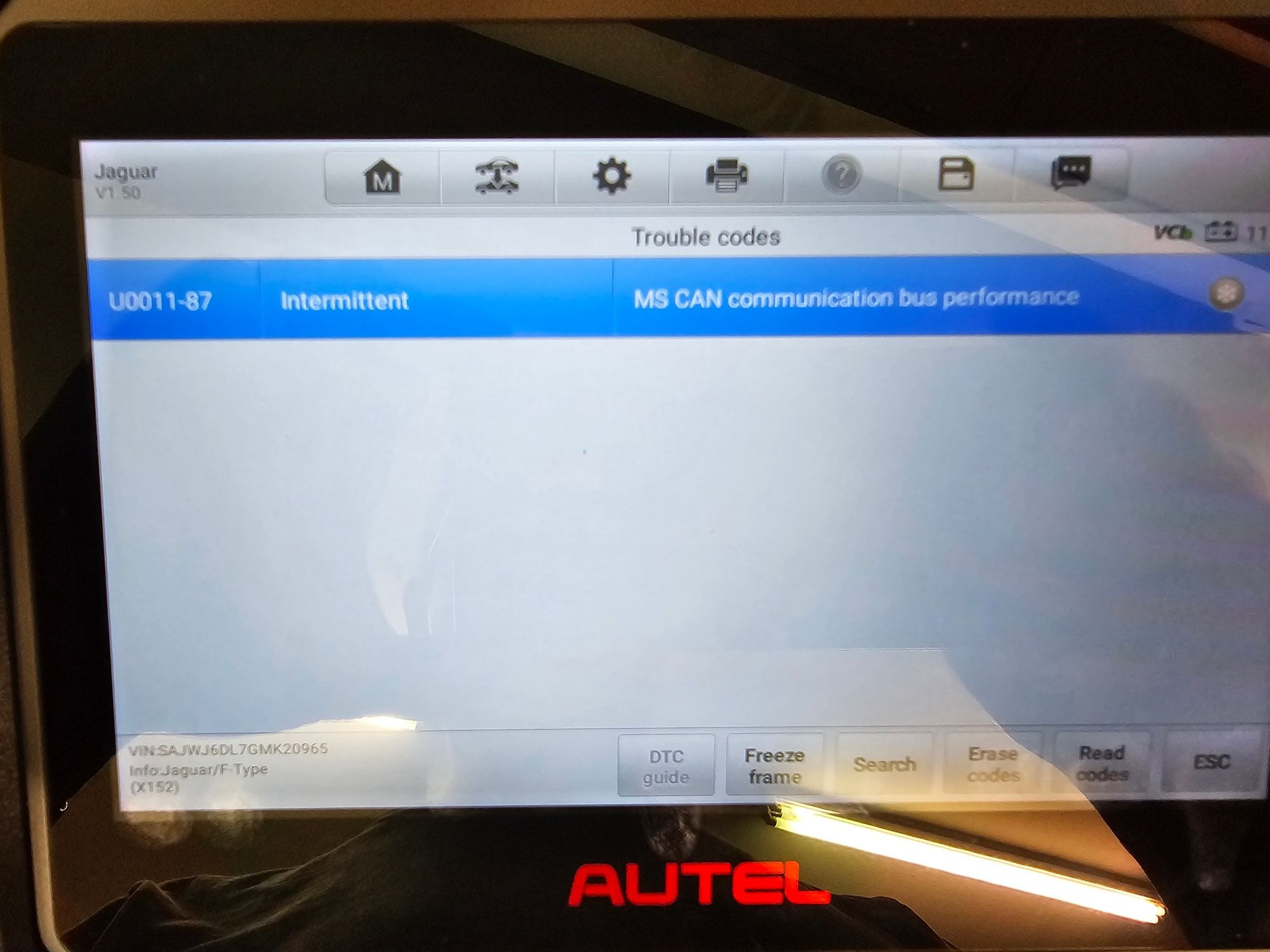

Can you post a list of your active codes after clearing?
Old Apr 6, 2025 | 08:20 PM
  #152
Trainingdragon's Avatar
Joined: Mar 2024
Posts: 178
Likes: 59
From: CA
Here's some pics of current codes. Sorry for the photo size I didn't realize they would be so large.
Old Apr 7, 2025 | 07:28 AM
  #153
JagCode3's Avatar
Joined: Jun 2024
Posts: 581
Likes: 284
From: SacTown
These exact misfire codes also happened to @skizot and cleared on their own:
https://www.jaguarforums.com/forum/f...7/#post2826353
The IPPC, BCM, TCCM, and canbus faults may be cleared by a BCM reset as @djyankees31 outlined:
https://www.jaguarforums.com/forum/f...7/#post2155159
https://www.jaguarforums.com/forum/f...9/#post2166102
Give that a try, wouldn't hurt.

The P1315 code noted catalytic converter "damage". Does that mean that it's already damaged or is it simply eluding to a problem??
