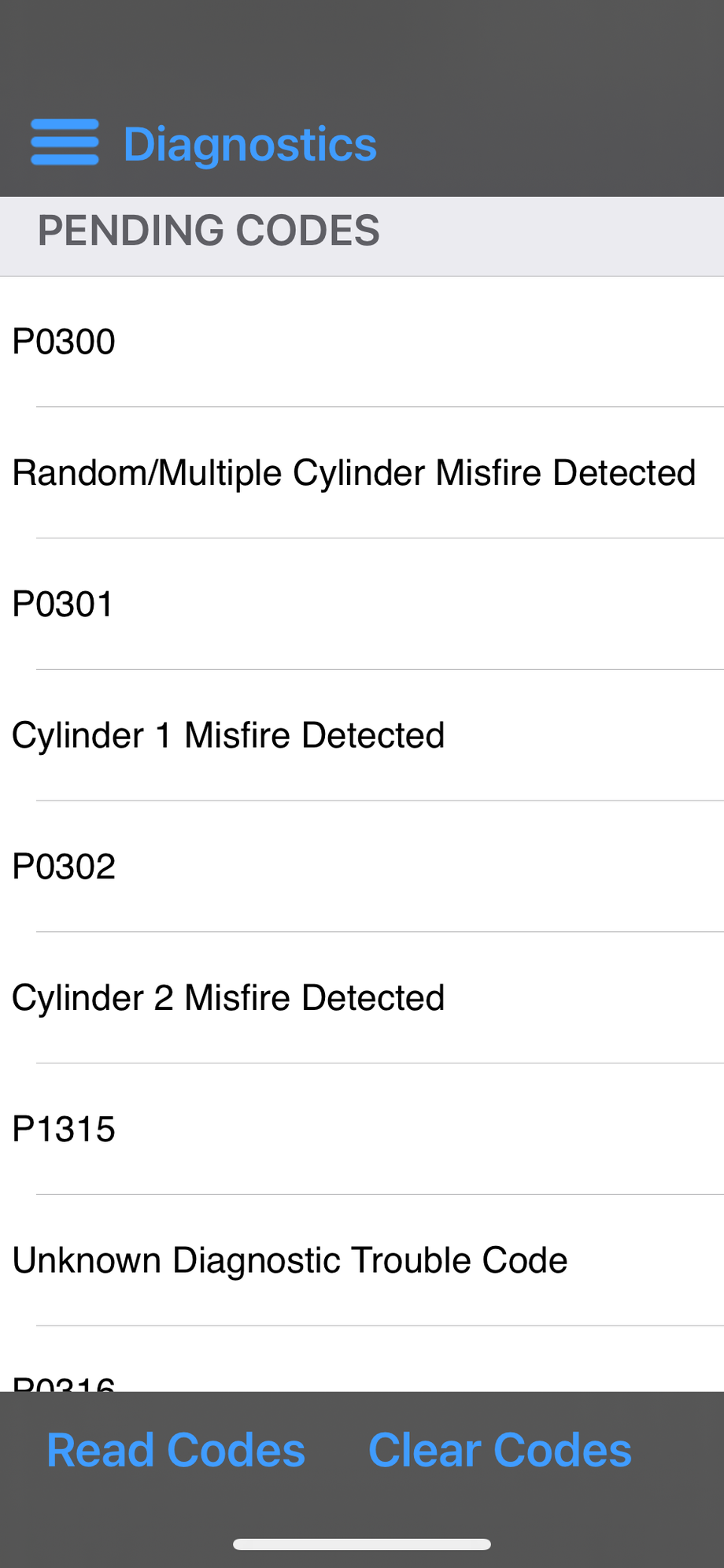

Hi guys!
So I'm also joining this thread, although I don't like it. In cooperation with a mechanic friend from JLR, we modernized the cooling system with aluminum pipes, including replacing small parts from the purchased kit. Including the supercharger clutch. At the same time, we dismantled the sympozer, including blinding the two relevant holes. At the same time, we sealed the right timing cover cover, from which engine oil was leaking and dripping onto the alternator.. And as a precaution, we replaced the PCV valve. When bleeding the new coolant, the engine ran normally. So I drove the car around the area to completely bleed the coolant. After half a kilometer, when I added almost full throttle, "something" went wrong and the engine stopped running smoothly, started sputtering and a message popped up - Engine fault. So I slowly drove home and used the Dashcommand OBD reader. Code P0301 and P0302 Misfire 1st and 2nd cylinders. The next day, the mechanic came with a "big" diagnostic and confirmed the errors and the fact that they cannot be erased. The diagnostic does not report any other errors. During a visual inspection, he immediately found the first defect - a loose ground cable on the right timing chain cover, which was dismantled during the leak. He tightened it, but even after replacing the spark plugs and inductors, the error cannot be erased. The engine still stutters. Cylinders no. 1 and 2 (both on the right side of the car) do not fire. My wife and I wanted to go to Sardinia in a few weeks, but it may not be in the F-type. I also have our veteran XK8 in reserve, but it was not planned. Many thanks for any advice. I have been awake for the third night thinking about it... I have read this entire thread and (so far) I am convinced that I did not forget the rag in the SC.. Thanks to everyone!

Not sure if you're asking for input to a misfire problem still not solved.
If so, if appears you've checked/replaced ignition parts on cyls #1&2 with the problem still existing?
Remember that combustion occurs by a combination of - Air - Fuel - Ignition. All 3 need to be present. If you're sure about the ignition part, there is still the air part and the FUEL part. Sometimes Misfires are caused by lack (or too much) fuel.

Hi.
Thanks for the response.
Yes, I gradually removed the ignition coil and spark plug from the third cylinder, which works properly, and put them alternately in cylinders no. 1 and no. 2. I put the ignition coil and spark plug from the first and then from the second cylinder on cylinder no. 3. Unfortunately, the error did not move, the third cylinder runs like a kitten with all the coils and spark plugs that I used. The error still remains on the 1st and 2nd cylinders. I have already installed the original PCV valve back to be sure. Again, no change. Misfire 1+2 cylinder. All water and vacuum hoses that I can see are connected. I have already removed the air filter pipes to have better access to the engine breast. I have not found anything loose or unconnected there yet. I checked all the fuses under the dashboard on the right side in the cabin and in the engine compartment on the left by beeping with a multimeter. I still have to check the fuses on the left side under the steering wheel (LHD). I'm starting to get pressed for time, so I'm considering removing the supercharger again... What if there's a rag in there? The mechanic who did it doesn't have time for me anymore. And he's a friend and he did it for a very friendly, almost symbolic amount of money, so I have nothing to complain about. He promised to stop by again, but I'm starting to get the feeling that he doesn't know what to do either. Thanks for any inspiration.Edit: I don't expect a rag or towel under the SC, I had the holes taped over with paper tape.

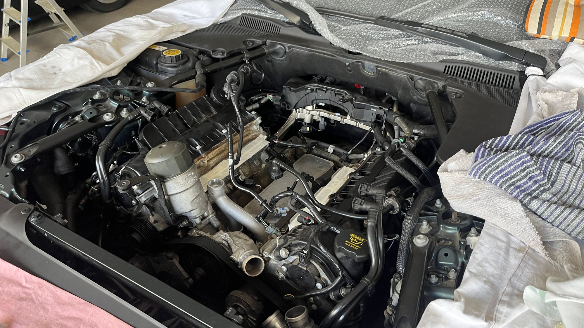

I dismantled the SC again and checked all the connections, connectors and cables. As someone already wrote here, the second time around, dismantling the SC and pipes seems much easier!
All pipes ok, all connections fine!

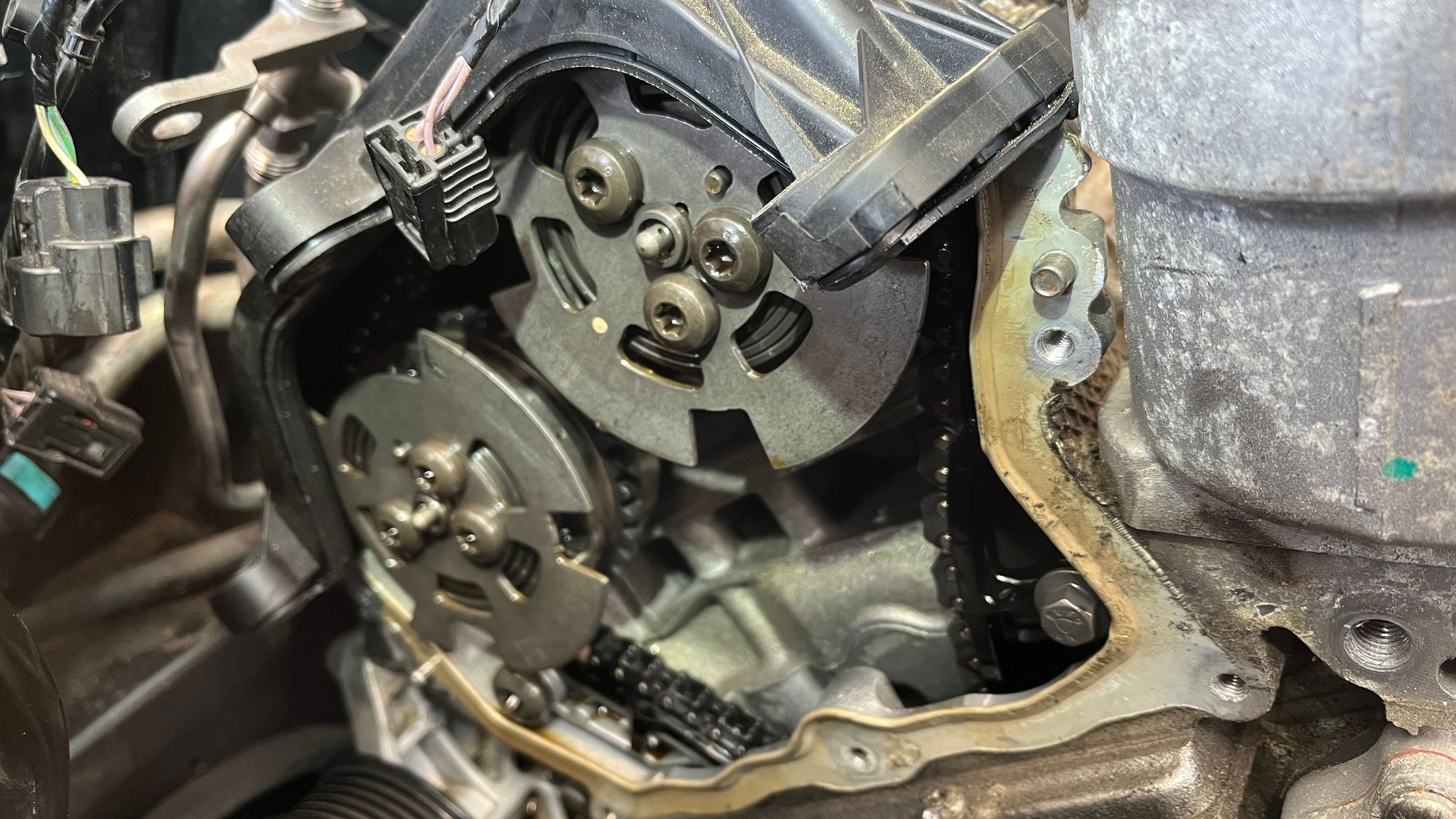

So, by the method of elimination, I came to the conclusion that I had to start all over again... Look for the cause of the problem in the only error that occurred during the update.
And that was the loose ground screw on the right timing cover!

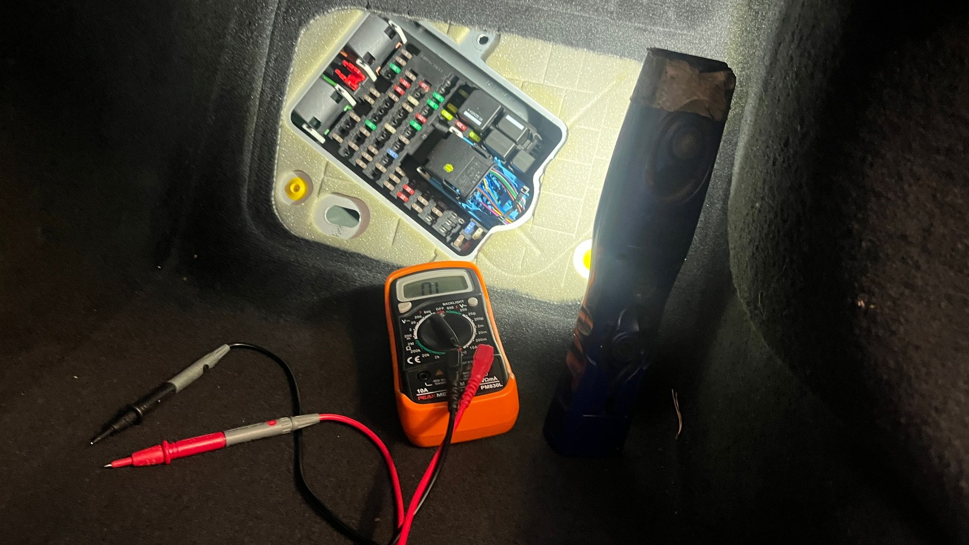

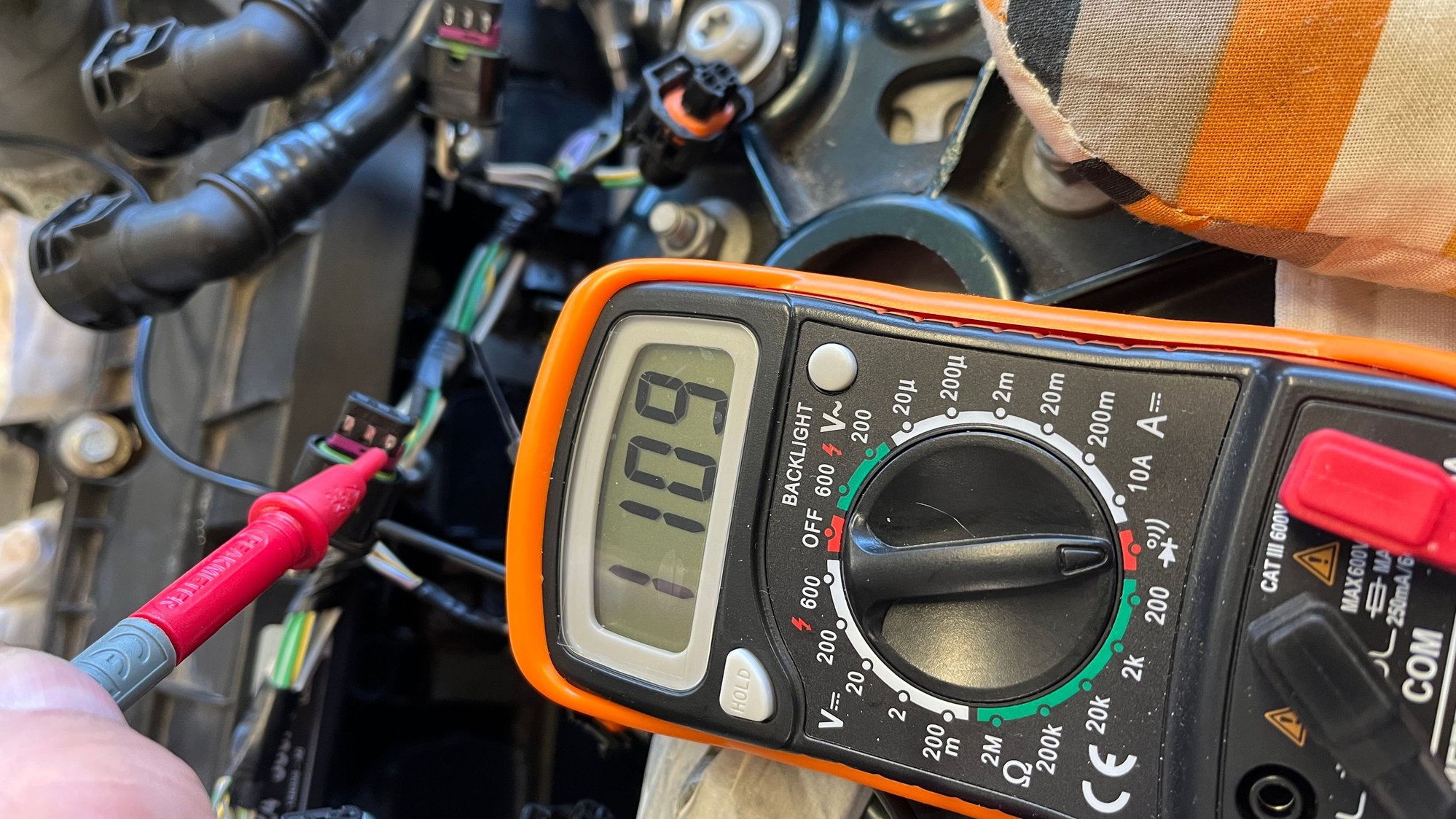

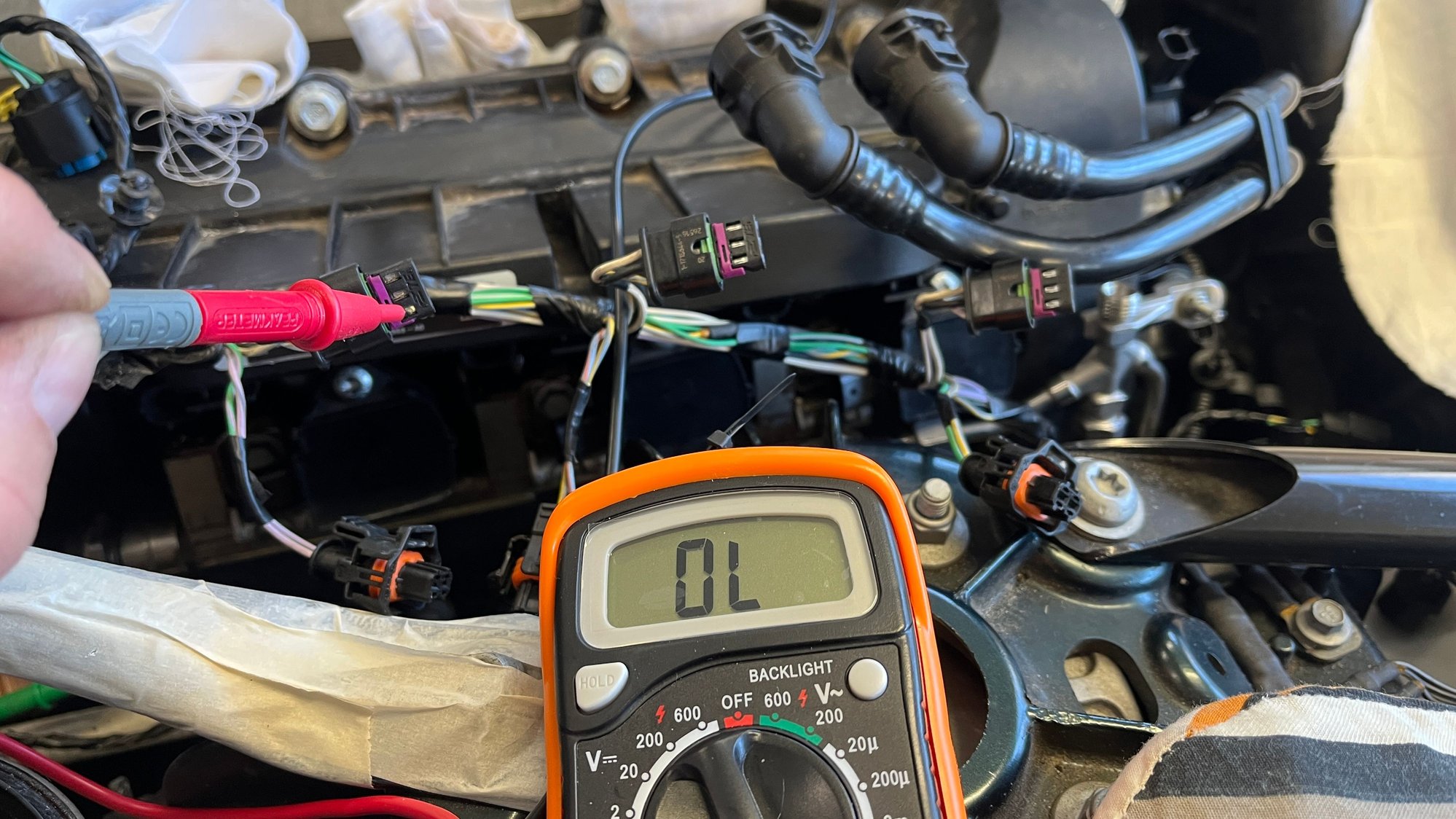

Here I came to the conclusion that it was an electrical problem. I hate those the most! I measured the resistances or beeps. All injectors had the same value of 1.5 Ohm. That won't do! On both non-functional cylinders, however, I measured a different value on the three-pin connector, on the weakest wire, by comparative measurement, than on the functional, third cylinder! Attention! Something is happening!
The working cylinder (cylinder #3) has an "OL" reading, the non-working cylinders (1 and 2) have a reading of 1200! (With the battery disconnected of course) This indicates that the problem is not a broken wire, but rather 1. either an unwanted passage or 2. a damaged switching transistor in the control unit (PCM). This thin wire is a signal wire (it switches the coil to ground). A value of +/- 1200 probably means that there is something in this circuit that should not be there (e.g. internal damage to the unit after an electrical shock from a shorted ground). Why would it be in the unit? When the ground was open on the solenoid, the current could have tried to find its way back through other circuits. Since the coil signal wires go directly to the processor/transistors in the unit (that's what the AI ​​told me), this backfire could have "heated" them. This would explain why cylinders 1 and 2 are not working, even though the coils and spark plugs are ok. What to do now? (Key test) I need to find out if the "1200" is coming from the harness (short to another wire) or from the control unit.
So I disconnected the main connector from the control unit (PCM)
I measured the weak wires on the coil connectors (photo) again (with the unit disconnected):
Now the multimeter in the beep function writes the value OL everywhere!
So the wires in the harness are fine and the problem is unfortunately inside the PCM control unit (burned out outputs for cylinders 1 and 2 after fluctuations in the ground voltage).

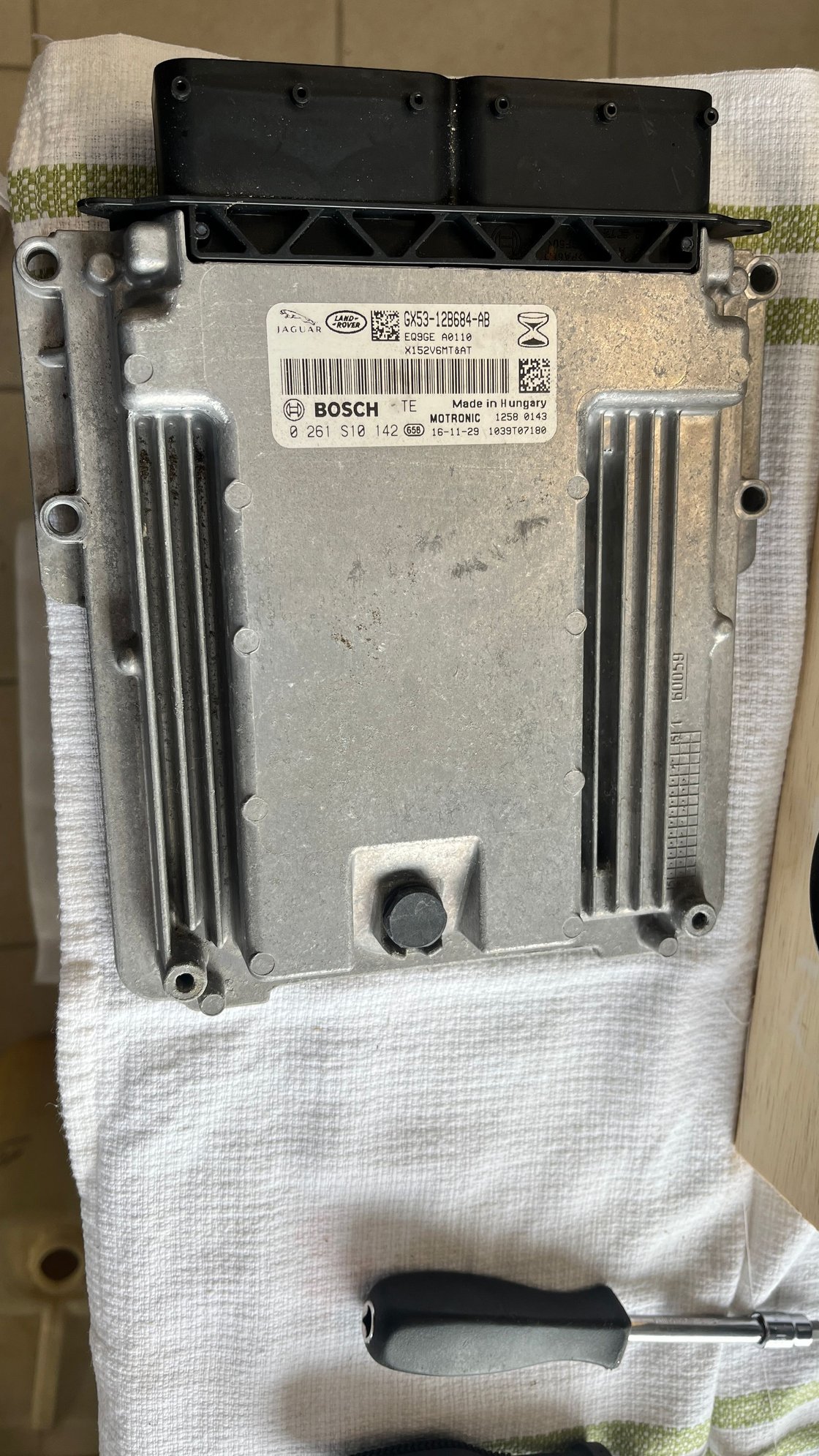

And here the story ends for now! I gave the conclusion about my possible finding to the mechanic. The next day he arrived, removed the PCM control unit (it is under the fuse box on the left side of the engine compartment), and took it to a specialist who will measure the unit and, if possible, repair it. Otherwise they'll buy me a new one! Fair deal! That's the end of the story for now.
In the meantime, I'll drill a hole in the block for water leakage, clean the engine block under the compressor and maybe reassemble the entire engine. Then I'll wait for a repaired or new PCM control unit.

The other cylinders showed the same values ​​as the working cylinder three. Each side of the engine has several ground points. However, only the ground on the right side of cylinders one and two was free. Cylinder three has another ground on the back of the engine. This afternoon, the mechanic brought the repaired PCM unit, where the specialist replaced the integrated circuit that was faulty. (Number 2.) The car started on all six cylinders, but after a while the engine started to stutter slightly again. We have currently read the error of the second cylinder... So slight progress, cylinder one is ok so far. The PCM unit is on its way to the repair shop again. We will see what happens in the next step.
