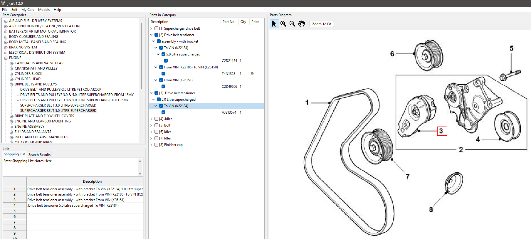

Here are the options from what I can tell:
The specific part number depends on the VIN. Early years list just the tensioner, while later VINs list the tensioner assembly. There have also been changes in SC belt length over the years (with different VIN breakpoints from the tensioner changes), so the situation seems rather convoluted.

I was wondering what the Jpart app you’re running is, now I know…
https://www.jaguarforums.com/forum/g...-255587/page2/
I downloaded the JEPC .rar a few years ago to my Dropbox from your link, so theoretically it’s available from there.
https://www.dropbox.com/scl/fi/h24wk...=65rwod3g&dl=0

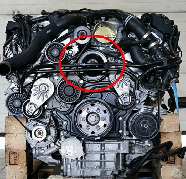

Thanks guys. I'll be returning the new part back to Euroamp as they acknowledged the error and don't have the correct part. With that in mind I tried cleaning up the original and I seem to be able to get enough bite with the 3/8" insert to get it to rotate what I believe is full rotation. With that in mind it still seems like somethings not right as I have done this 5 times already and this is the first time I'm having trouble. I'm questioning if I have an issue with the belt route now. Does anyone have a diagram for the supercharger belt routing? Thanks

Disregard the big red circle. This should show the proper SC belt routing for all model years.

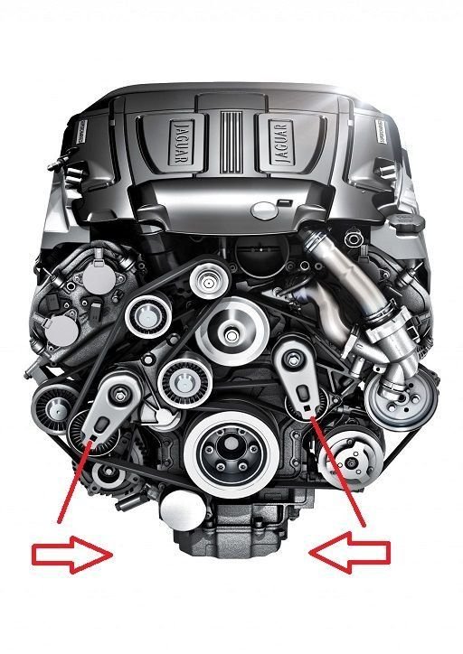

Here is another image with tensioner travel highlighted.

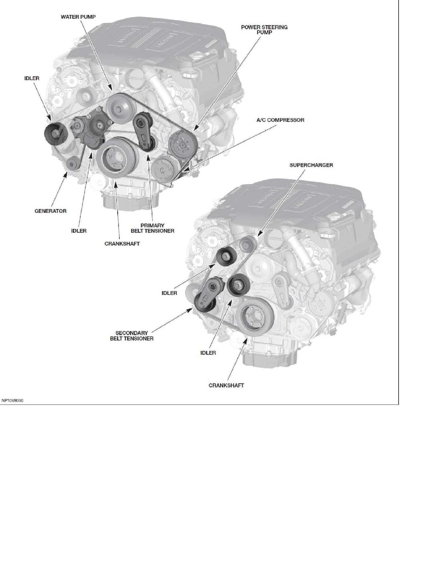

I think this is a better display of the belts. This is what I used when I changed mine.

yes that's a really good diagram. Thanks guys. I was hoping I just had it wrong but unfortunately I've got it right and I just need to keep playing with it. Maybe the belt got shorter??? LOL
