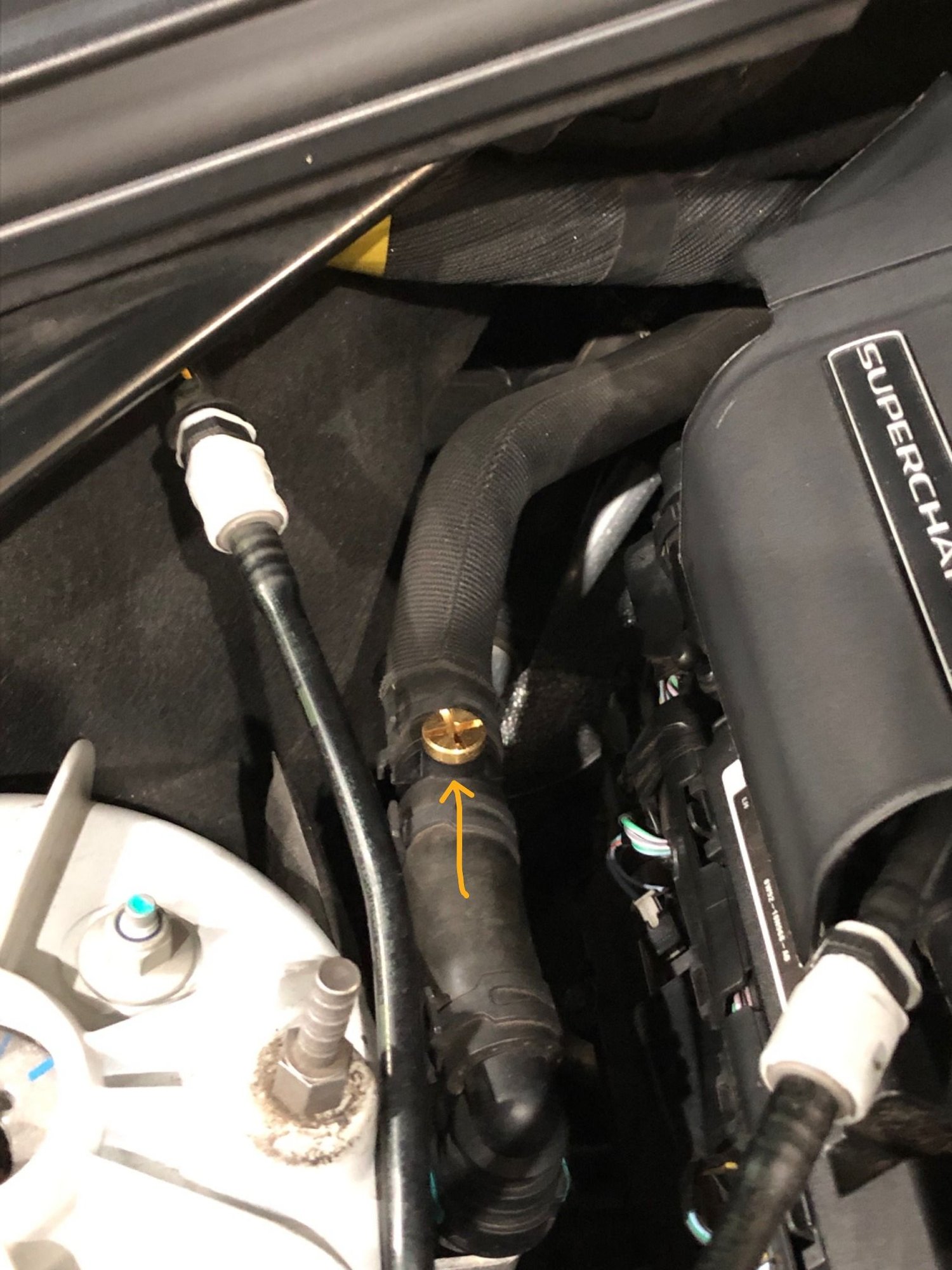

On air in the system, do you not have a bleed screw on the highest coolant pipe? I did on my F-Pace (albeit the V6). This bleed screw is on the pipe going to the heater core. With the system up to operating temp, opening that screw slightly so you see coolant dribble out usually has the air in the system that escapes first. My refill and startup after the pipe replacements went without a hitch. I've hears some say they needed to open/close the bleed screw a couple of times.

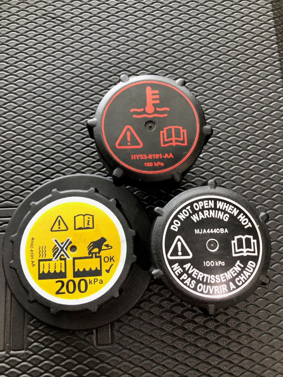

One more thing about these pressure relief caps. They are matched to the system requirements so if ever replaced, they should remain the same kPa
In this pic, the yellow caps is from my F-Pace V6. The red one from my Aston DB11 V12; the white one was a cap I replaced years ago, I believe from either on of my XJs or maybe my XK8

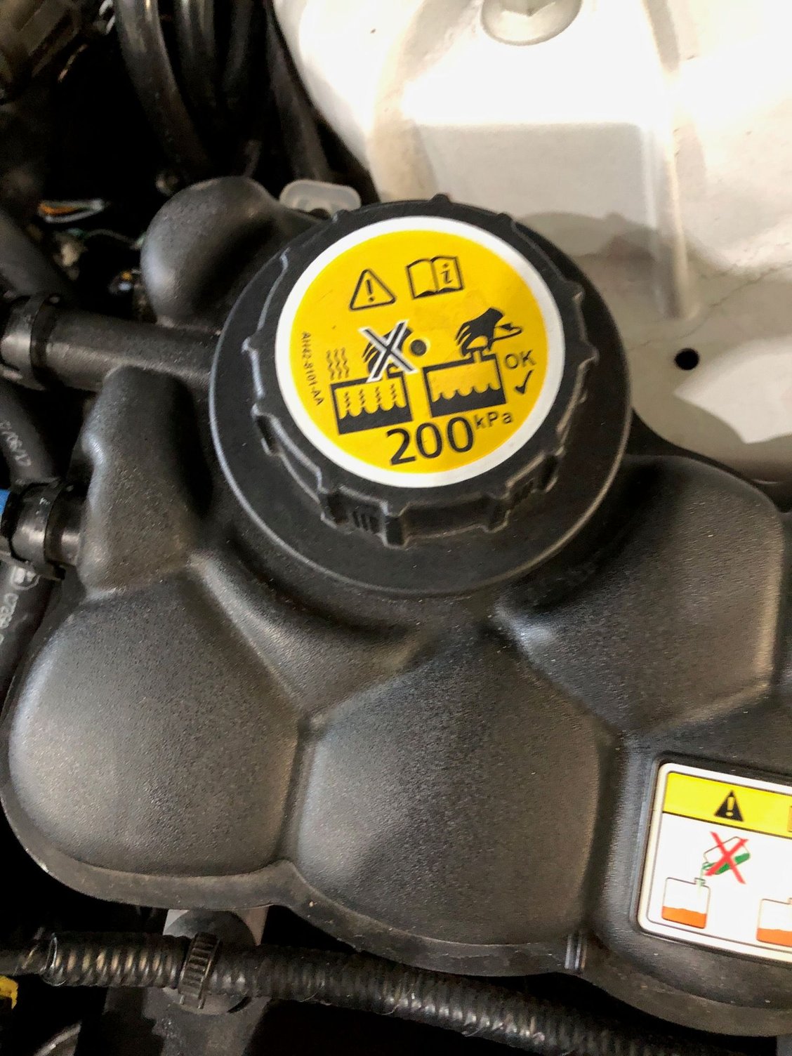

That said, all the cars I have ever owned (including the two mid-engined ones, with the engine at the back and the radiator at the front, and coolant lines that run low on the floor) will purge air within 5 - 10 drive cycles. It helps to remove air if you hold the RPMs a bit high (say, 4000 RPM) for a continuous minute or two, for the next couple drives.
The F-Type's header tank / reservoir where the '200 KPA radiator cap' is, is the highest point. You can either remove the cap (cold) to monitor the coolant, or look carefully at the front side of the reservoir.
Our bleeder looks like the one you pictured in post 383, but it is black plastic. IMO no need to fuss with it.
