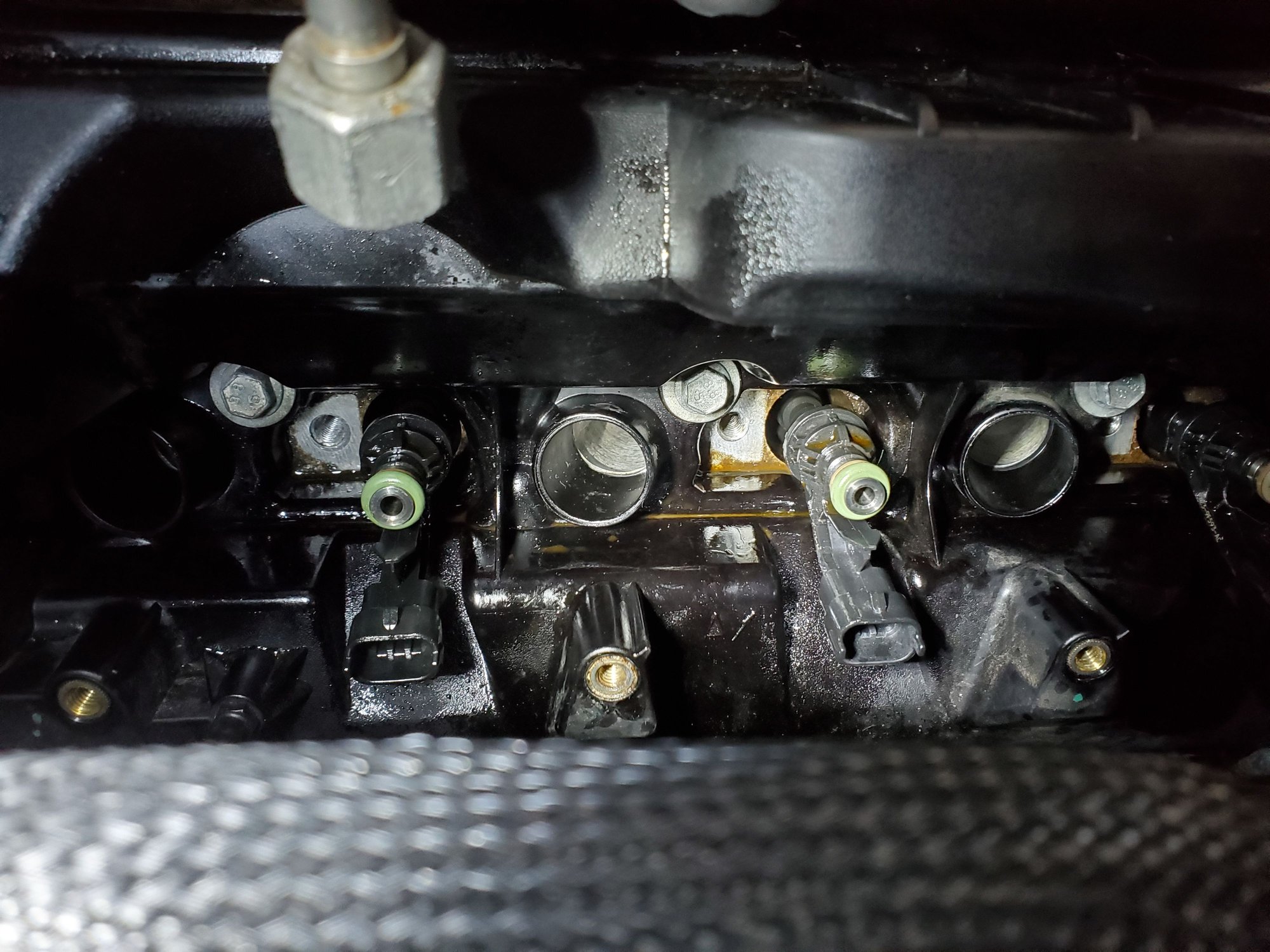

Swapped coils and same issue-no changes. The coolant around edge of injectors was from removing those darn upper inlet hoses to supercharger lid (hopefully a fairly accurate description? there's two on each side of motor)
I used a pile of q tips to carefully absorb most coolant around the two injectors..sprayed with pb blaster.. will let it sit until tomorrow when injector removal tool arrives. UNFORTUNATELY they seem to be fairly in there while wiggling them a bit so I REALLY hope they aren't brutally seized. I'll go for the new injectors route and update you guys. Had it on the "preventative" to do list anyways. Like to tackle these things on my own terms and time but looks like it's a decent next step. Maaaan fingers crossed.

@Ksducati Damn, I was really hoping it was just some wet coils causing these problems.
Can you smoke test your intake and other vacuum/positive pressure lines?
I don't think any fluid could have gotten past your injectors - that's a tight seal. The "seizing" process takes a while to happen, months at least. It would be too much of a coincidence if it happened with the work you did, especially multiple injectors. I am just putting myself in your and @Trainingdragon's position because I have to do this job soon myself.
If you do go the injector route, here is how to spot a fake:
https://www.jaguarforums.com/forum/f...7/#post2826762

I've never done the smoke test but have heard about it and will look into it. I figured fluid couldn't get past the injectors, that's good. I did clean up the area and sprayed em down with pb so hopefully today the injector puller arrives and hopefully the injectors actually come out-new ones should arrive Monday so will have to wait of course(if I even get them out).
