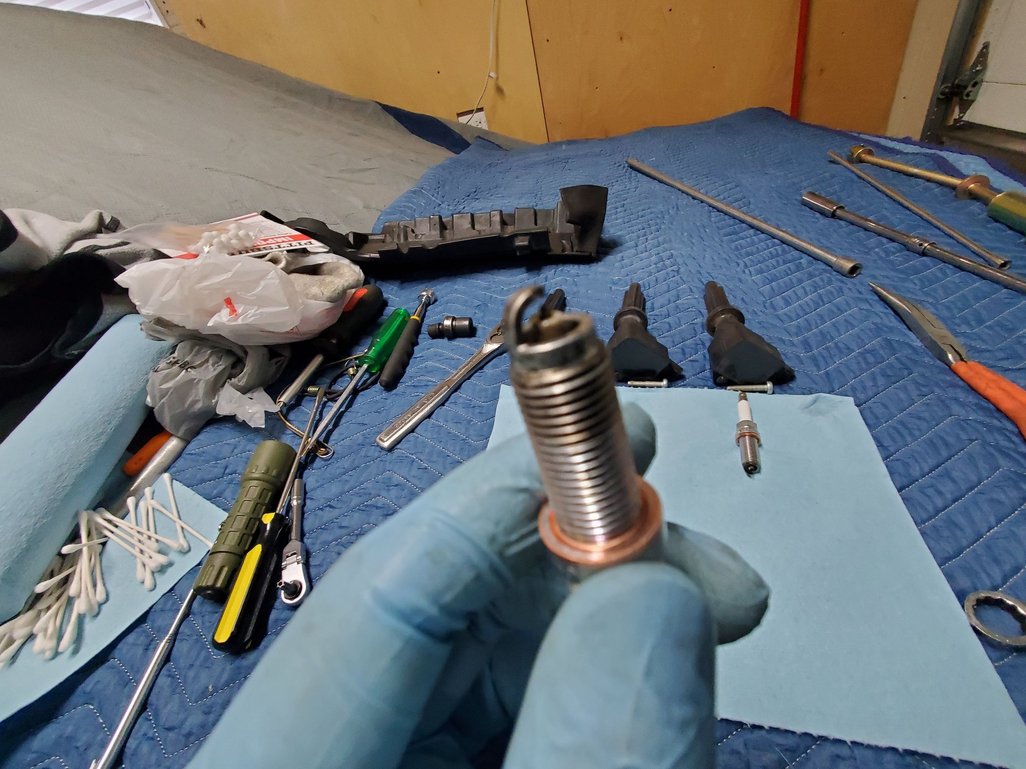

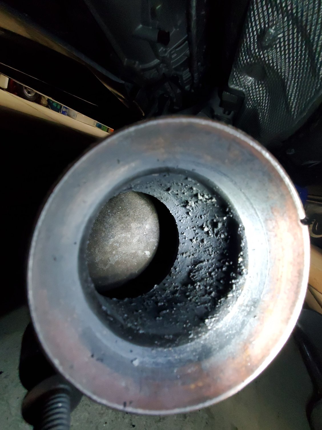

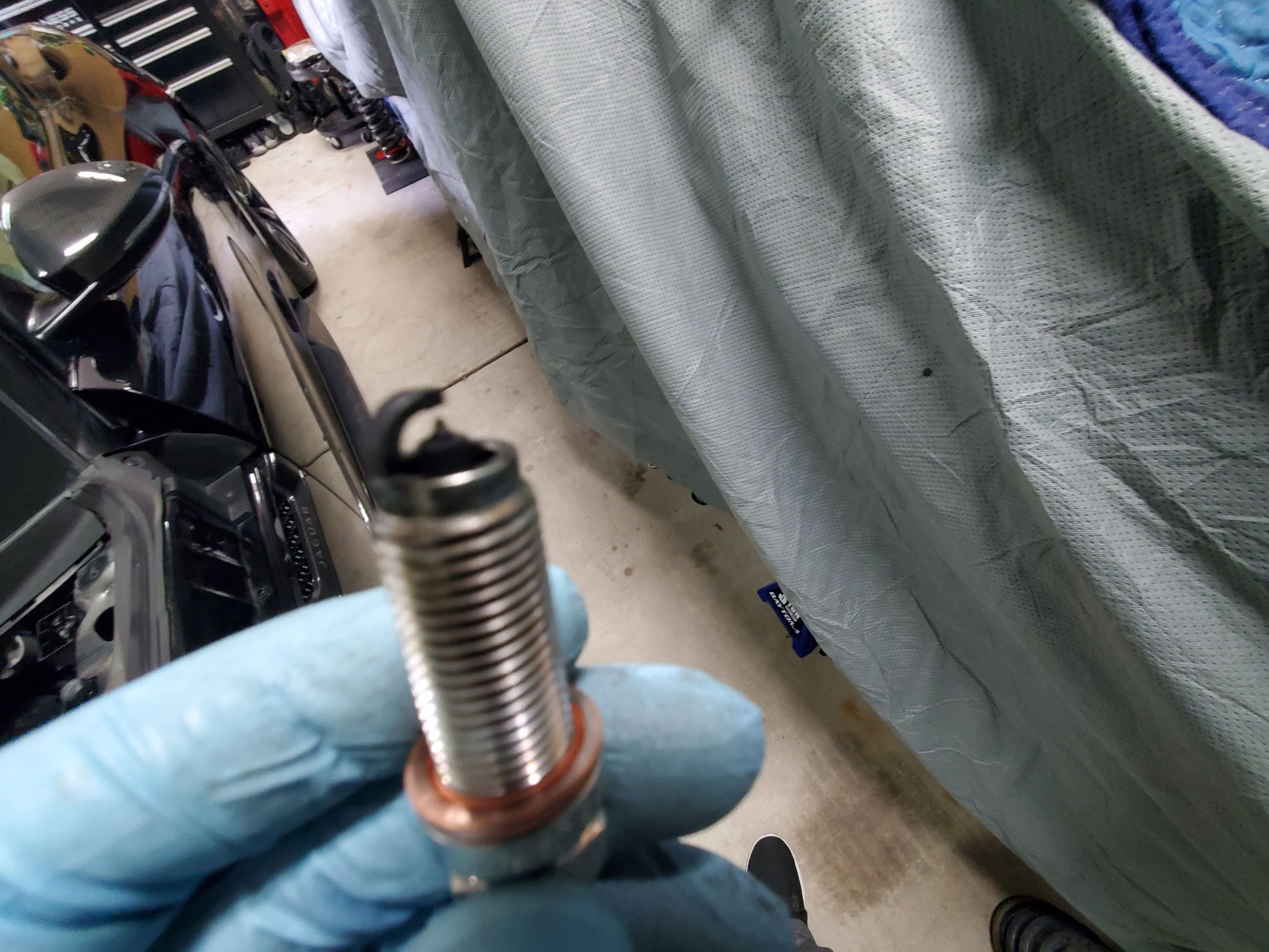

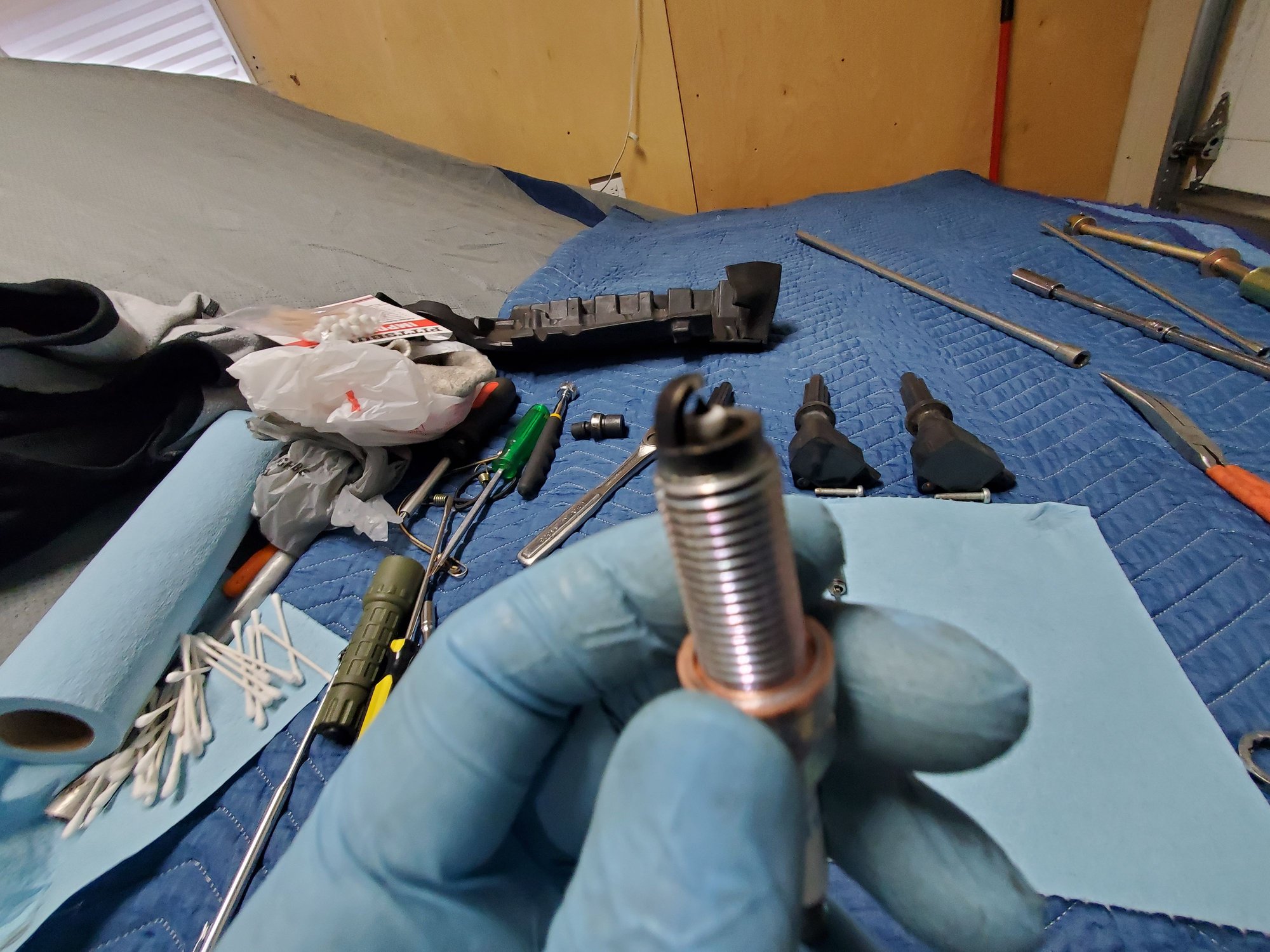

Originally Posted by Trainingdragon
Thanks. For me it's actually the 3rd time taking it apart as the first time I noticed coolant leaks forcing me to replace the oil cooler since I mangled the small pipe when I removed it.
Good luck with your injectors.
I like working on cars but this car has some quirks that are making it less fun
Before getting on with the injectors I ended up checking the spark plugs (which were changed a few months back during the coolant pipe project and tune. Plugs 4 5 and 6 (mainly 6 then 5 were the worst) black sooted worn looking for only having approx 30 min worth of run time.
Brief history: After the coolant project and vap stage 2 tune installation starting the motor up the car had misfires on the drivers side bank and ran very rough..I did find a vacuum line behind the drivers side head wasn't fully seated. Thought for sure this was it! Plugged it in and checked the "new" plugs. This is where I found 4 5 and 6 cyl plugs not very new looking at all for its limited run time. Swapped the plugs and started it up again. Same issue. Checked the plugs again after only 10 min of motor running rough this time and same result..6 looks the worst then 4.. pics of the plugs below.
I removed the drivers side catalytic converter downpipe hoping I'd see some obvious blockage or rattling (I know not something you should hope for..I just want to find the solution and get this thing running) looks clear and no rattles inside cat.
Maybe back to the injector project of trying to change out drivers side bank..but maaan inj 4 and inj 5 are seized. Not sure if anyone has any good tricks besides some pb blaster and slide hammer away (which I've done)

Old Apr 15, 2025 | 05:13 PM
  #238
Ksducati's Avatar
Joined: Jan 2025
Posts: 104
Likes: 31
From: Chicago
Sorry for the delay guys, lots of internal crying lol maaan this is killing me. New wheels just arrived today..no real need for them without a working working motor. But finally posted my latest update. Thank you all guys! Thanks for the patience and constant tips and hints on what to check/do next.
Old Apr 15, 2025 | 05:26 PM
  #239
Trainingdragon's Avatar
Joined: Mar 2024
Posts: 178
Likes: 59
From: CA
Thanks Ksducati and man I'm sorry to hear you haven't found your issue. Since I'm having the same problem I was hoping you would find your solution so I could try it as well. So now after hearing your story I may go ahead and pick up new spark plugs since I've run my engine multiple times for anywhere from 1 minute to 10 minutes all at rough idle and misfiring. If I didn't have fouled plugs before I very well could now.
