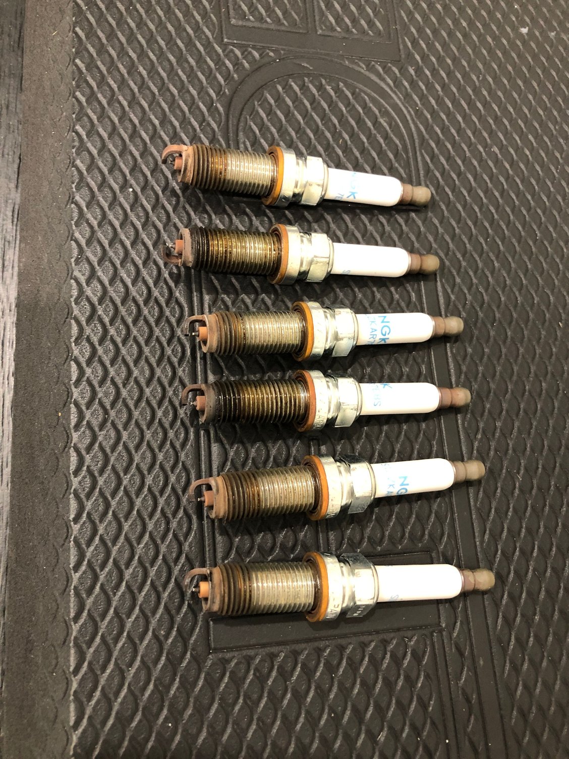

Originally Posted by JagCode3
@Ksducati looks like those misfire codes were "for reals." Use a jack or add weight to the slide handle to get that last one out. Details here:
https://www.jaguarforums.com/forum/f...5/#post2732367
Make sure your new injectors are not fake before putting them in! Double check your spark plugs are not fake either - there is a Bosch and NGK counterfeit syndicate out there.
Thanks a ton, guessing jag is pretty sensitive to correct oem plugs and injectors. Shoot, I may have been scammed out on the injectors...plugs are oem but glad to check them before theyre installed. If re-attempting injectors I'll be sure they're oem.👍

@Trainingdragon I was referring to the state of those carbon fouled new spark plugs as direct visual evidence as opposed to OBD2 misfire codes that sometimes just disappear.
Let's see the plugs from your affected cylinders when you get them out. It could provide some clues.

I see. It seems so odd that brand new plugs could get so fouled from just a few starts. When I get mine apart I will check them and I have new plugs on order ready to go in if they are.
no kidding, I agree. Extremely surprised how fouled plugs 6 and 4 were...and 5 not as bad but still very much "not new". After finding the vacuum connector unplugged thinking this was the issue and putting new plugs in only to be left with the same ending..plugs 4 5 and 6 re-fouled very fast. Hope to find a solution fast.

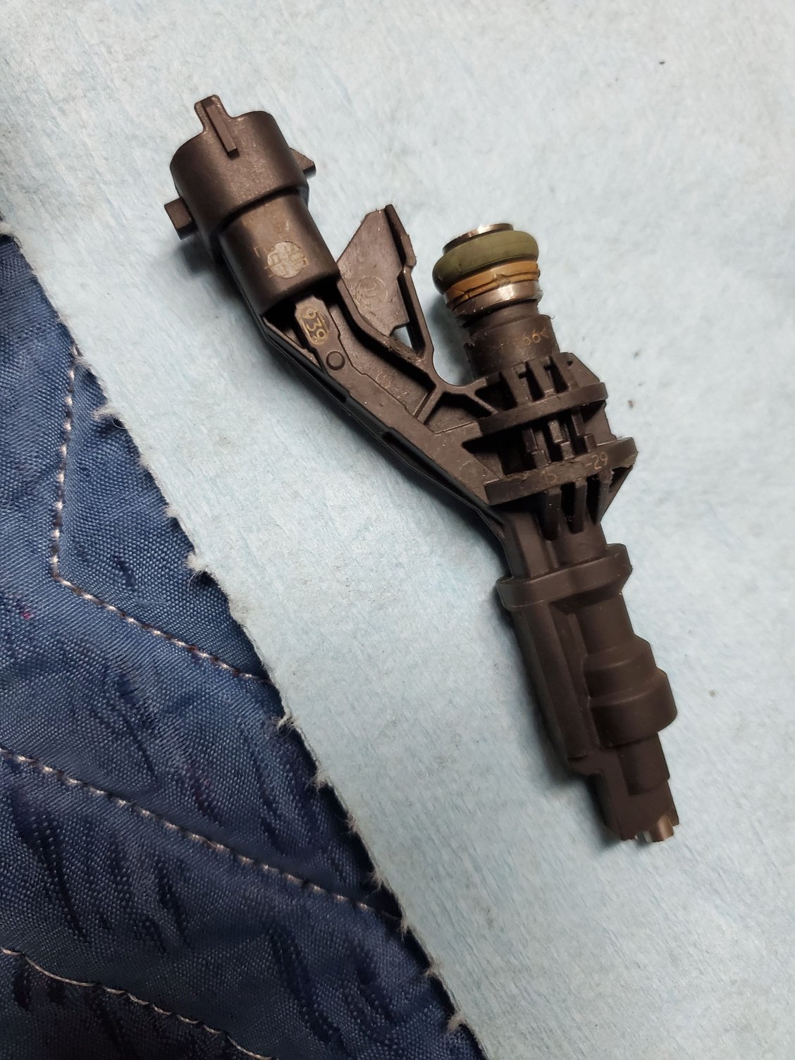

Welp, I did it. Cyl 5 injector is half out! The other half is lodged in the head..errrr MAJOR BUMMER. I've seen a YouTube vid of a guy using an extractor to twist what's left of the injector inside enough to dislodge it..that'll be my next move. Otherwise not sure if I'm skilled or talented enough to attempt a cylinder head removal-yikes. Towing this to a shop just got even scarier.

@Ksducati That's a bummer - what method did you use that broke the injector? @randyb's method is the next step.
Just about 1000 good ol fashion slides. I'd take random breaks then go back at it for another 70 or so. So disappointed now but yes, responded to randyb thread who gave his detailed extractor list. Hope to hear from him in the thread it would be really great to get the thing out without removing head. Can only imagine how involved that process is. The coolant pipes project was about my max for time and involvement..that sc was pretty stuck on there too so if I don't have any success with randyb method it'll head to a shop willing to take on such a project..along with a ton of money.
