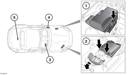

Ducati, the good news is that there’s no fuse box in the glove compartment. There’s one under the carpet towards to front of the passenger footwell, which may be the one you’re looking for. The drawings in some of the Jag docs are very unclear.
And there’s one in the A-pillar, and a couple under the hood, and one in the trunk.
There are 5 separate fuse boxes fitted to the vehicle, each one containing fuses protecting a different group of circuits.
  1. Left side engine compartment fuse box.
    1. Remove the left side under hood cover. See UNDER-HOOD COVERS REMOVAL.
    2. Press the clip to release the fuse box cover.
  2. Right side engine compartment fuse box.
    1. Open the side cover and press the 2 clips to release the fuse box cover.
  3. Passenger compartment fuse box, located in the passenger side footwell.
    NOTE:Make sure the cover is correctly aligned to the vehicle before refitting.
    1. Pull back the floor mat/carpet to reveal the access panel.
    2. Pull up and remove the access panel to view the fuse box.
  4. Passenger compartment fuse box, located on the left side A pillar, below the facia.
    1. Unclip the access panel to view the fuse box.
  5. Luggage compartment fuse box. The fuse box is accessed by:
    NOTE:Refit these parts in the reverse order of removal.
    1. (Coupe vehicles only). Folding back the Luggage compartment floor panel and removing the floor panel support block.
    2. Removing the left side Luggage compartment (battery) cover.
    3. Removing the luggage floor well trim.

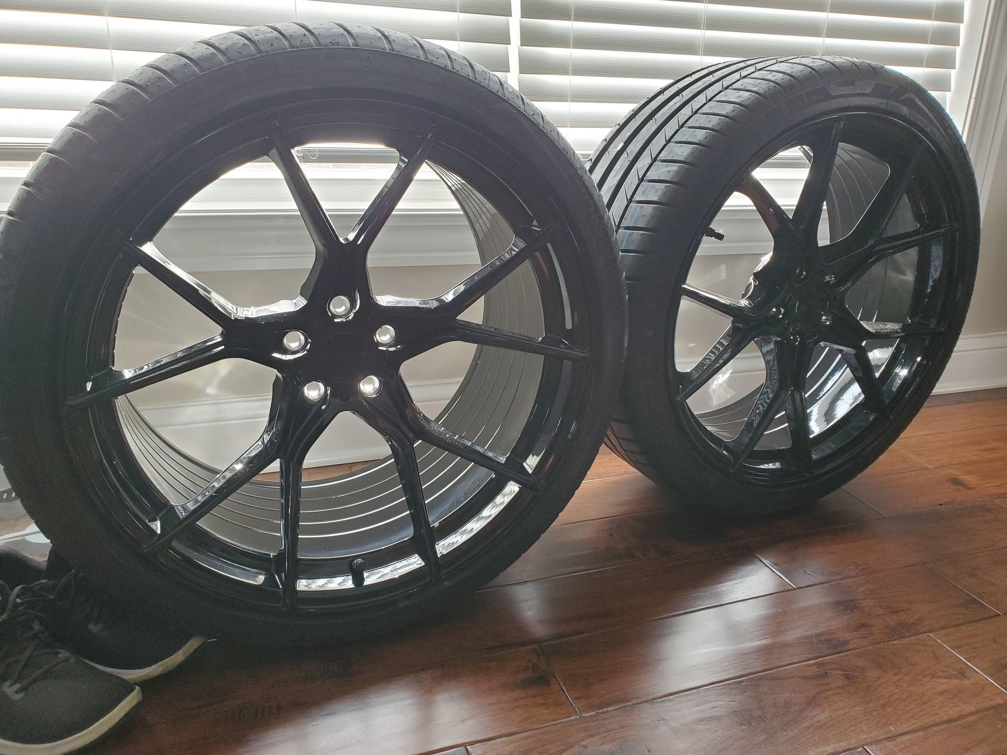

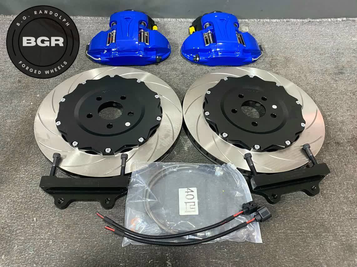

We get two good vacations/breaks off work a year and that's when I started all this..Sadly today reality kicks in and I'm back to nonstop work.. but I hope to let you guys know in a week or two the outcome of the injectors and IF it resolved my issues.
New forged sf07 wheels arrived and a big brake kit shows that it should arrive next week.. wish I would have attempted starting the car before ordering the wheels and brakes hahaaa, geeez expensive parts for a broken ride-hope all is good soon and can update you all. Here's a pick of the new kitchen decoration wheels and brakes that are on the way 👍
Stance forged sf07 20
Stance forged sf07 20" 255 35 20 front 295 30 20 rear
405mm front rotors, 6 piston.
405mm front rotors, 6 piston. "Jaguar" decals will be put on.
380mm rear rotors, 4 piston caliper

I was very hesitant with ordering the brakes because there weren't a ton of reviews..and so surprising the f type doesn't have more options for brake options but I mainly ordered them for appearance. When they arrive I'll weight them but it sounds like they should be A LOT less weight being 2 piece rotors. I can give you a better overall review once they're on.
The owner-BG randolph was pleasant to talk to on the phone and answered a long list of questions. He has also been great with the updates throughout the stages and process with pictures as the parts are made. Seems legit enough. With the very open new wheels I wanted a better caliper/rotor. I have the same front brakes as the "R" on my S..but the back rotors were smaller..changed those to the R size with new rotors and calipers but still left with wanting more visually appealing brakes...

I'd guess if this car came with the base brake setup I would have zero issues with their performance and they would be plenty adequate for "spirited driving". I'll occasionally get on it but it likely won't be tracked. My search for different brakes was purely cosmetic with the hopes that when spending big money there's some performance added too. They're supposed to be a ton lighter which should help with bound/rebound and rotational mass.
I just thought the rear calipers were so sad looking on such a sharp car that improving the size of rotors and calipers would really help this cars appearance. Love the looks of the carbon ceramics you have and that 16" front rotor how it fills up the entire 20" wheel so anxious to get these on a WORKING car hahaa geeez, always something. I'll be a week or two but hope to have some good news on the car and will keep you all updated on if the injectors were the cause.
