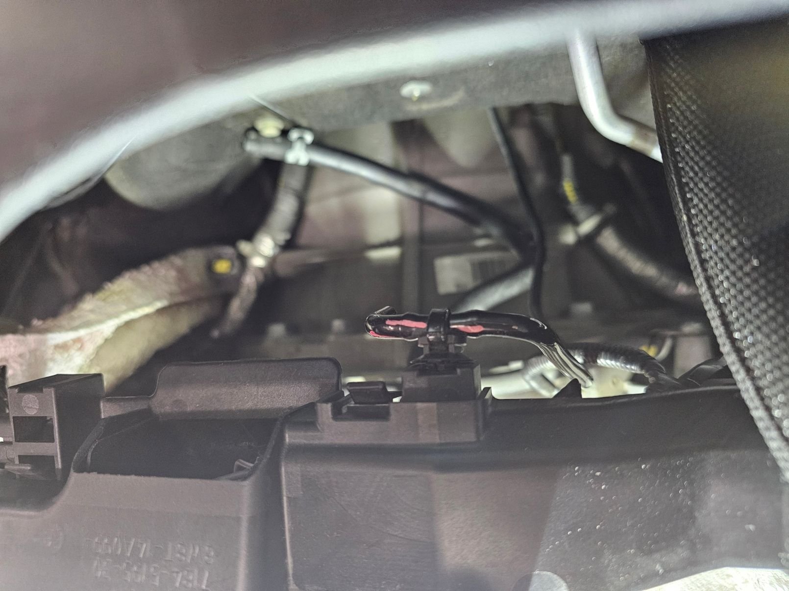

Separate Item. As I'm starting to begin putting all of this back together, which is turning out to be a lot more challenging than I thought (and a little concerning), I found a small plastic tube that comes off of the transmission and goes up to the bracket for the wiring harness behind the Supercharger. This little pipe makes a "U" and is open. I'm not sure if it got disconnected or if I broke it or maybe it's just a vent?? Anyway no what I'm talking about and can advise? I can't seem to find where it would connect to.

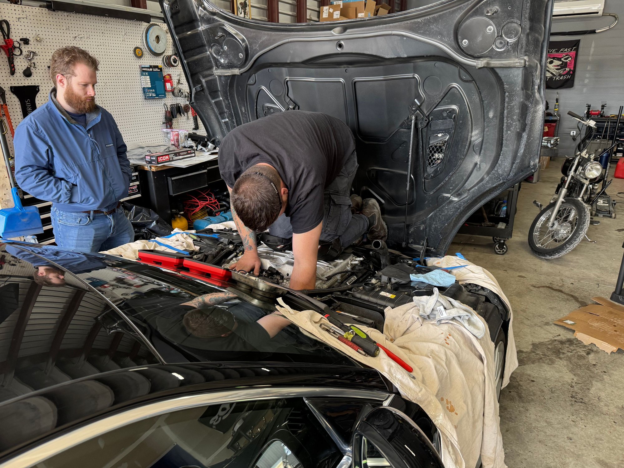

Bought an Icon torque wrench. Only one I could find locally that could do 25nm’s.
We dropped The Jag at my friends side hustle shop last night so it would cool down. We started tearing it down at 9 am. Gage and my son did most of the work. I helped with the symposer delete and changed the supercharger oil. Had everything buttoned up and burping the coolant by 3pm. Helps when Gage does at least one Landie a month at his day job.
We capped the small pipe coming off the symposer valve.
Apparently knee pads are required to take out the heater manifold pipe.

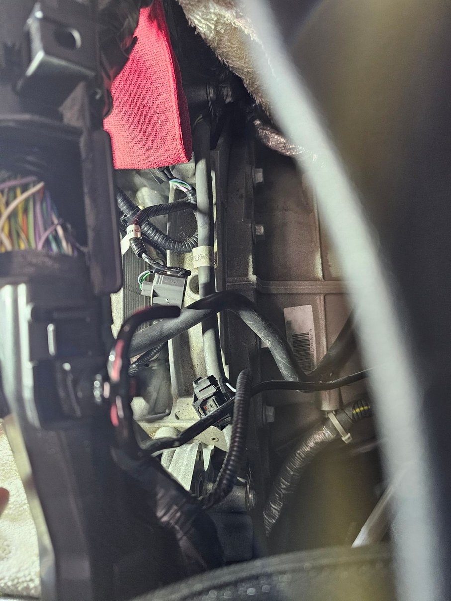

Trainingdragon's Avatar
Joined: Mar 2024
Posts: 178
Likes: 59
From: CA
So the thin plastic tube that has me a bit baffled is shown in the photos. Sorry probably not the easiest to see. It's rather small in diameter, plastic, and comes out of the top of the transmission and connects to a bracket that's part of the wiring harness. It does a little loop and is open at the end. It has the pink stripe on it in the photos. Curious if anyone knows what the heck this is? I can't tell if it should go somewhere, if I broke it or if it's just maybe a vent and it's supposed to be open on the end?? Kind of a mystery and I'm not sure how to search for it on the web.
Old Mar 8, 2025 | 11:29 PM
  #38
OzXFR's Avatar
Posts: 9,030
Likes: 3,664
AC condensation drain hose????

From: Nellyville
I noticed that guy too. It just dead ends out in space.

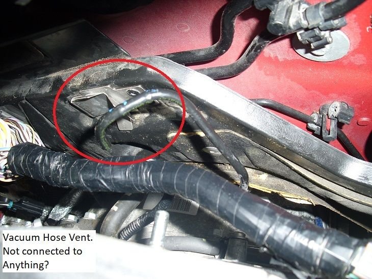

From: home
There is a transmission Vent (I think?) that comes up at the rear of the engine and has two 90 degree bends in it and attaches to nothing. When I did the rear water manifold I found it and posted a question to find out if it was suppose to be connected to anything. This is on all of the cars that use the 8 speed ZF.
Note mine has blue paint dabs on it.
Also note that stainless steel clip inside the red circle. That is the bottom clip for one of the secondary bulkheads that such a SOB to remove and install.
