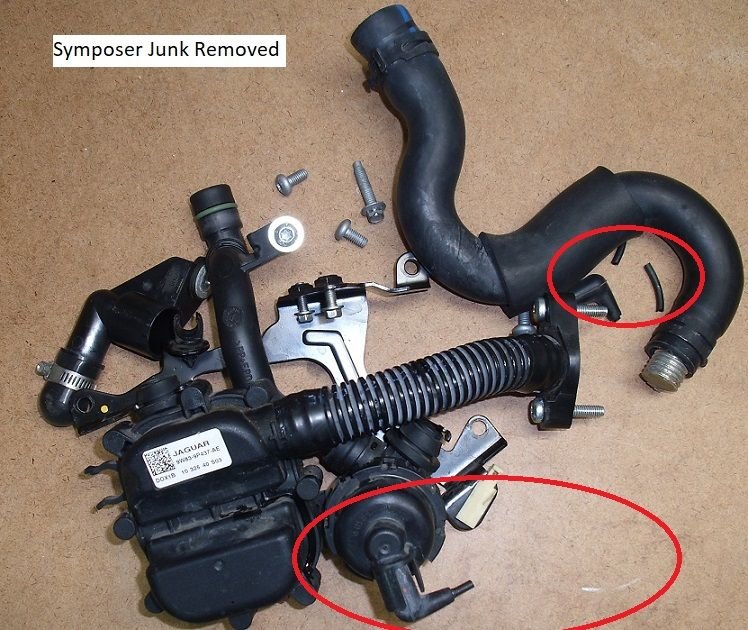

When I removed the entire Symposer I also found that small diameter vacuum line brittle and broken in several pieces. I had no codes because of it either.
I have circled the multiple pieces in red.
Here is all that's left on the car. I plugged the small vacuum port and left the electrical plug in place. Again I found no codes.

@Trainingdragon To be systematic I would reinstall the symposer and check all adjacent connectors and lines for trauma (like the cracked line shown above).
If the misfire codes return after clearing them I would remove the SC (again) and replace all the single-use gaskets.
Then with the greatest of care put down the SC (with an extra pair of hands) on the new gaskets and tighten slowly and carefully in a star pattern (minute 4.00 onward):

So maybe I'll revisit the symposer delete. In my case I removed the symposer, blocked off the hole in the back of the supercharger with a designed block off plate, kept the metal bracket that held it along with the little electrical connection to the device that activated the symposer. This way I didn't have an open electrical connection. I used a small rubber cap (came with the kit) to plug the small tube/port coming off of the device with the electrical connector. Is there any chance that could be my problem and maybe I did that wrong?
Nop, the deleted symposer does not give any problems. Just block off the sc hole wich you did and block the small vacuüm hose wich you also did..The connector to the valve does not matter at all according your problems..

Question for clubairth1. When you deleted your symposer and kept the electrical connection intact and capped the small plastic tube, did you keep the 3 point metal bracket for it it just elminate that too? I did the exact same thing but kept the bracket so it all had a mounting point.

To answer your question about the Symposer I took off everything I could. All the parts removed are in my picture up thread. So look at that and see if the bracket you are talking about is shown.

Thanks Clubairth1. I took another look at your photo and it looks like you didn't keep the bracket for the symposer electrical connector. So did you just push that whole connector and tub behind the supercharger and under the giant wiring harness? BTW that wiring harness is a monster to work around - it's like in the way at every possible angle to do things behind the supercharger. I have a nice amount of space behind it but the wiring harness is right up against the back of the supercharger.
