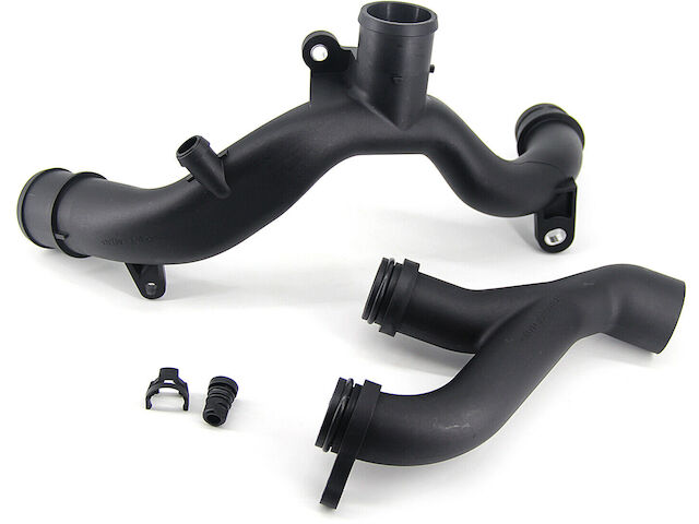

I have a 2017 XE with the V6 and have the old style welded (plastic) pipes. they look like this:
Note the large seam on the sides of the pipes...
The redesigned ones look like:
I suspect you have the old (welded) type as my 2017 does... My XE is my daily driver and has 57k miles on it without issue. I am looking to replace them at some point as finances allow.

Yes please consider upgrading to the Aluminum lifetime versions as posted above. There is also an upgraded Aluminum water transfer tube that goes from the WP to the oil cooler brick. At about $15 it's too cheap to not change. Plus replace the failure prone plastic elbow in the WP with a brass replacement. These are all common on EBay with multiple vendors.

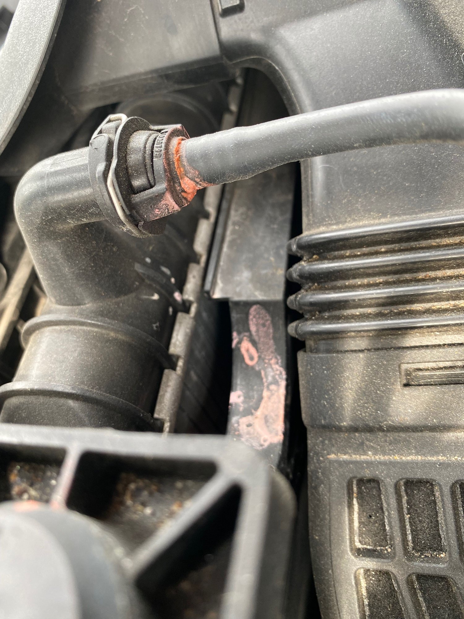

My first leak on my 2018 3.0L - might be doing the overhaul sooner than I thought.

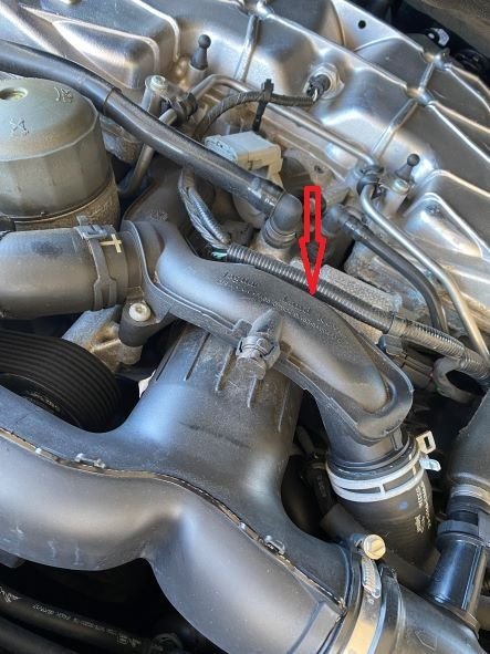

Originally Posted by OldGuy1
...I have a 2017 XE with the V6 and have the old style welded (plastic) pipes......
How do you know this? Is there a way to see them in the XE? From what vantage point?
Old Oct 19, 2022 | 09:47 PM
OzXFR's Avatar
Posts: 9,030
Likes: 3,664
See post #6 and the top pic showing the "old" pipes.
The lower of those two pipes in the pic is the upper coolant cross-over pipe which is plainly visible across the top/front of the engine and in turn you can easily see the horizontal seam across the middle of the pipe. Seam = old problematic pipes, no seam/smooth = updated improved design.

With the cover of the engine off the visible (not the one under the supercharger) coolant pipe is easily visible at the front top of the engine.
As you can see here, my XE has the old style welded pipe... Hope this helps

Thank you both. If it was a snake it would have bitten me I was looking in the rear of the engine ..... I'm guessing that's where the other "Y" pipe goes and it looks like it's a bitch to replace (remove S/C & intake manifold?). I can see where replacement of these is labor intensive/expensive. I'll gamble seeing that although it's a common problem it's not prevalent .... I hope

Just keep an eye on that rear water manifold you mentioned. It's not the "Y" pipe we talk about as that's under the pipe you can see in the above photo.
It's not an expensive part but as you mentioned the labor to get to it is costly. So try to bundle your repairs if possible as the parts are the cheap part compared to the labor.
We have not seen any difference in failures depending on where you live. You can pretty much count on the water pump, 2 front plastic pipes, rear water manifold to all fail. There is a rumor that the rear water manifold will be released in lifetime Aluminum as the 2 front pipes were.
The SC snout is another one but it's more of a noise thing as you can run thousands of miles with the SC clunk without problems. In fact I currently have the clunk on shut down and plan to replace the snout in the future. Since this requires the SC to come off I will also replace the rear water manifold at that time. Plus change the SC oil. Might do a couple of other things too. Not sure yet all what I want to do?
One good piece of advice is to regularly open the hood and just inspect stuff. Watch the coolant level as almost all cars will start with a small leak that is very easy to miss if your not looking for it. Remember these cars have extensive under body plastic pans that catch and contain a lot of leaking fluids! So you can't look under the car for leaks because the don't always make it to the ground.

These pictures explain it all. I had it completely wrong in my head.
