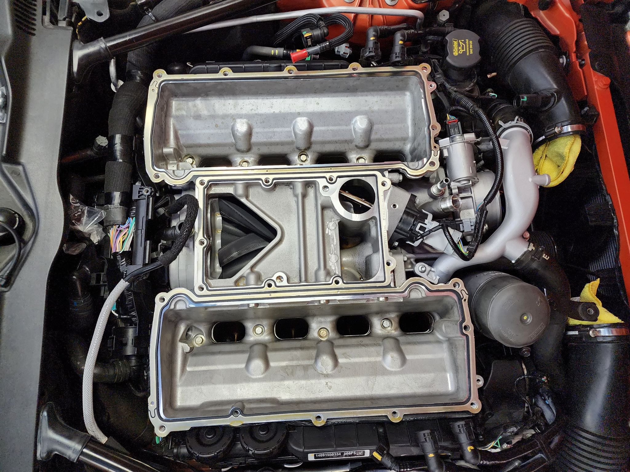

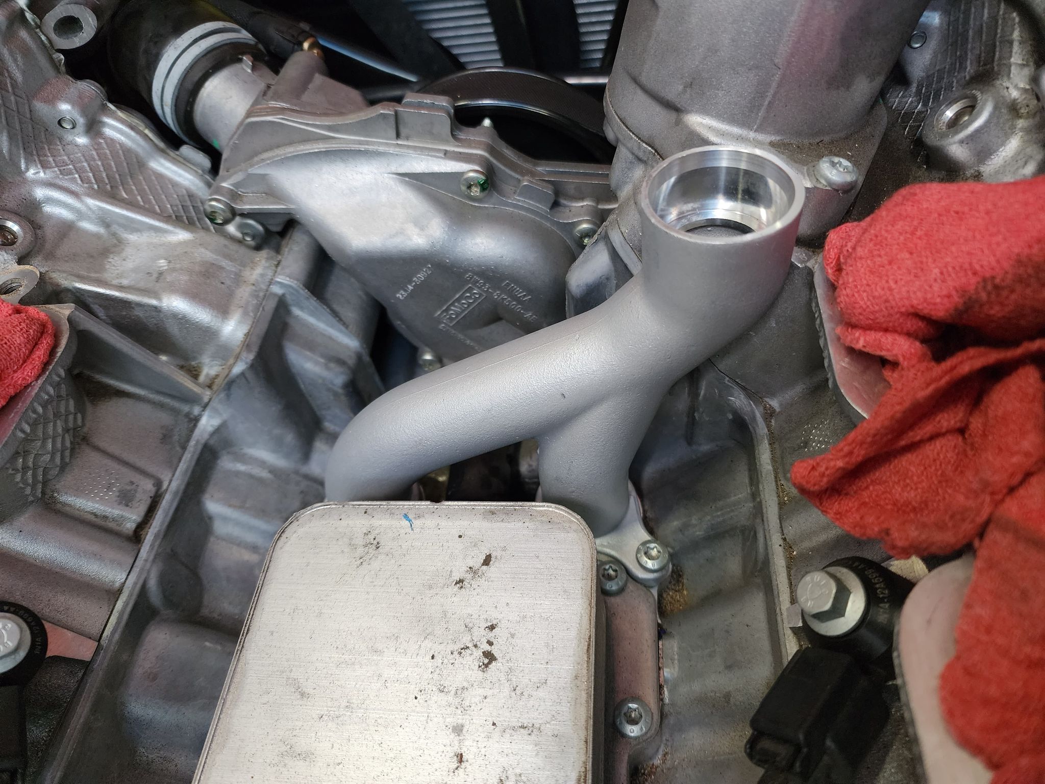

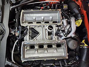

The coolant pipe replacement was successfully completed today. The shop sent me some pics after supercharger replacement and pipe install.
Attached Thumbnails Aluminum Cooling Pipes - Finally!!-309898814_3544262149136523_9059849474258512790_n.jpg   Aluminum Cooling Pipes - Finally!!-310165651_1733459857047392_4522284247598868613_n.jpg   Aluminum Cooling Pipes - Finally!!-310170995_423332893250777_5663251036798117571_n.jpg   Aluminum Cooling Pipes - Finally!!-310176966_1288096221966376_1518832746072407302_n.jpg   Aluminum Cooling Pipes - Finally!!-310462508_1243560519766649_6467730118384253643_n.jpg
Aluminum Cooling Pipes - Finally!!-310552336_1243148032896784_3352306869614719262_n.jpg

Default Important
Originally Posted by 355rockit
The fitment guide shows that the one with thermostat outlet hose elbow works on your 2017. I bought the elbow as a separate purchase. It didn't have the little circular propeller looking piece with the elbow kit. When I dropped my car at the shop this AM, they said that that part is for the coolant reservoir to prevent bubbles and replaces the plastic part. They said they had one and can swap it for metal.
The shop said that the brass elbow kept on popping out and would not fit securely. They ended up reusing the original plastic elbow but with the seals from the package for the elbow. The aluminum coolant pipes worked perfectly. Picked up car. Feels good with the Porterfield brakes and car seems happy.

Default Correction
I went to the repair shop today to pickup the old parts and talked to the mechanic who worked on my car. The service advisor had noted that the brass elbow didn't work and kept popping out. The mechanic said this was incorrect info and that the brass elbow installed fine. The issue was the plastic retainer clip that came with the package that helped secure the elbow. It didn't fit tight enough to hold. He used the OEM plastic retainer clip and this worked fine on the brass elbow. Happy that the brass elbow worked, but a bit annoyed that the SA gave me the incorrect info. The mechanic also mentioned that he had to use shorter bolt on one of the tubes since the original one for the plastic tube was too long for the new aluminum pipe to properly secure it.
