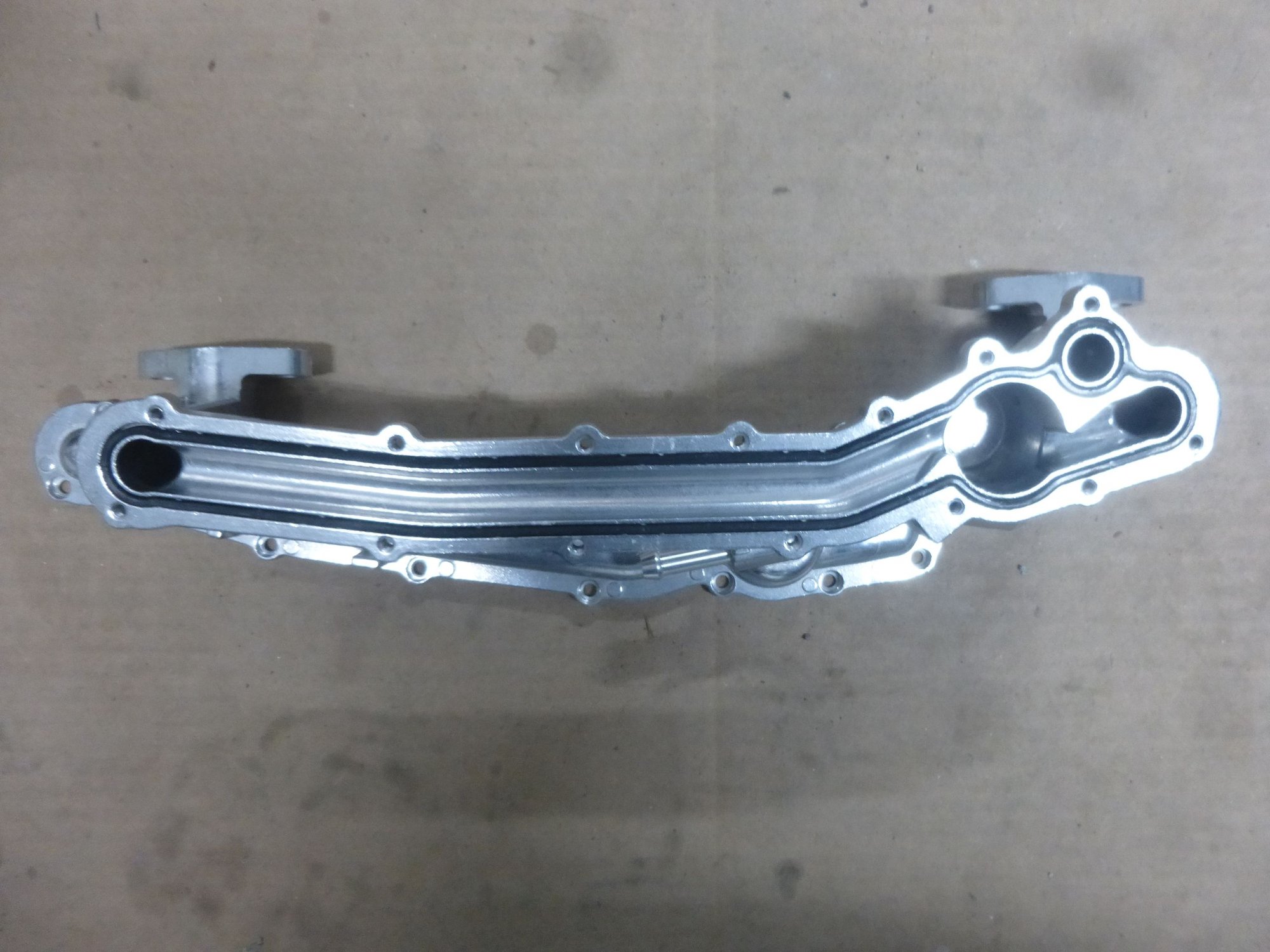

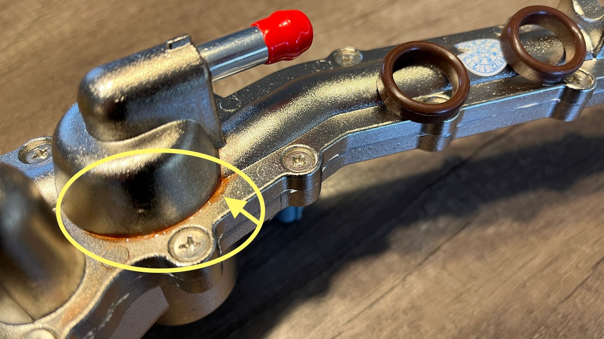

Has anyone installed a rear crossover pipe as shown in the attached pic. It has a rubber(???) seal. I bought it off ebay last September. The quality of the casting seems good and the holes are clean and show no narrowing. I am planning to use it on my 2014 XJL 5.0.
continuous rubber(???) seal

No I have not and thanks much for posting that picture. If I had seen that style I would have used it over the ones glued together with sealer. Love O-ring seals!
Any link to the seller?

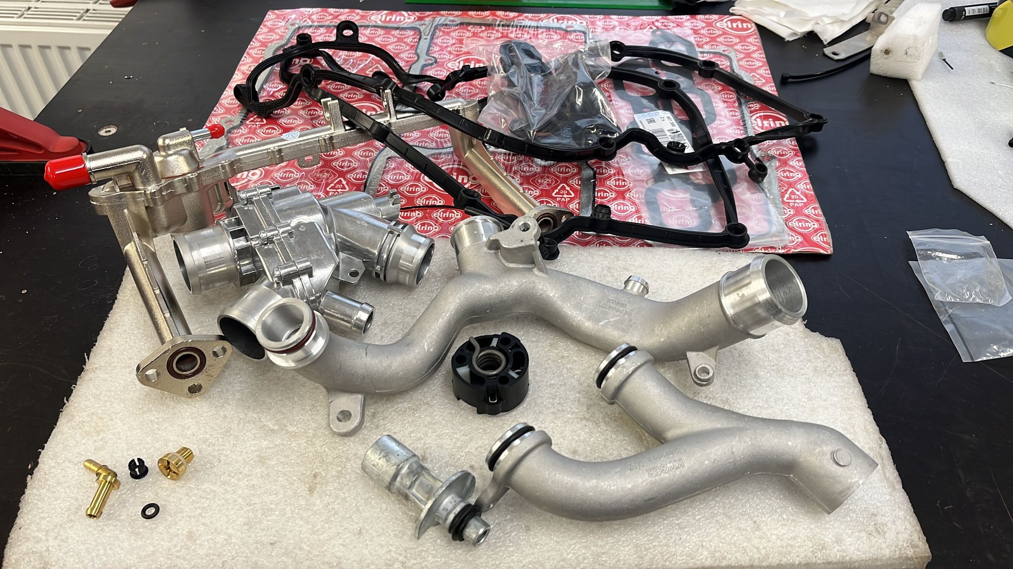

Hello gentlemen.

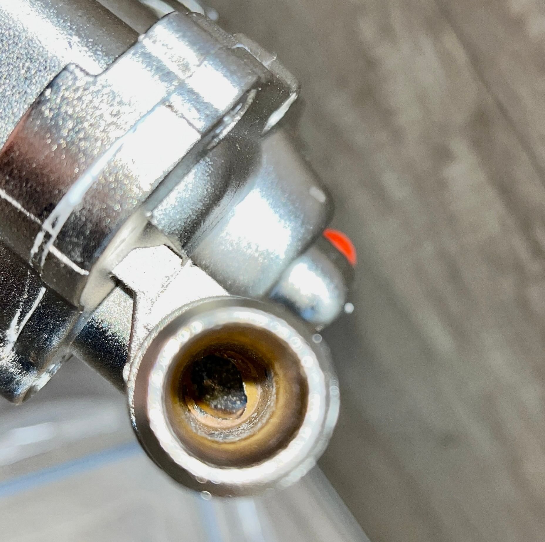

I'm glad for this forum. I have a complete kit ready for updating the cooling system. I checked the steel heater pipe and it is without defects. The screws are tightened. I will ensure the free flow of liquid with a drill, the seal is probably Viton and it is quite low! So I will replace it with a higher one, or I will put a pad. Maybe someone has tested the pipe, it is covered with something gooey - it cannot be washed. However, it is clean inside. Maybe the worker spilled his snack...
There are no traces of screws, so it is not used. Bought from Aliexpress.
I have never had a problem with parts for the JAG X100 either. All seals bought from a normal auto parts dealer.

It's a very long thread but yes I recommend using the factory seals on the rear water manifold instead of what comes with the metal rear water manifold.
I have posted this several times before. It's made a bit different from the after market ones.
I opened mine up and drilled out the passages. Mine is the older version before they released the one with an O-ring seal. I think that version would be the best.
