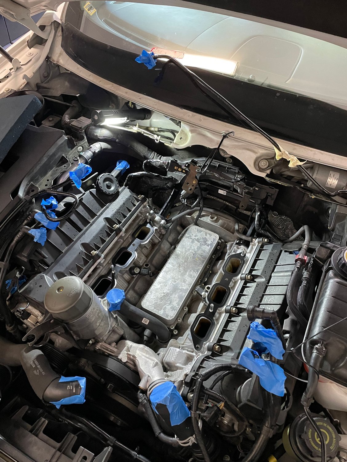

I actually was able to get the rear crossover off without removing the supercharger in about 2 hours but I wasn’t able to get it to clear the firewall with that giant wiring harness in the way and out of the car . . . ended up pulling the SC anyway.
Unlike the fronts, your replacing with the same flawed part. No updates. Local dealer here wanted $3000 for the job FYI.

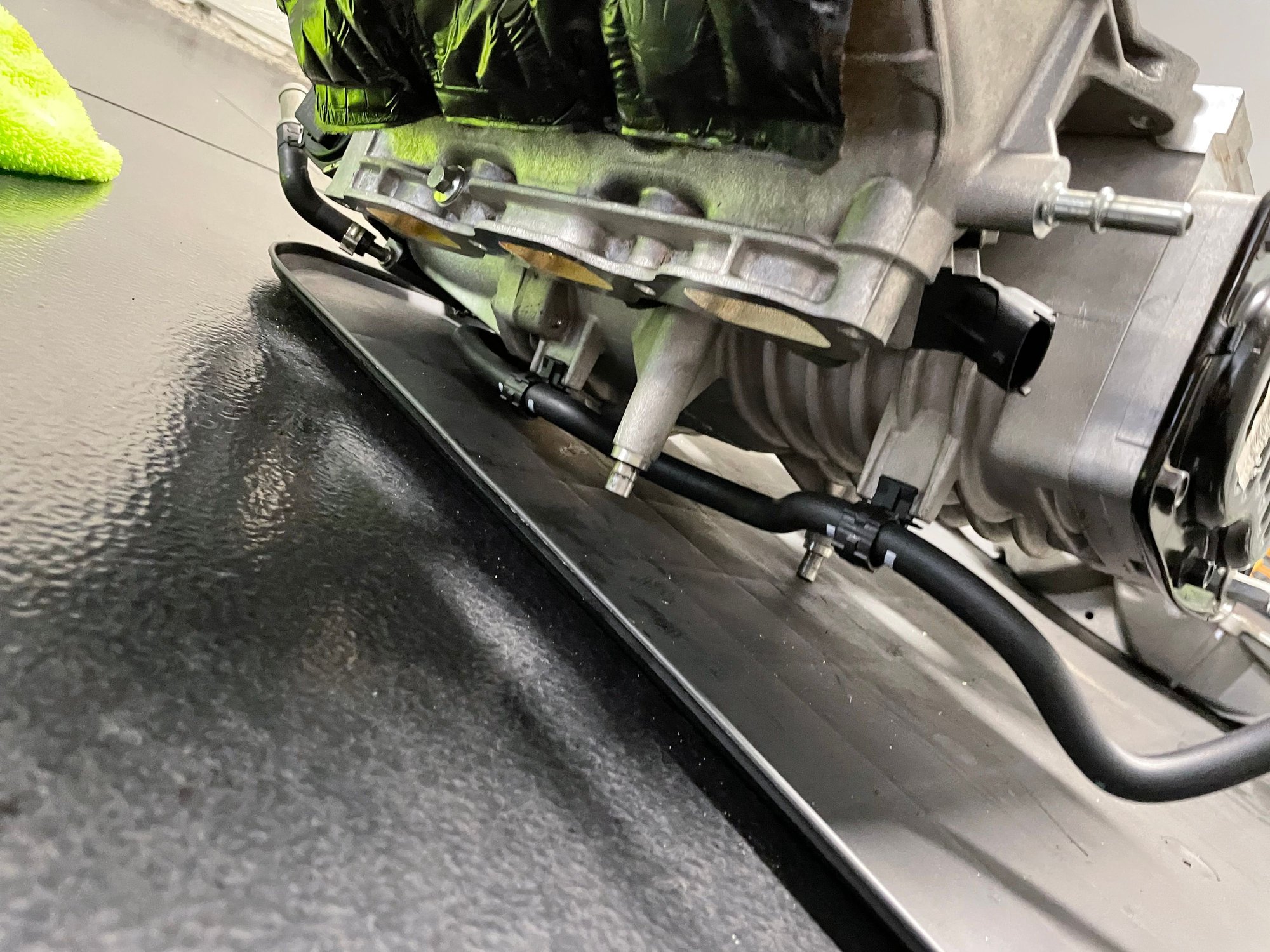

I’d also recommend replacing the rubber hose under the supercharger that runs to the throttle body. The plastic clips that connect it to the tabs on the SC aren’t available from Jaguar but are listed on the LR catalog.

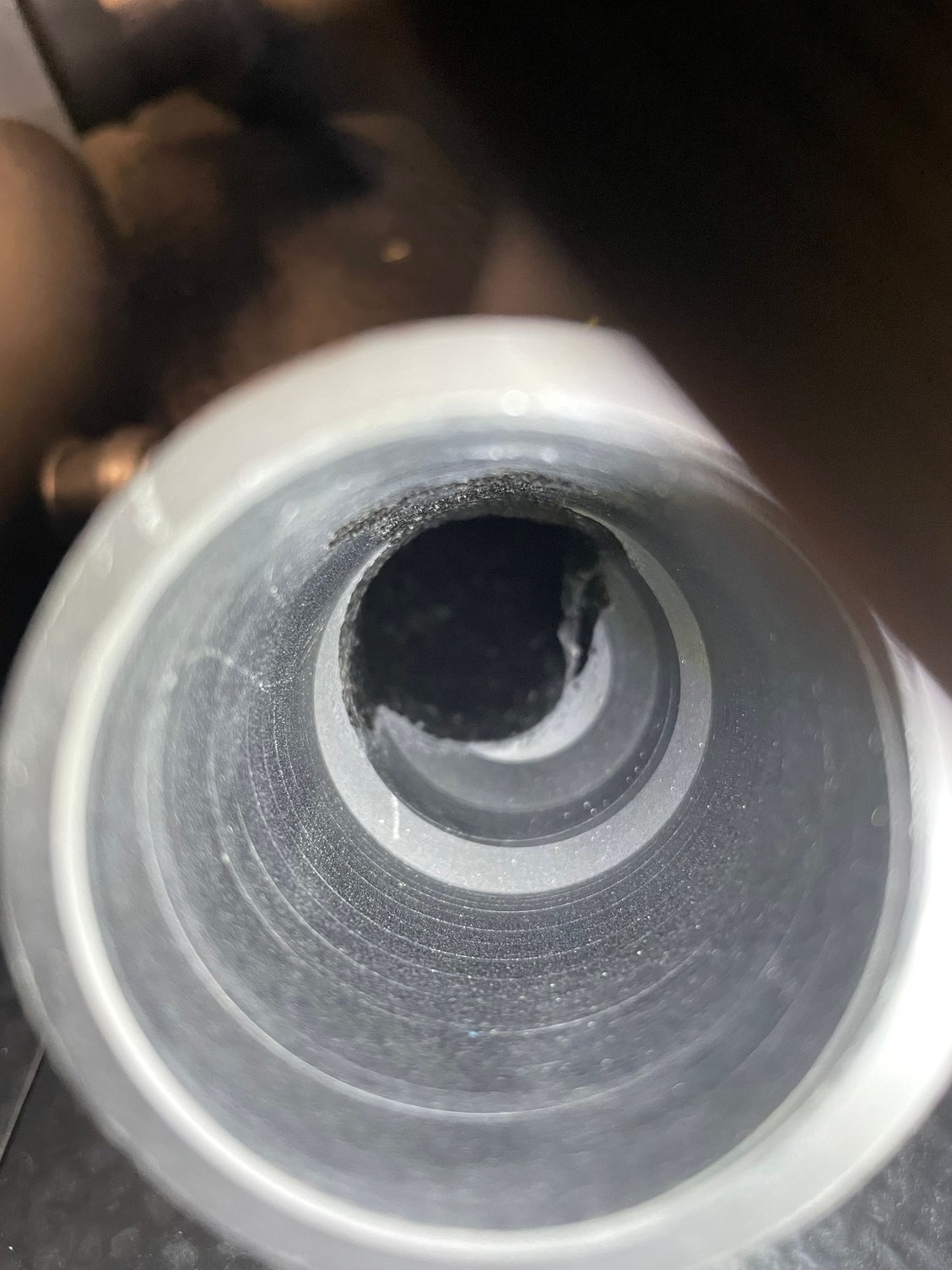

More flawed Genuine Jaguar Parts, AJ813917 the revised upper coolant pipe with a mfg date of 2/2022 has loose plastic from casting.

Here is the second upper coolant pipe I ordered, absolutely shocked at the quality of OE Jaguar parts. This one had a 2/2021 production date. I ended up picking most of the loose plastic with a flathead and rinsed it out with a garden hose and didn't see any more loose plastic with my borescope.
I also cut open the original one I posted above to show you the plastic burrs deep inside the pipe.
Second coolant pipe I ordered.
Original coolant pipe cut open to expose loose burrs.

Land Rover LR011221 clips for under supercharger.
The zip tie clips that hold the wiring harnesses to the rear crossover pipe I ordered on Amazon. Think Sydien was the brand, the description says they fit into
1/4 holes. The clamp that holds that coolant hose to the barb on the throttle body might be reusable but I replaced it. Use a flathead to pop it open and a pair of needle nose to get it to re-clip.
