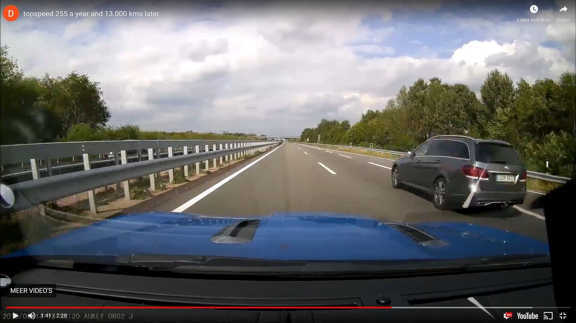

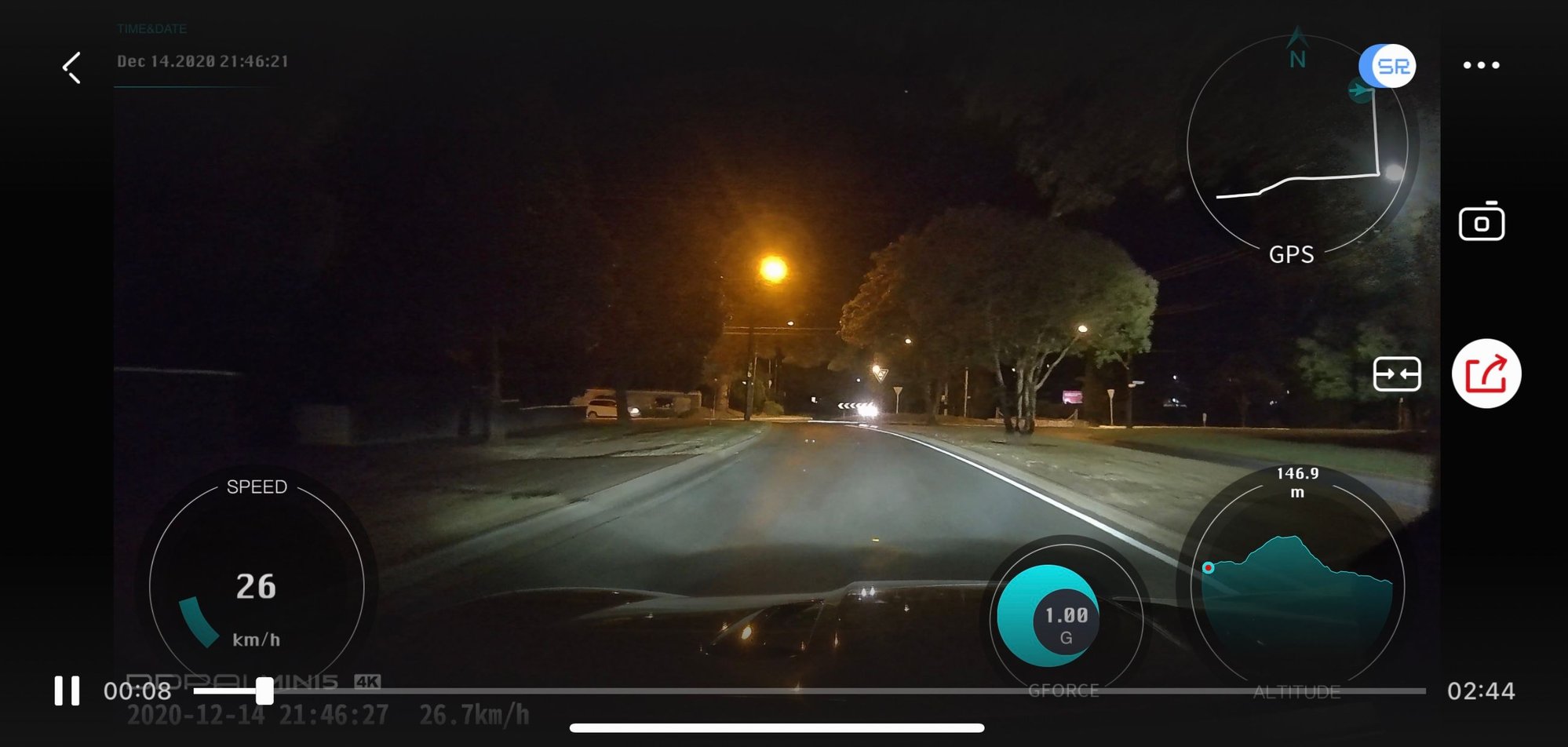

Yes, I do... .. since I bought it..
..very entertaining..
You see the make/model on the lower edge of the video. This is now 3yrs in use, never a problem. Records in 4K.
I also have front/rear in my BMW shopping trolley that works fine : " Viofo A129 Pro 2CH Duo 4K Wifi GPS dashcam ",
this since my 3 kids drive it and I want to know "why" if they damage the car or some other.
Since I have it powered through an outlet, it happens the plug doesn't sit tight and the cam doesn't record,
and the kids pull it out it they don't want there discussions recorded. So the rule is now : no recording and damage,
no more use of the BMW.. .. you have to be though as a parent..
Also for the sake of -not- placing a (thick!) cable from the front to the rear, I put two independent cams in my D5, also Viofo.
I never considered placing a 2nd cam in the F-Type. I should probably, and I will if the Aukey passes on..
At a speed difference of > 130kmh , by freezing the frame you can read the license plates.. ..illegal in Germany.. (thats why I disabled location and speed/date stamp, then its OK..).

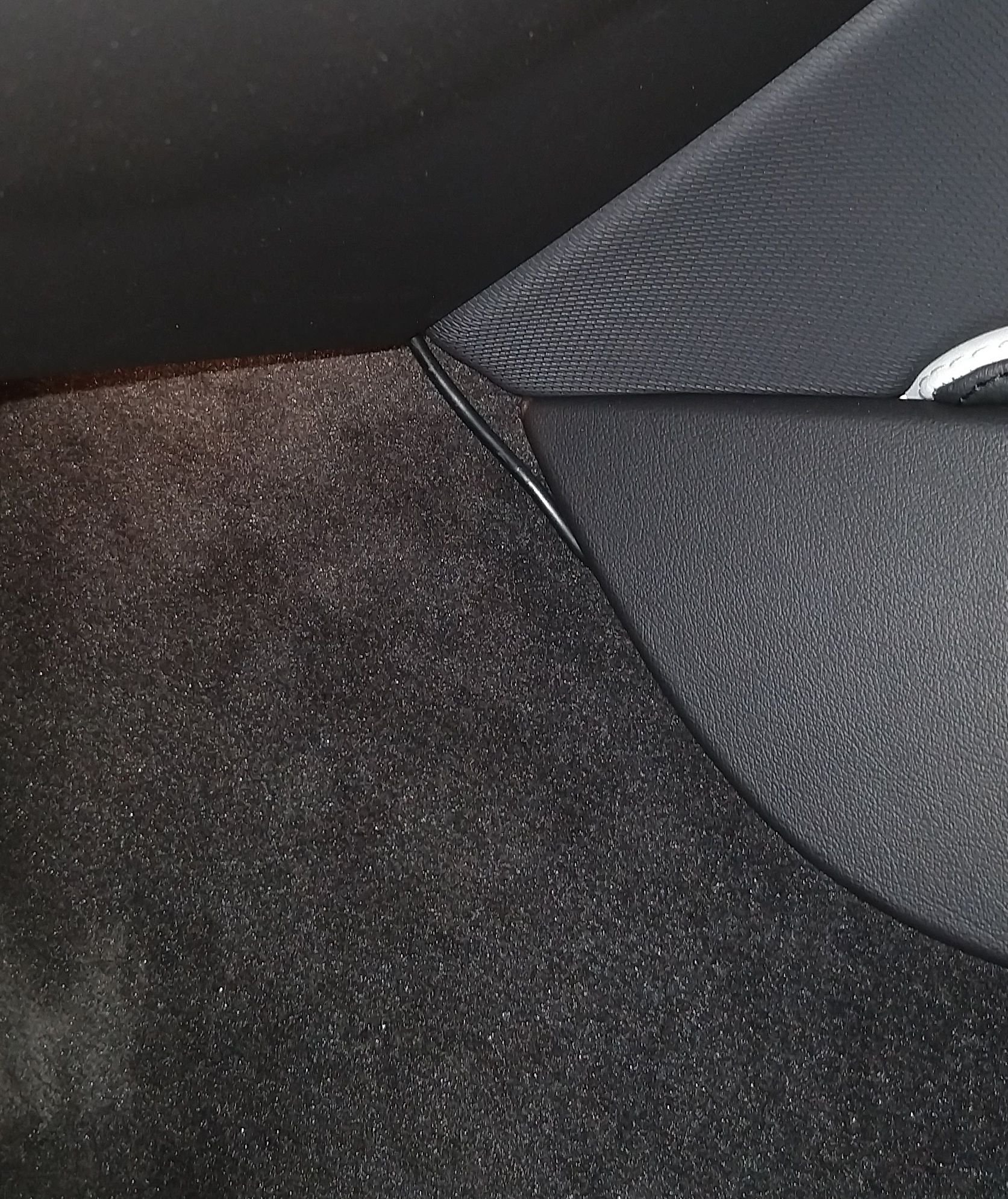

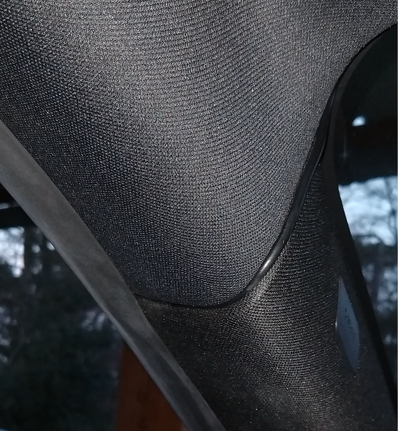

General idea :
Above the windshield you just push it under the rooflining, there is a slit there.
At the corner of the window , you slightly lift the airbag cover on the A-pillar ( contact off !!! ).
Then there is a door seal. You push it under from the inside outward, and guide it down.
Under the dash level, push it under the vertical black trim. Then put it in the plastic covers under the dashboard (reach under until you feel the edge above, put some pieces of tape to fix it.
Beware for the movement of the steering column.

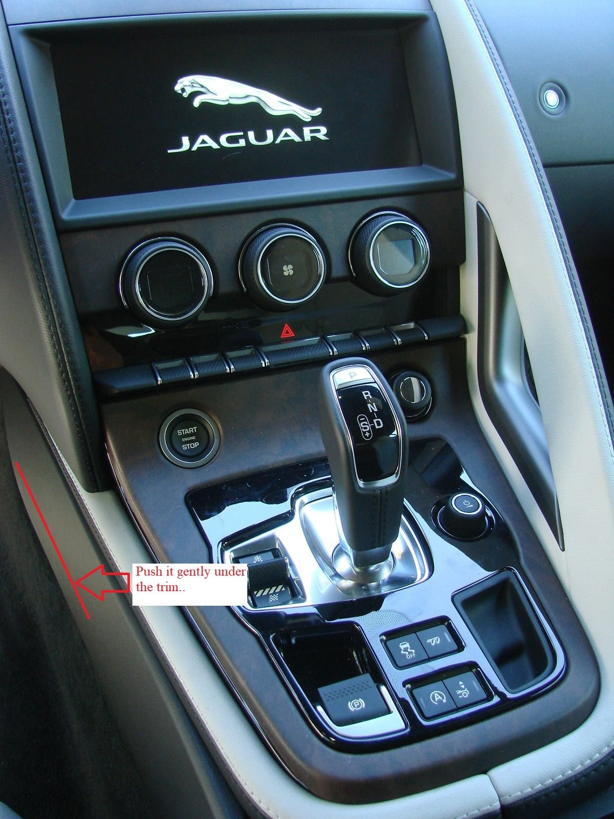

Then you push it under the trim on the centre console. Lead it all the way back until the trim ends, beyond the back of the chair (move chair forward to get there).
The red line gives the routing under the trim. Doesn't need to be so high up. There is an edge, just half a centimeter up suffices.
Then double back over the top and let it pass under the lid, there is the socket.

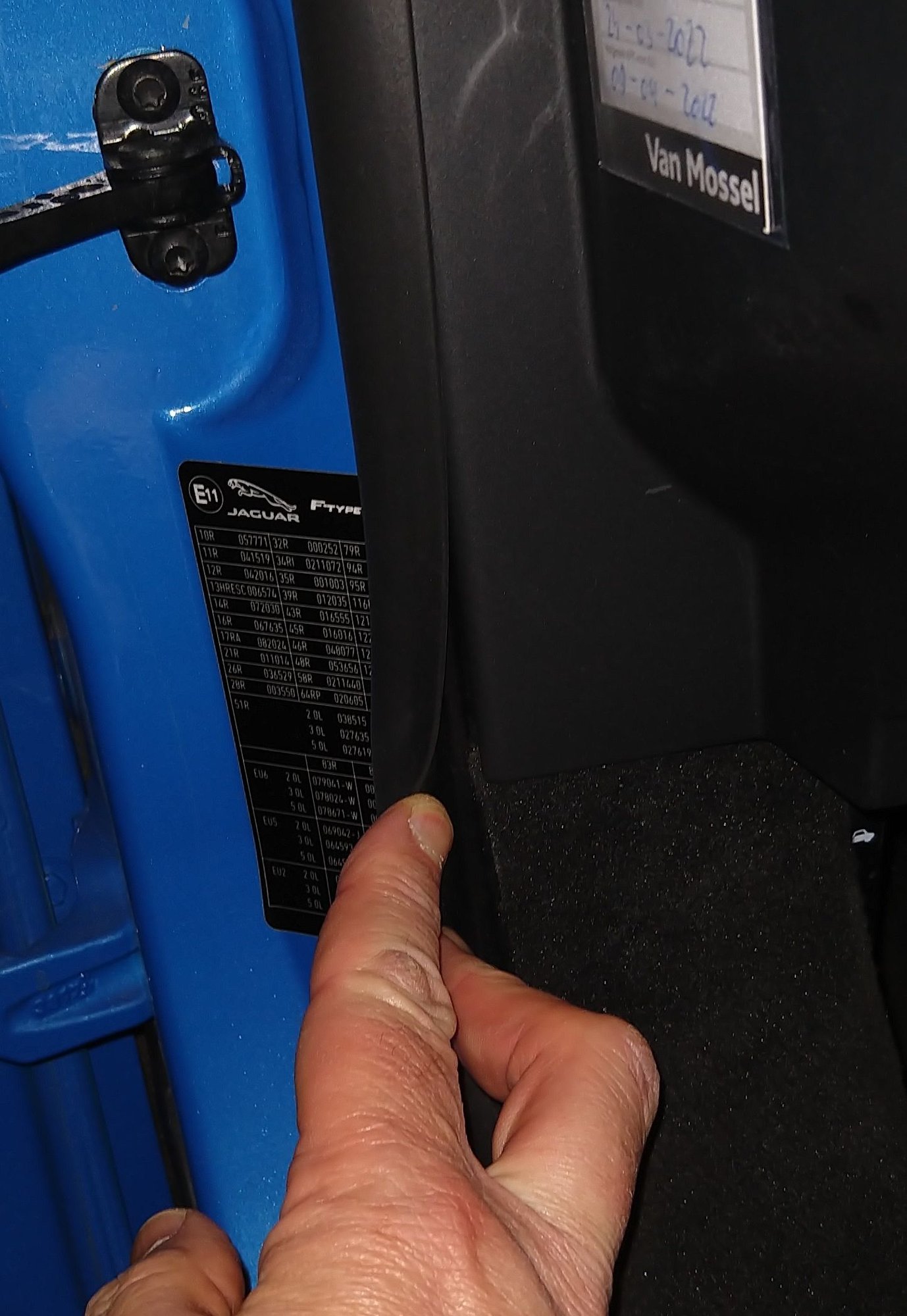

I also have the VIOFO A129 dual (non 4K version). Installing was pretty easy but I ran it on the passenger side so to hardwire it to the fuse panel under passenger floor. Camera is to the right side of the rear view mirror and I barely see it from my line of site. Definitely nice to have. I may pick up an extra mount (suction type) so I can use the front camera on my other cars if I take a long trip along with the cigarette power cord.

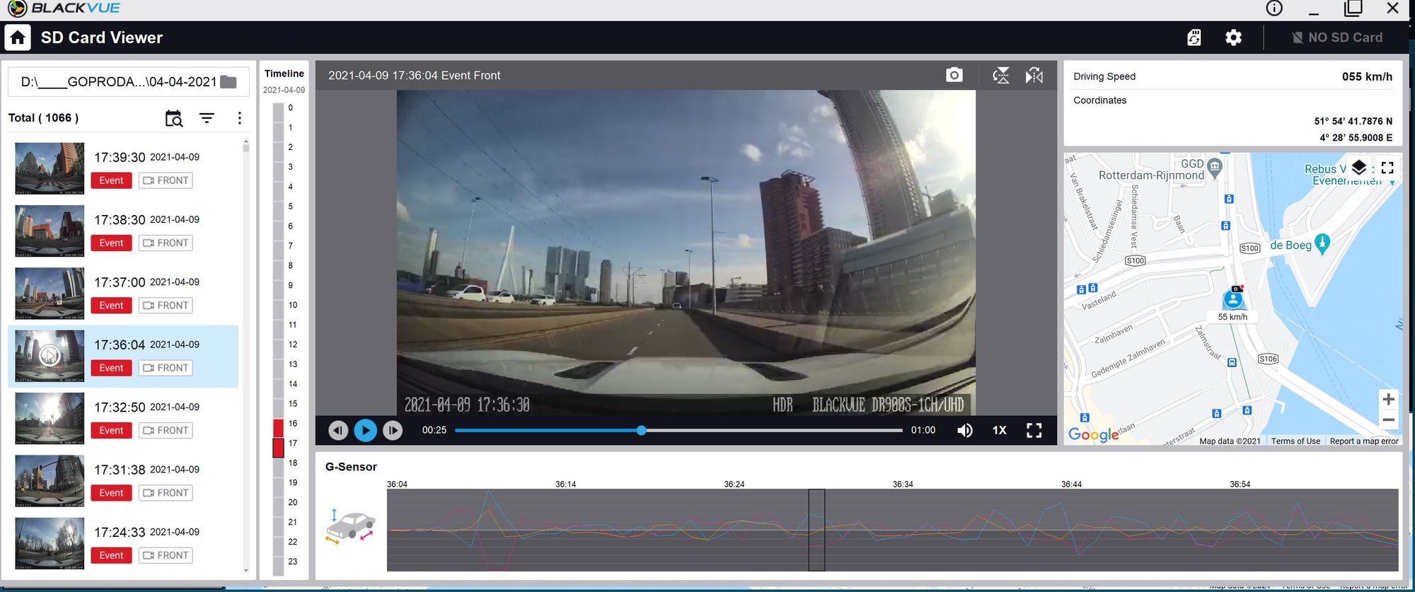

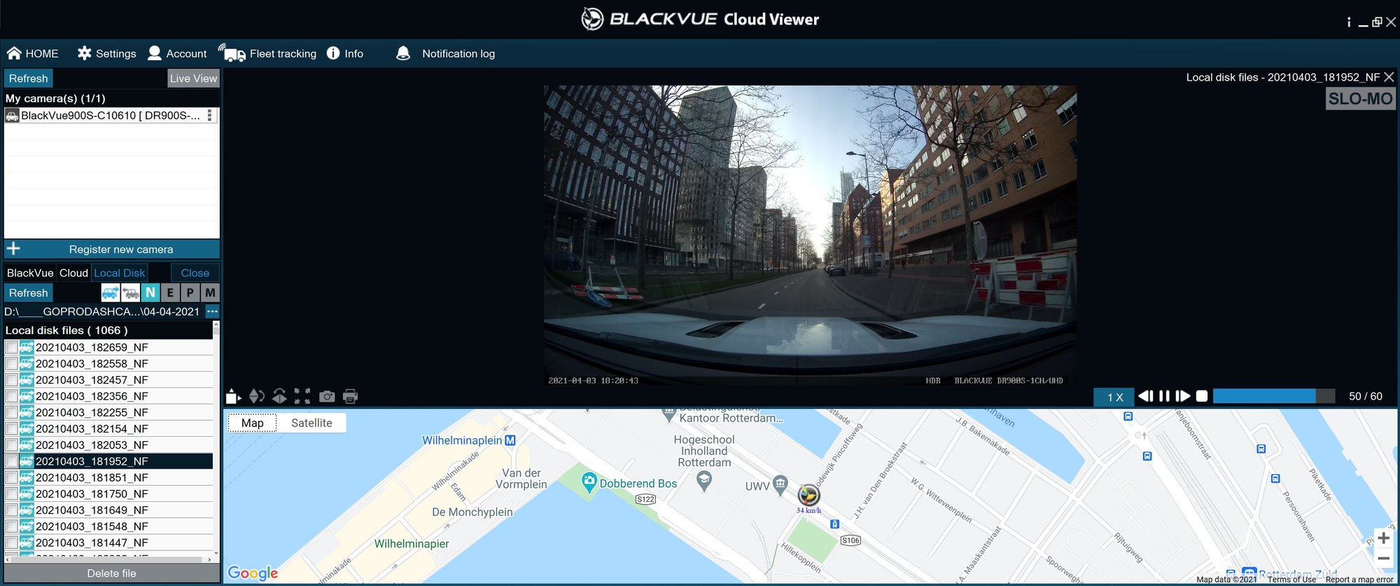

the backvue interface (i removed speed as camera can be retain for evidence but still shows speed when you load videos on software, have to find out how remove it):
