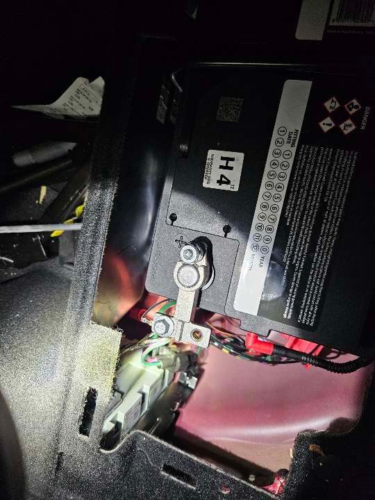

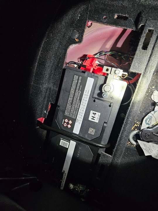

Old Sep 3, 2024 | 03:15 AM
  #39
BruceTheQuail's Avatar
Joined: Sep 2013
Posts: 4,113
Likes: 1,399
From: Gold Coast, Oz
I cant see one in here, am I missing something?
Old Sep 3, 2024 | 04:03 AM
  #40
OzXFR's Avatar
Posts: 9,030
Likes: 3,664
That's the big primary battery, the second battery if there is one is on the other side of the hatch/boot half tucked under the rear trim.
IIRC you need to pull the cubby box out to access/see it.
