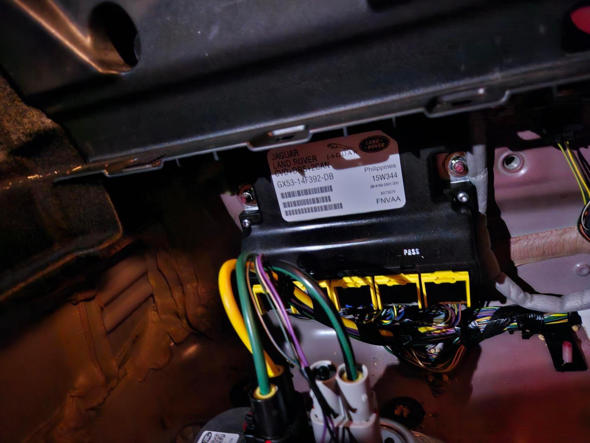

Thanks a heap for your help on this, just to conclude here is a pic aiming back toward the rear of the car, I have no idea what the black thing is.
The mechanics reckon they checked the VIN with Jag which is where they got the second battery thing from, my interest is in not wasting hours taking the car back and forth to get this sorted especially with the a/c on the fritz, I'll have the charger in a day or so anyway. Anyway I'll let you know what the upshot is when it is sorted. The car is sounding fantastic with the CAI (Mina lower section), also the muffled noise issue corrected by itself a few weeks ago (wtf?) and I am thinking it has more beans since the CAI went in, it isnt just that I am driving it harder to get the sound, so you've given me a few good tips lately, I would like to repay the favour but unless we are talking about Japan travel, parrots, or law, I'm pretty useless...
Edit - googled the part number, it is a control unit

Yep, that's the spot where the secondary battery would be if your car came with one.
