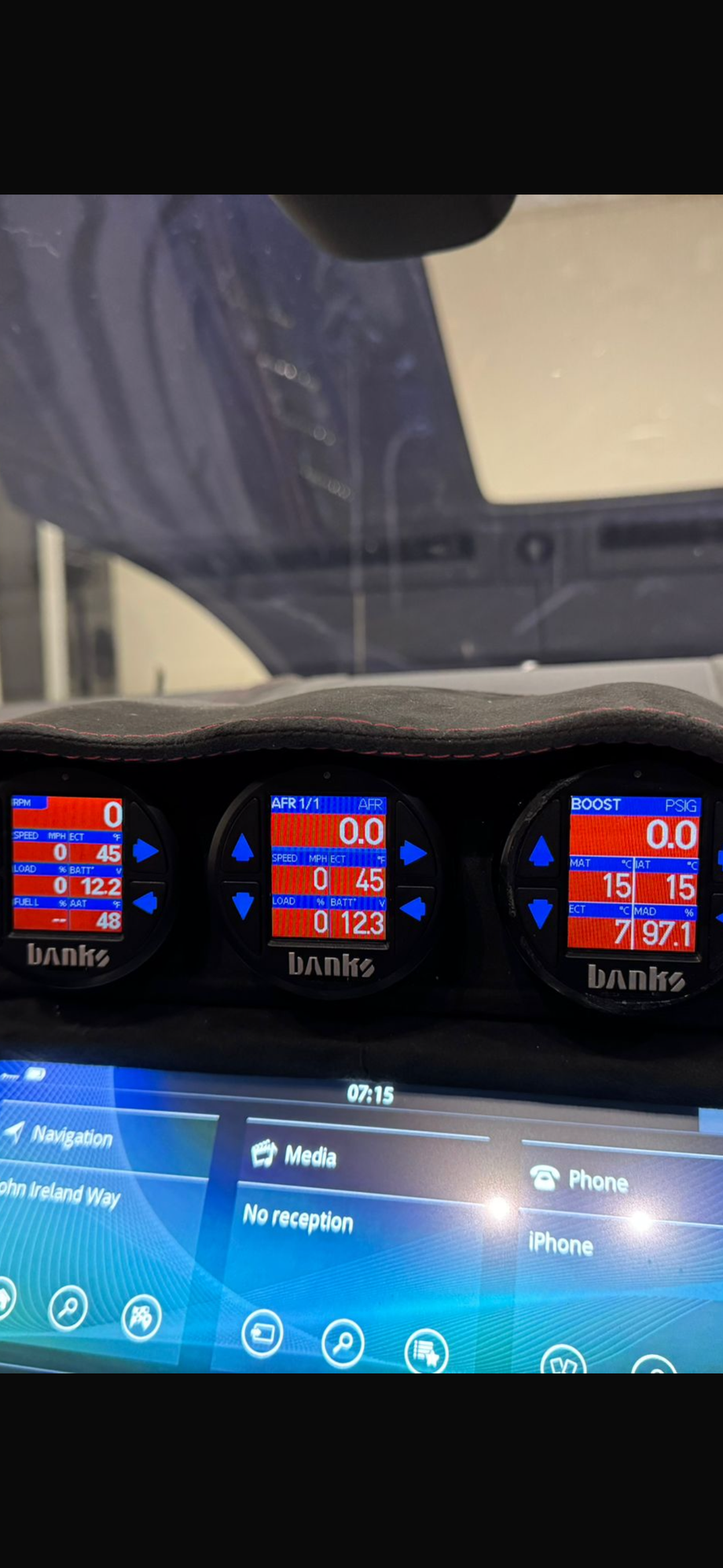

My banks obd gauge shuts down and red triangle disappears exactly as it did before

The obd port retains a perm live after shutdown so your idash is still taking a small draw
my obd port has a cable with a on/off switch feeding the banks guage which I turn off so no power sap
